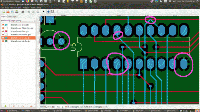

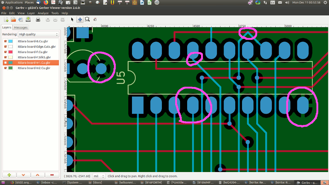

Re: Ittiara, a 65C02 handheld
Small daughter boards (like my 4Mx8 SRAM module) are one thing; but I'm particularly against using a backplane, for performance reasons. Connections become much longer, and have to go through more connectors. Do put the SPI-10 connectors on though. There are gobs of SPI ICs you can make tiny modules with. What did you have in mind? Others may want to buy it too.
I still had your gerber view up, and was about to close it but thought I should comment on a few more things:
  • Starting at the left side, the four traces coming out of that TO-92's pad will conduct so much heat that it may be kind of hard to unsolder the transistor if the need ever arises. I usually do only one, sometimes two, .008" traces connecting the pad to the plane around it. You have four of about .020".
  • For better AC behavior, run the planes between the IC leads' pads too, especially where you have a trace running through, so the traces' return current can run directly underneath it, not having to go around the end of the IC.
  • Preferably make thin traces bend only 45° at a time rather than 90°. The reason is so the board house can get the chemicals washed out of the corners better so there's no corrosion or cracking.
This might be a little picky, but these measures don't increase the cost any, and they can't hurt, only help.

Thanks for that critique. I'll see about correcting those issues you raised.

I've implemented Garth's advice at this point.
The board is 10.7x12.9cm, and I'm not sure how much I can shrink it(or that I really want to try). I ran it past OSHpark's online tool to get their price(and highlight some errors/problems), and they're far more expensive(around US$270), so I'm almost certainly going to DirtyPCBs for this.
I've attached the gerbers, as I intend to send them off, in case anyone's interested, although I'm not going to pull the trigger on this just yet, partly due to DirtyPCBs' quote tool telling me I've got invalid board settings whenever I try to add it to the cart.
