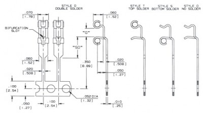

For good density on proto boards with .100" hole spacing, .025" square posts work well, and you can put a double row down each side, similar to a QUIP.
Sockets are inexpensive and readily available. Even wire-wrap sockets are available although WW is not so cheap anymore.
To make it like a normal DIP to go in a DIP socket, you can use Interplex NAS's pins. See https://interplex.com/resources/solder- ... catalogue/ . Here's an example: https://interplex.com/wp-content/upload ... P-10AA.pdf :
You solder them to your foil contact points on the edge of the board to make real IC pins. After they're on, you remove the strip at the bottom that keeps them straight and properly spaced during assembly.
Or how about making a QFP (to go in a PQFP socket) or SOJ. See for example https://interplex.com/wp-content/upload ... B-07DA.pdf (the one on the right side of the diagram):
or do a gull-wing package. See for example http://www.interplex.com/solder-leads/s ... -pins/23AA :
(Hmmm... It looks like that one is discontinued; but they have plenty of other options.)
