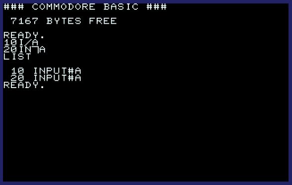

They were present in all Commodore BASIC versions and weren't necessarily two letters. All keywords in the BASIC ROM were terminated with the last character have bit 7 set. When you used keyword abbreviations the tokenizer terminated the match when it encountered the last character in your abbreviation, which also had bit 7 set. You didn't always get what you expected, however. For example, iN (shifted-N) would give you INPUT, whereas inP would give you INPUT#.
Commodore's BASIC was also unique in that it recognized GO TO as syntactically equivalent to GOTO—there is only one token for GOTO.

... For example, iN (shifted-N) would give you INPUT, whereas inP would give you INPUT# ...
@jac: I first encountered the use of the apostrophe character as a substitute for REM on the TRS-80 Model 1 Level 2, about a year before the IBM PC was introduced.
Mike B.
My memory is necessarily hazy on this. Whaddya expect out of an old man has hasn't written anything in Commodore BASIC since the latter 1980s? :D
