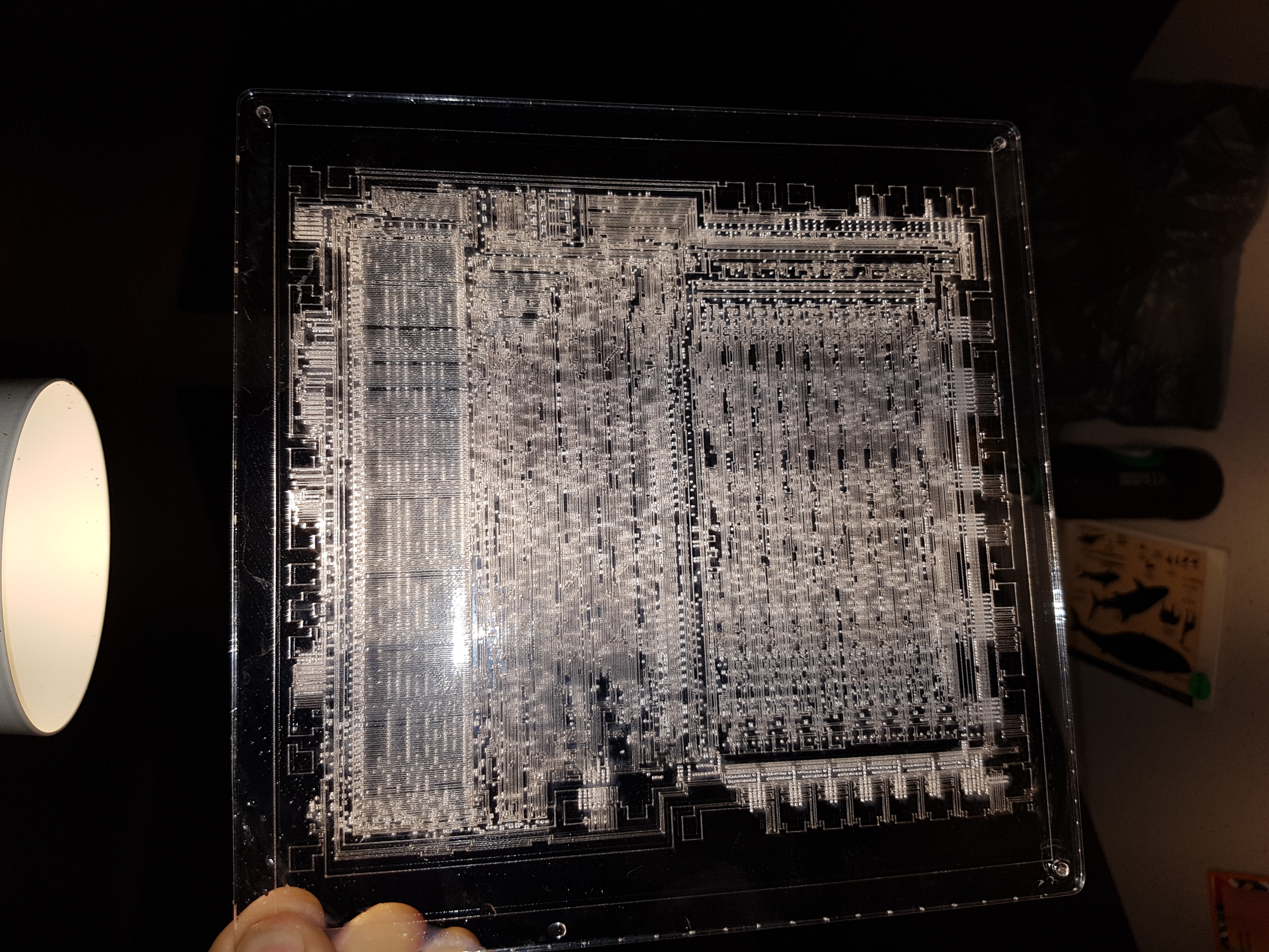

First cut of the 6502 - this is the metal layer - should not really have worried so much about the logos as they have ended up pretty small. Took about 45 mins on the laser which is not too bad.
Posts: 11464
Re: 6502 Vector image
Brilliant! I can almost see the colours but that must just be my brain filling in.

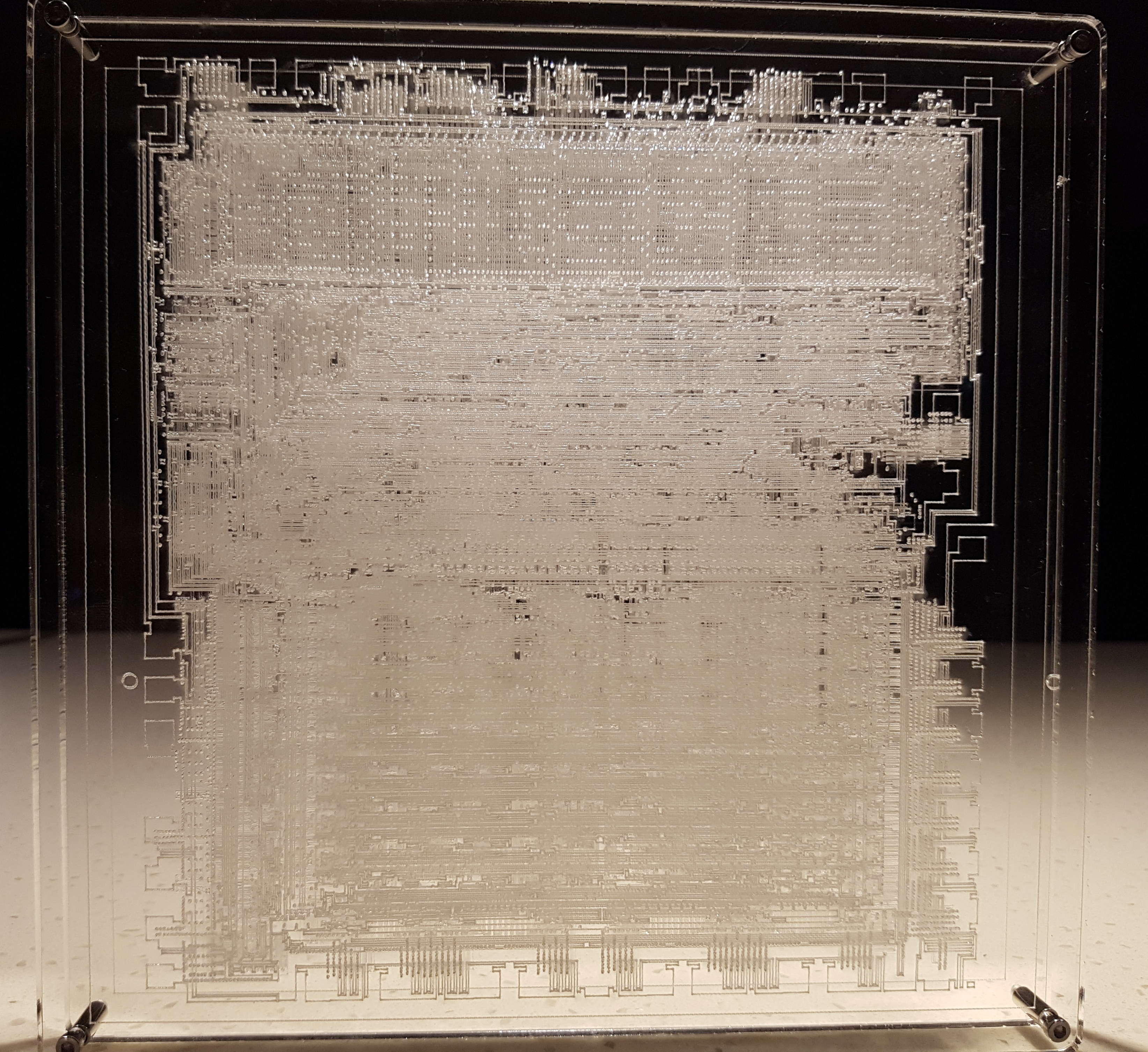

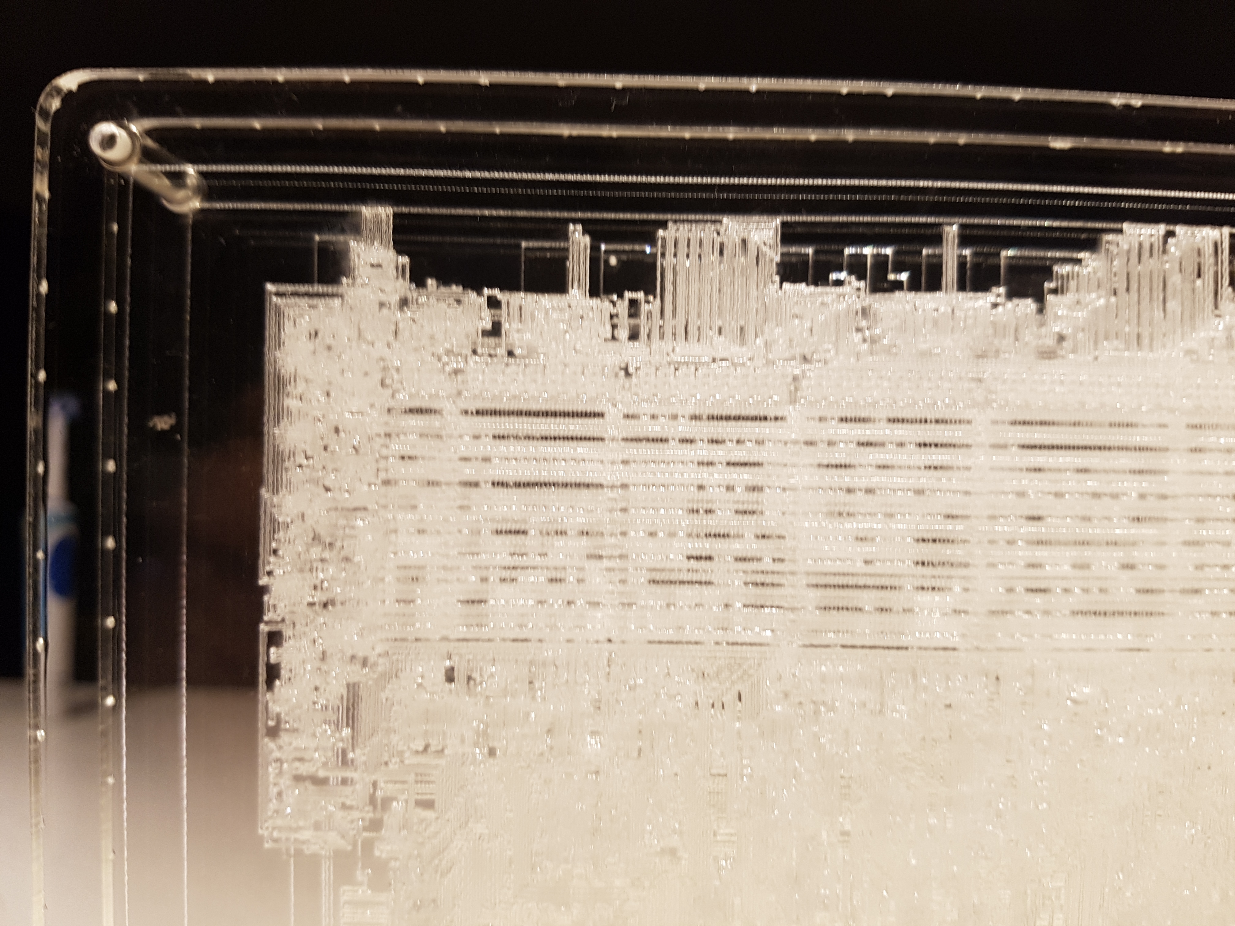

Post by chrissmith »
Have cut the last 2 layers - labelled poly and subsplits. This is still a bit prototype - had a scaling issue with the vias so they don't line up correctly.
