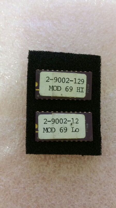

Installation Instructions
EPROMS 2516
Re: Sym-1/69
Posted: Thu Jan 05, 2017 10:38 am
by andysa
Upper Layer PCB traces with CPU removed
Lower Layer
Re: Sym-1/69
Posted: Thu Jan 05, 2017 11:18 am
by andysa
sym1_69.zip
Sym-1/69 Supermon Eproms
(3.39 KiB) Downloaded 178 times
Attached are the binary images for the two 2516 Eproms that shipped with the Sym-1/69 Mod Board.
Reading the 82S123 Prom is going to be somewhat trickier, as my Eprom programmer doesnt support it.
However, this PROM is simply generating an NMI for certain address pages, in order to support the SYM's debug function.
With the 6502 based SYM, this was done using the SYNC pin, however as already mentioned by others, the 6809 does not have such a pin.
