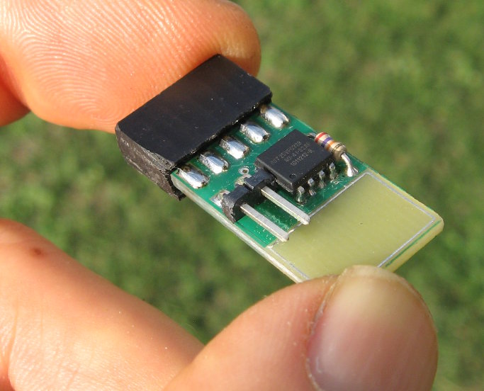

Agreed, and I just got 33 tiny boards made for the 25VF032 4MB and 25VF064 8MB flashes. (I think 26VF has the same pinout too, but I'd have to check.) I've built one up and it works, but I didn't realize the 25VFxxx 8-pin IC is a little wider than a normal SO-8, so I had to bend the pins under, taking them from inverted gull wing shape to a J-lead shape to solder them.
40% of the board is just there as a handle, and to have something to write small labels on. After testing, I put epoxy over circuit (the green part of the board), except the pins of the 90° write-protect header. The whole thing, including the black socket, takes about half the area of an SD card, but is much more hobbyist-friendly, both in the connector and in the signals.
It works fine but manually J-leading the IC adds to the labor. I'll probably re-do the board so I can add it to the modules I offer. [Edit, later: Done. See the front page of my site.] I need to come up with a name for the hobbyist-friendly SPI connector devised for many different things, with power, a config line (which has other uses too), RST\, and IRQ\. [Edit, later: It's SPI-10.] (The flash module doesn't use all of these, but some other devices will.) It's ten pins but one is cut out and the hole in the socket is plugged, so you can't plug it in backwards or offset.
Other ones coming next will probably be a tiny I²C EEPROM module [Edit, 7/28/22: the I2C-6 EEPROM module is on the front page of my site now, and there's a link to the data sheet there], a tiny I²C RTC module (these two being I2C-6 modules), a 40-pin DIP 65802 module made with a PQFP '816 and logic in SOICs, and some sort of '816 module that pre-loads RAM with a bootloader from a microcontroller, and maybe Jeff's ultrafast I/O.

Thanks Garth, nice looking mini-boards! I wish I had one of those in front of me right now.
I dug around my parts boxes, and only found small SPI flash memories and not FT232 IC.
