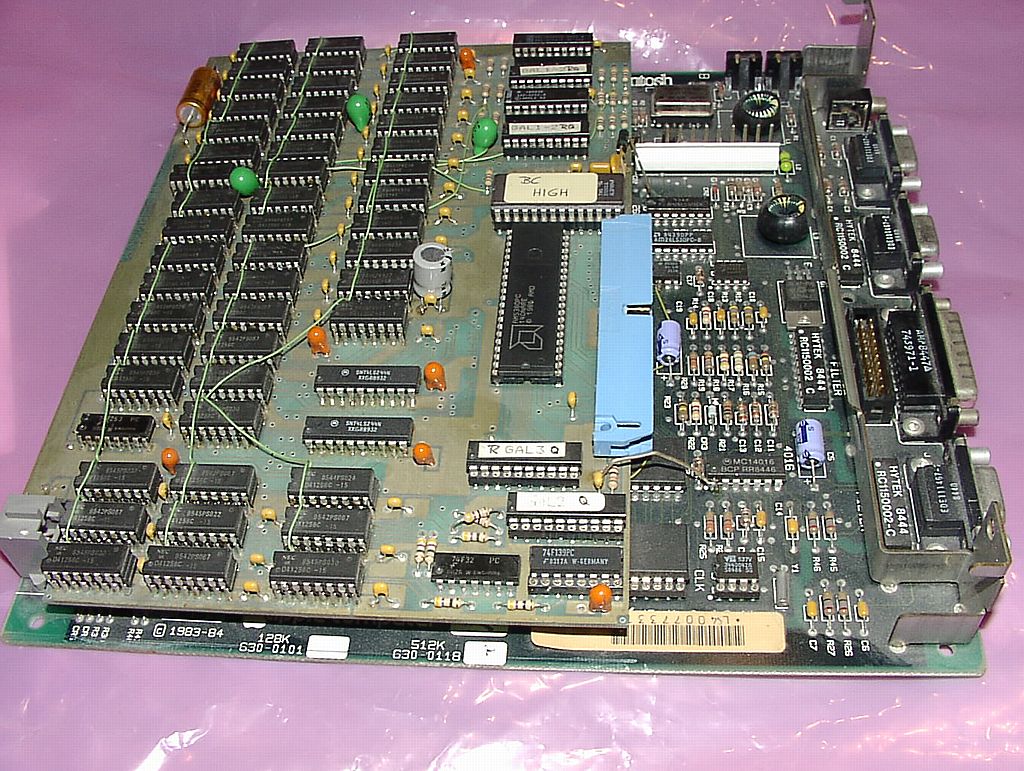

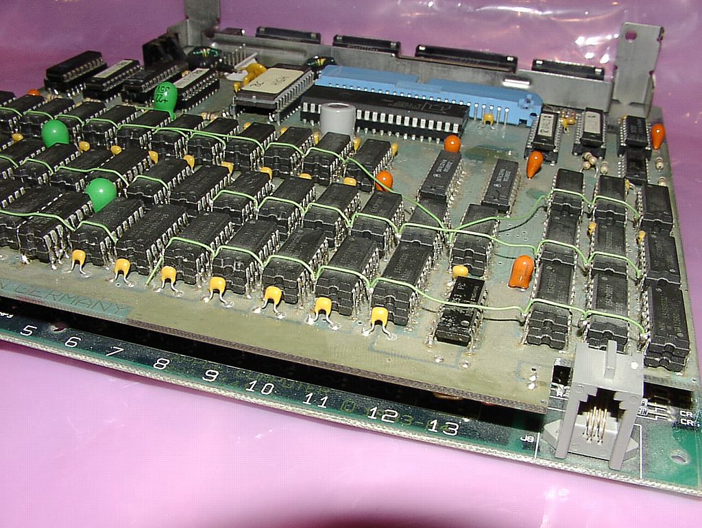

May I add a design which I developed with a friend in the late 1980s? :-)
The Macs were very expensive at this time in West-Germany. We bought some second hand Mac 512. But we wanted to have more RAM and SCSI means we really wanted to get a full equipped Mac Plus. Megabit DRAMs were very expensive at this time. So we decided to use 256kbit-DRAMs. The Mac board has installed 16 of these 41256. We added 112 to get full 4MB. But there is no space in a Mac. In theory :-)
We ordered 10 PCBs and started to populate them for our Macs and the Macs of some friends. Some Macs were equipped with 2MB, most of them with 4MB. We were lucky to get some second hand DRAMs from a scrap dealer. But the DRAM chips were soldered on PCBs formerly used in mainframes. So we desoldered some hundreds with camping gas! Succesfully :-)
If someone is interested to know the name of the layout software: this was McCAD on a Mac 512ke equipped with 1MB, SCSI and the standard display of 512*384 b/w. A three layer design :-) Two layers were good for 2MB. The third layer was necessary for stacking the DRAMs.

Wow! But I am baffled. I think I count 50 footprints there, so that would make for 100 DRAMs. Are some of these triple-stacked, or are there more chips hiding somewhere, or did I miscount?
The mainboard of the Mac512 has 16 DRAMs (= 0.5MB). My piggyback board has 48 footprints which are 1.5MB. Altogether: 2MB. Double stacked: 4MB.
We were worried about the weak power supply and modified the DRAM refresh. The DRAMs onto the mainboard are also used for video. So this refresh rate could not be changed. But the refresh of the other three banks could be reduced to 1/9. My own Mac was a bit experimental and ran (out of spec) 1/11 without issues. The refresh cycles of the additional three banks were spread. Like that scheme:
cycle #0 bank 0 and bank 1
cycle #1 bank 0
cycle #2 bank 0 and bank 2
cycle #3 bank 0
cycle #4 bank 0
cycle #5 bank 0
cycle #6 bank 0 and bank 3
cycle #7 bank 0
cycle #8 bank 0
When testing the first board we were satisfied with the power consumption at all and looking at the peaks, and we were satisfied with the heat because the early Macs had no fan.

Ah thanks I see now. 112 total and I'd counted two drivers as rams.

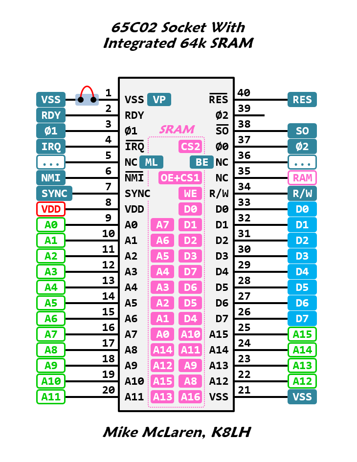

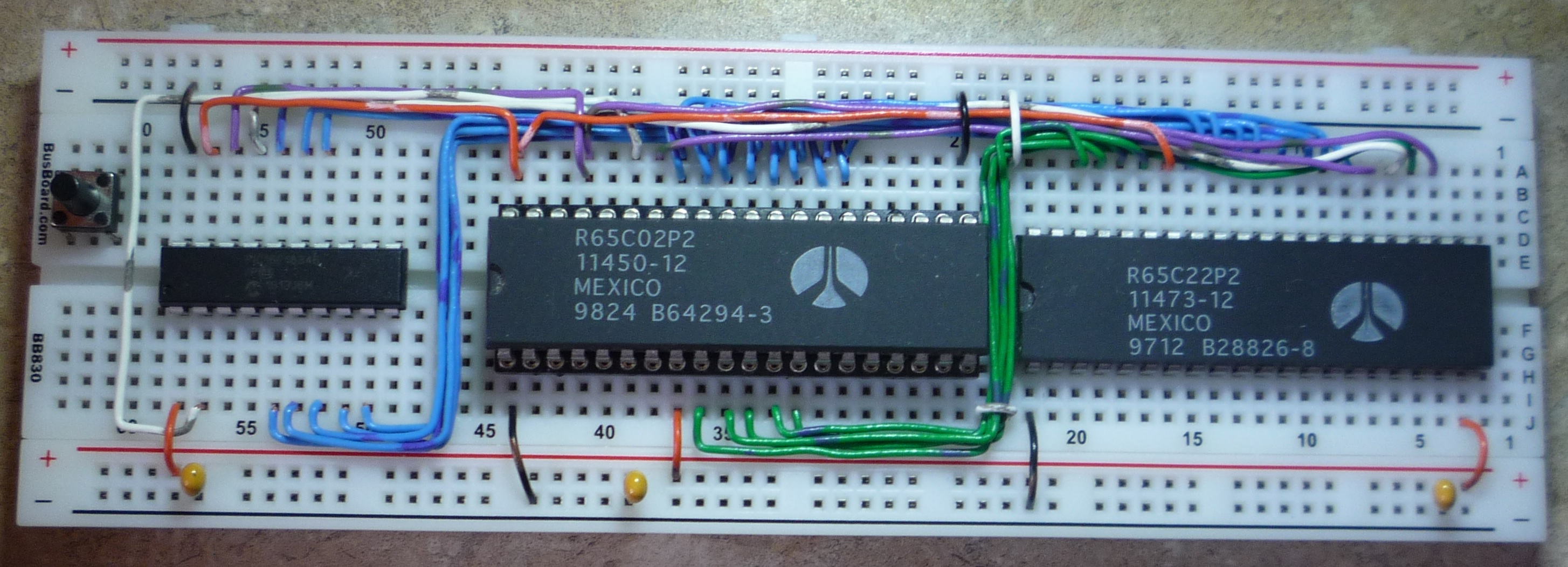

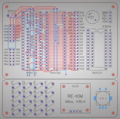

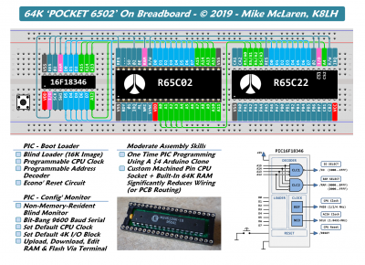

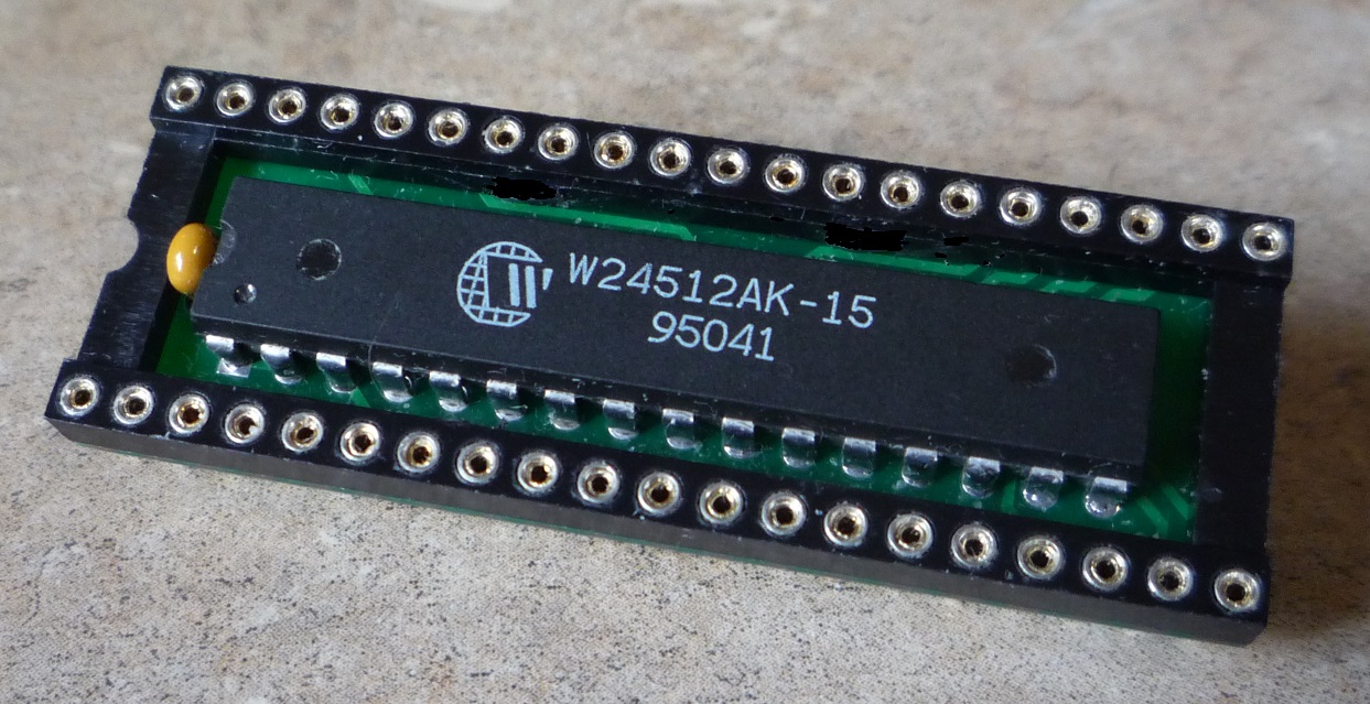

Recently I hacked together a machined pin 6502 socket with integrated 0.8mm PCB and 64K RAM chip. The RAM gets all of its signals via direct connection to the 6502, except for the active lo chip enable which is connected to pin 35 on the socket (the 6502 "N/C" pin). The socket is intended to simplify breadboard wiring or PCB routing... Examples below;

Custom socket caveats are; (A) the 64K RAM chips I'm using are 5 volt only, and (B) pin 37 on the 6502 must be used for the system PHI2 clock.
Here's a couple more drawings;

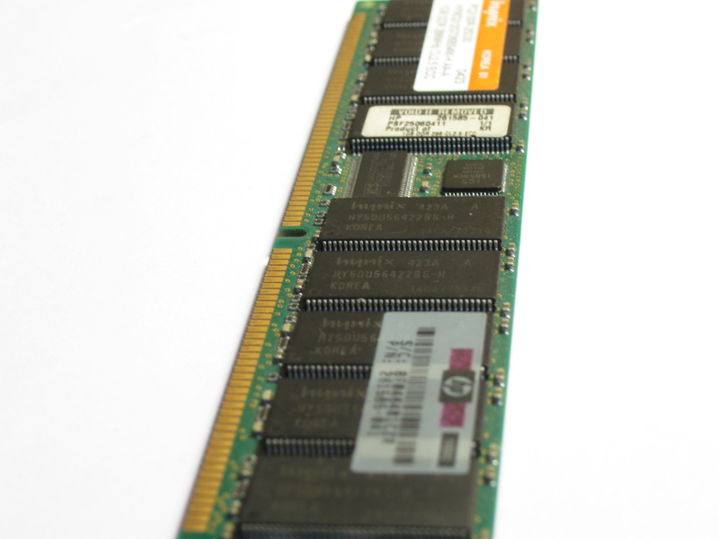

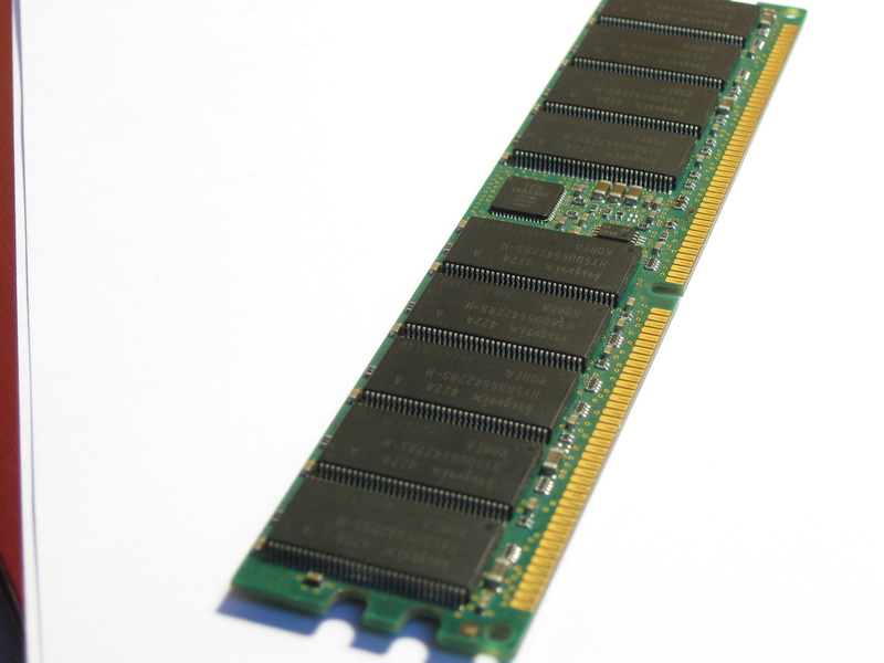

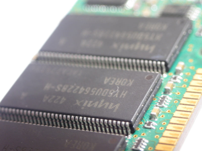

Just a normal DIMM, 1GB DDR333 ECC REG
But wait!
Probably designed to be mounted this way, all pins are connected between two chips, nothing is routed around. 36 memory chips, 40 chips total
There were some 2GB DDR modules (also server ones) with additional PCB laminate layer so that some pins from the top layer were routed around. Things moved to BGA later, and started looking boring :)

I can only imagine there was an internal fuse to blow inside these chips to determine which select lines or addresses it would respond to.
Re: OT: stacked (DIP) chips
Could be that they had two bondouts, and two SKUs, and paired them up accordingly. (The unbonded pad would need an internal pullup or similar, but that's not much trouble.)
Posts: 3525
Those are both plausible theories. But maybe the upper chips (and their plastic packages) have simply been spun 180 degrees, and the pinout is such that the spin results in no effective change for most of the pins. But there's a Chip Select pin that ends up in parallel with a no-connect, and a no-connect that ends up in parallel with a Chip Select. :) (Or perhaps an active-high CS that ends up in parallel with an active-low CS.)
Ha ha - very inventive!
It looks that these are 256Mb 4b-wide chips (4 banks of 16Mbit x4 bits), so they probably routed data pins to some of NC pins of the other one, effectively getting 4 banks of 16Mbits x8 bits. Slightly less magical now. 8)
