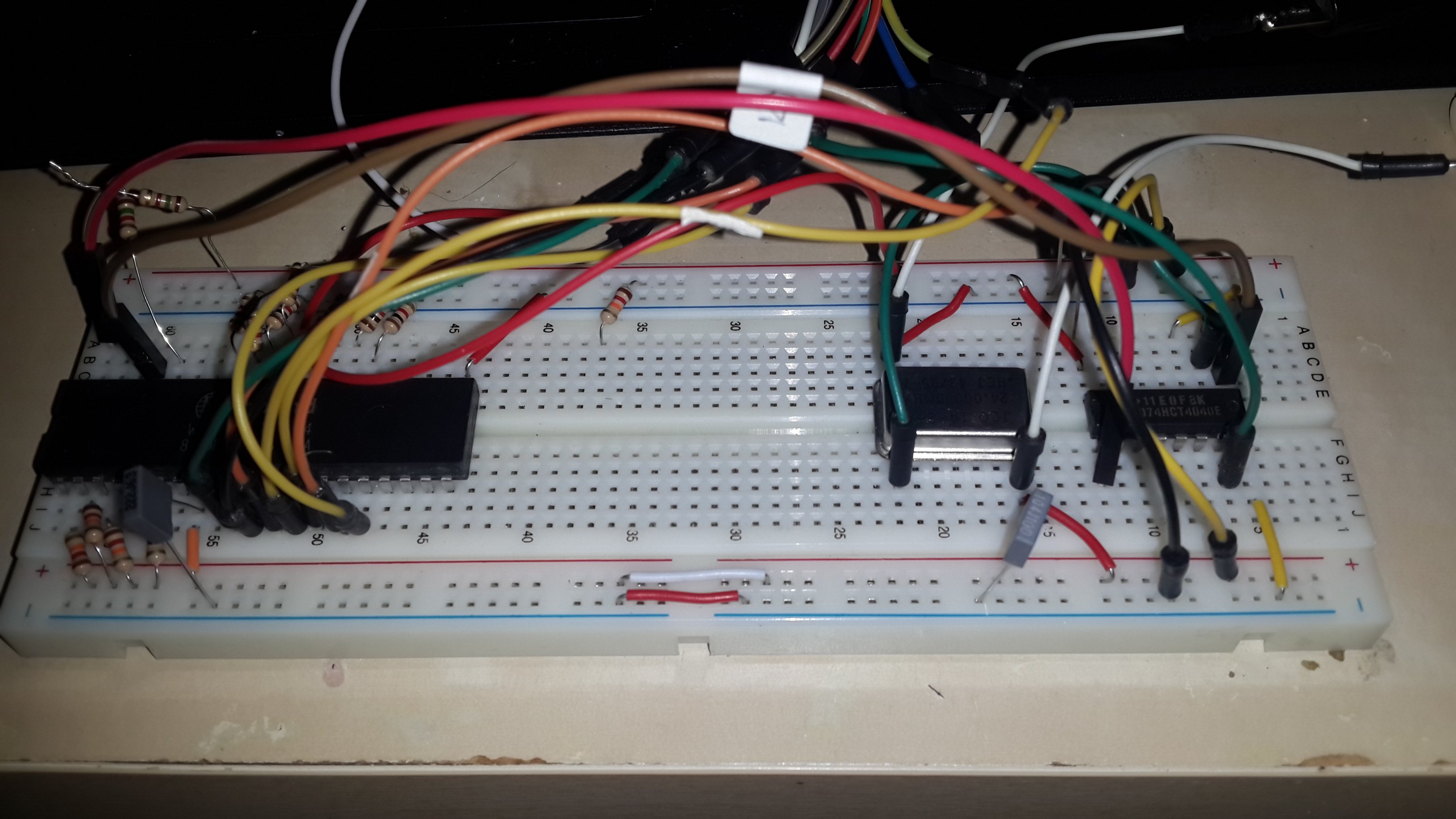

Not sure what to say about your 12 MHz test. There are several things that could cause a failure at high frequency. Can you post a photo of the test rig, especially showing the bypass caps and the counter etc used to generate the clock? What type of IC are you using for the counter?
A quick hack on the breadboard. I use a 74HC4040 12 bit counter IC. 220nf caps are there for all the supply pins to the parts. Logic analyzer's cables disrupt the view. I removed the reset part and feeded counter's most significant output to the reset pin so cpu would reset every 2^11 cycles.
High res image : http://www.tepetaklak.com/data/20160122_225553.jpg

I used counter's Q1 output to get a 6Mhz signal to feed to logic analyzer since chip has failed with both $A9 and $EA opcode.

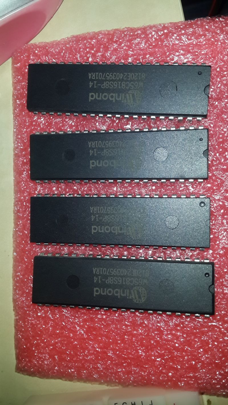

Here is a photo of the chips.. When I closely examined them on the photo I decided that they are indeed counterfeit products. Small cavities (dots) under the chip's notches are non standard among the chips. They are all different sizes.
High res image : http://www.tepetaklak.com/data/20160122_225617.jpg

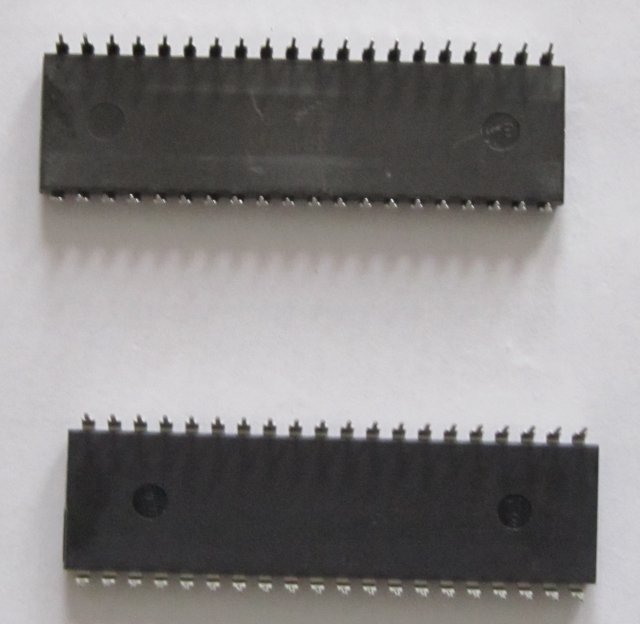

Could they be older 8mhz pulled parts that have been "tidied up".
The top chip is a 20 year old pulled W65C816SP-8, it's not too clear in the photo, but the word TAIWAN and what looks like a batch code (93161X) are engraved into the bottom of the chip roughly in the middle between the 2 grey lines. One of the dots is blank, the other has B4 moulded in it
The newer chip pictured at the bottom is a much more recent W65C816S6PG-14, and in this case TAIWAN is moulded into one of the dots and 6J4 in the other
top chip  date code 9540, lower chip 1023

@Martin A : Mine look a lot similar to the below picture.
One of them has Taiwan G2, and an empty dot.
One of them has Taiwan D3, and an empty dot.
Two of them have PHILIPPINES and BR
One has TAIWAN (very hard to read) and A2
All of them have non uniform bottom paint giving the impression that they got some processing. (sanding and or painting)
By the way, where can I get information about these 8mhz parts?
I'm disappointed that these chips are not what they appear to be. But at least you got something functional (apparently, so far). Of course the red flags are up. No quality control assurance on these babies!
Nice trick with the Reset! But, from what I can see, connections to the bypass caps have a lot of room for improvement. Admittedly it's a contradiction that you would be using a breadboard to create a circuit whose maximum clock speed you wish to determine. But if you MUST go that route then I suggest the bypass cap for the CPU be attached to the chip itself -- soldered on top, straddling the 40-pin package.
