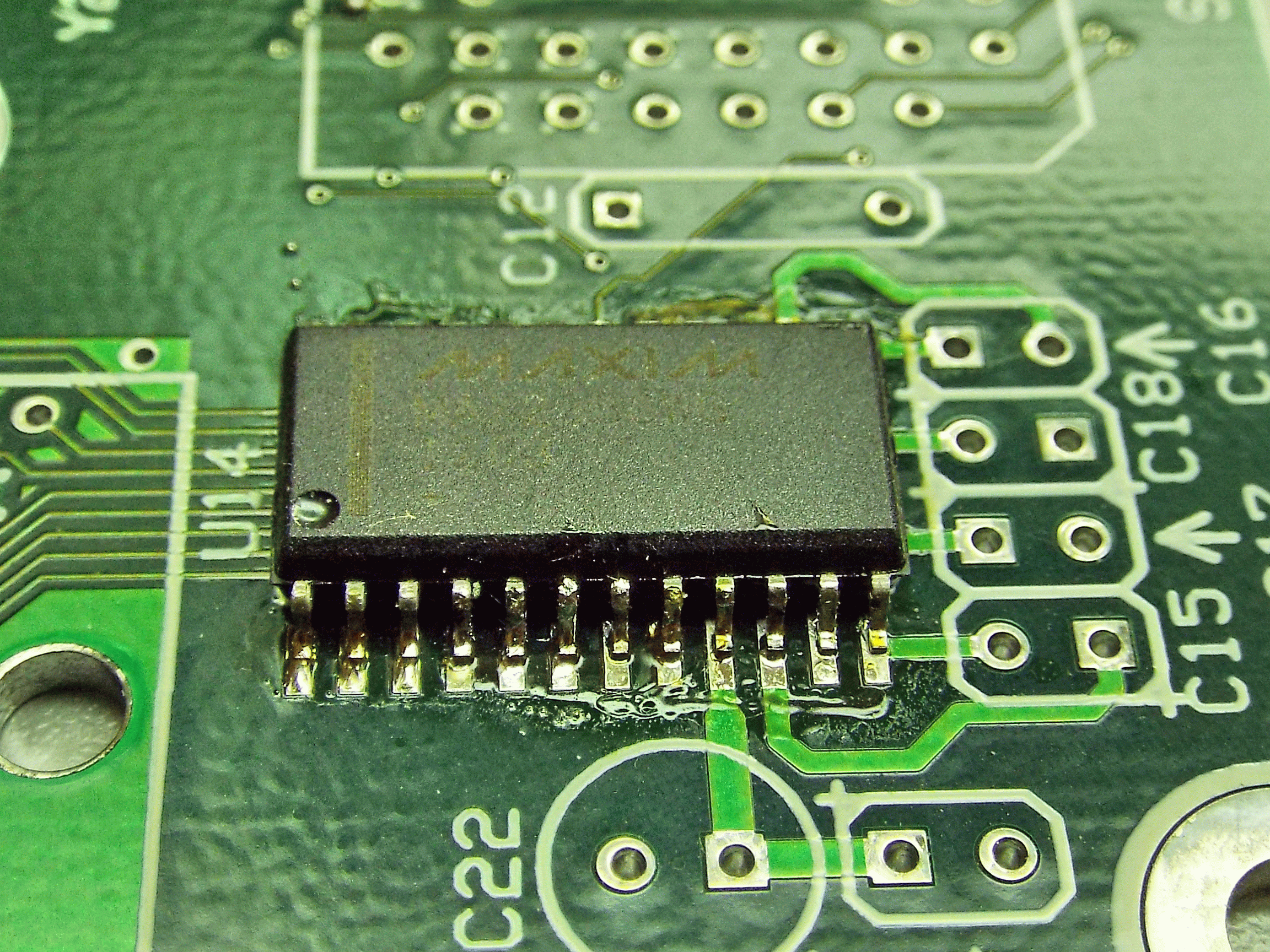

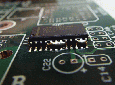

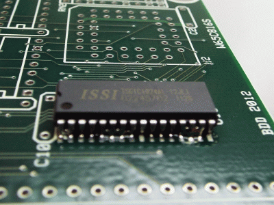

Once my parts had cooled down from reflowing, it was clear that I had a bit of a mess on my hands. As I had noted a few posts ago, it appeared that I had applied too much solder paste and not surprisingly, some of the connections looked more like boogers than solder joints. :(
SRAM after Reflow
SRAM after Reflow
MAX-238 after Reflow
Above is the SRAM (SOJ32) and MAX-238 (SOIC-24) after reflow. As can be seen, the reflow process did produce some good joints, but also some bridges. As I watched the reflow flow while the board was in the oven I could see that the excess solder paste was developing bridges, but of course, it was too late at that time to do anything about it.
In the past when I have manually soldered these small packages I have been able to successfully use desoldering braid to get rid of bridges. However, the bridges that did occur during manual soldering were not nearly as bad as these bridges. Nevertheless, I figured there was no harm in trying.

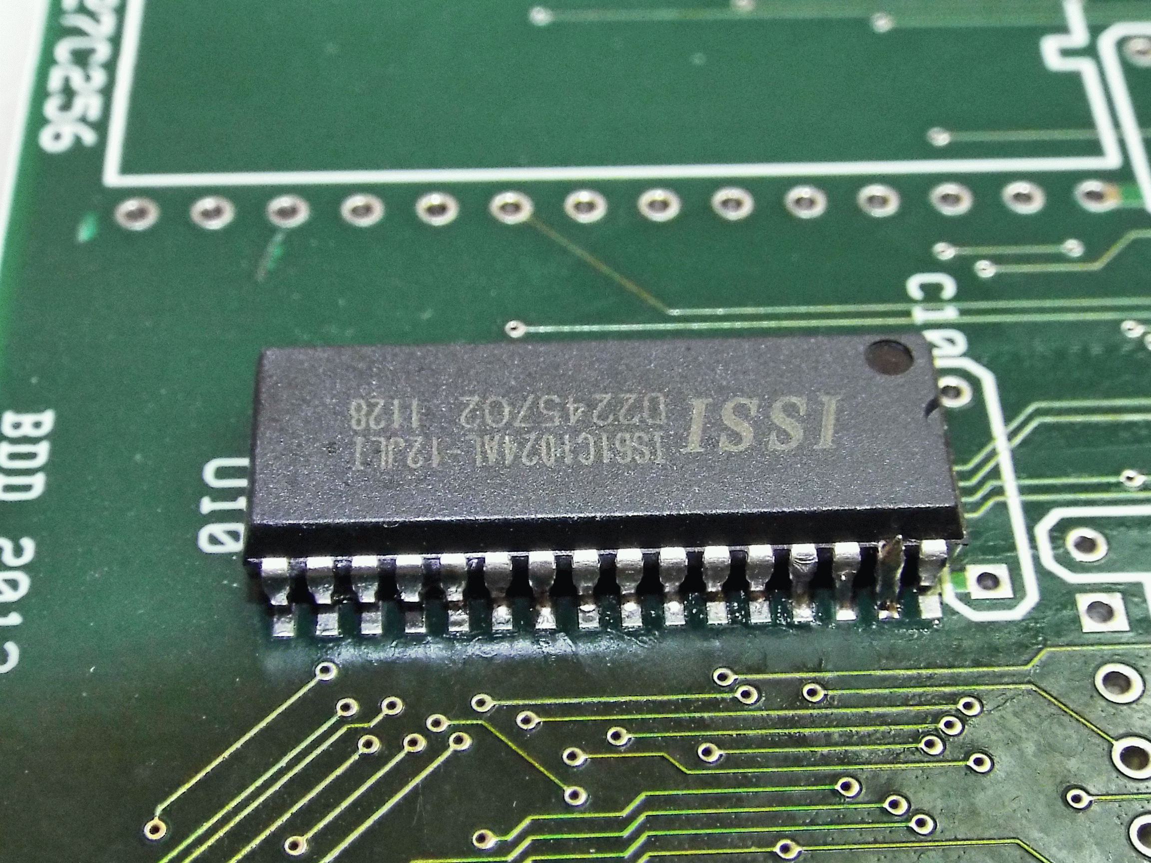

SRAM after Cleanup
SRAM after Cleanup
MAX-238 after Cleanup
Above are the SRAM and MAX-238 after judicious use of desoldering braid. All outward appearances suggest that everything is copacetic, but the DVM tells a different story. The MAX-238 checks out okay but the SRAM has multiple inter-pin shorts. Careful inspection under magnification revealed some tiny bridges under the device—out of reach of the desoldering braid.
The only way to fix under-device bridges to desolder the SRAM, clean up the board and re-reflow it. However, the goal of this project is to be able to successfully reflow without subsequent rework. Ergo I'm not going to try to fix this mess and instead, will reevaluate my methods to assure that the process will produce a working part on the first try. I've got one blank POC V1.1 board left, so I can take another stab at this.
Fundamentally, my reflow procedure appears to be sound. Where the train went off the track was in the application of solder paste. It is clear that I need to be more sparing with the paste and more accurate in its placement. Also, despite having early said that I didn't think that it's necessary with 50 mil pitch parts, I have decided to use a stencil to assist in applying paste on the next go-around. I'll write about it once my vision is clearer and I can do the close up work that will be required.

One way to fix under-device bridges is to add some more solder (and optionally some flux), so that the molten blob can reach under the device and remove the small bridges. Then use a solder pump to remove the blob (I use an Edsyn Soldapullt, and it does a good job).
Also, when you use braid to remove bridges, I recommend putting some solder on the braid first, so it doesn't suck the pins completely dry.

The last ISSI SRAM picture above appears to have open circuits too; but it may just be the camera angle. When I build the SRAM modules, I just make a big bridge all the way down the side of the SRAM, then hold it vertically, and very slowly drag the large soldering iron tip down the side, from top to bottom, and all the excess solder comes off on the iron, leaving the right amount on every pin, and no bridges. The tip covers three pins at once. I know you're ultimately looking to get the right amount of solder paste on there so no rework is necessary though.
It's the camera angle. All pins have continuity to the PCB.

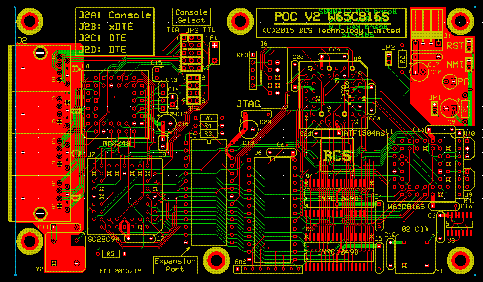

Correct. POC V2's PCB layout creates a number of areas where manually soldering the SRAMs might be tricky.

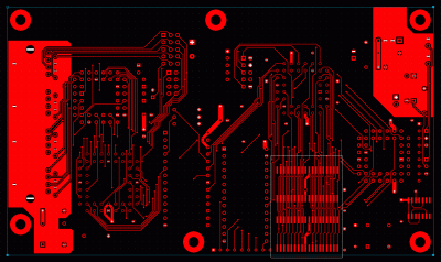

POC V2 PCB Top Copper
The area demarcated by the white rectangle meets the design rules but results in only a small amount of solder mask between the adjacent pads for the SRAMs, due to the traces passing through that space. I suspect it would take very little to provoke a bridge between one of those traces and a pad, since the solder mask could be accidentally abraded by the solder iron tip.

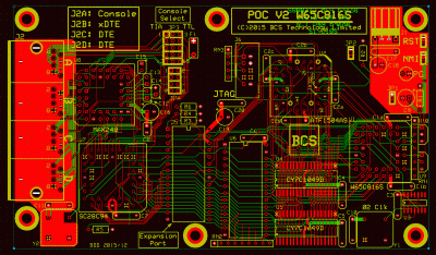

BTW, here is the PCB layout en toto.
POC V2 PCB Composite Layout
Some time ago while cleaning up the layout, I realized that with some judicious rearrangement, I could attach two SRAMS instead of one. POC V2 will have 1 MB of RAM instead of the 512KB I originally planned to use. I also added the JTAG port, even though I can program the CPLD in my Atmel test rig.
Fortunately, I've found that modern soldermask is extremely tough, at least for the production PCB houses. I haven't tried the super-low-price hobbyist PCB suppliers, but I suspect it's the same story.

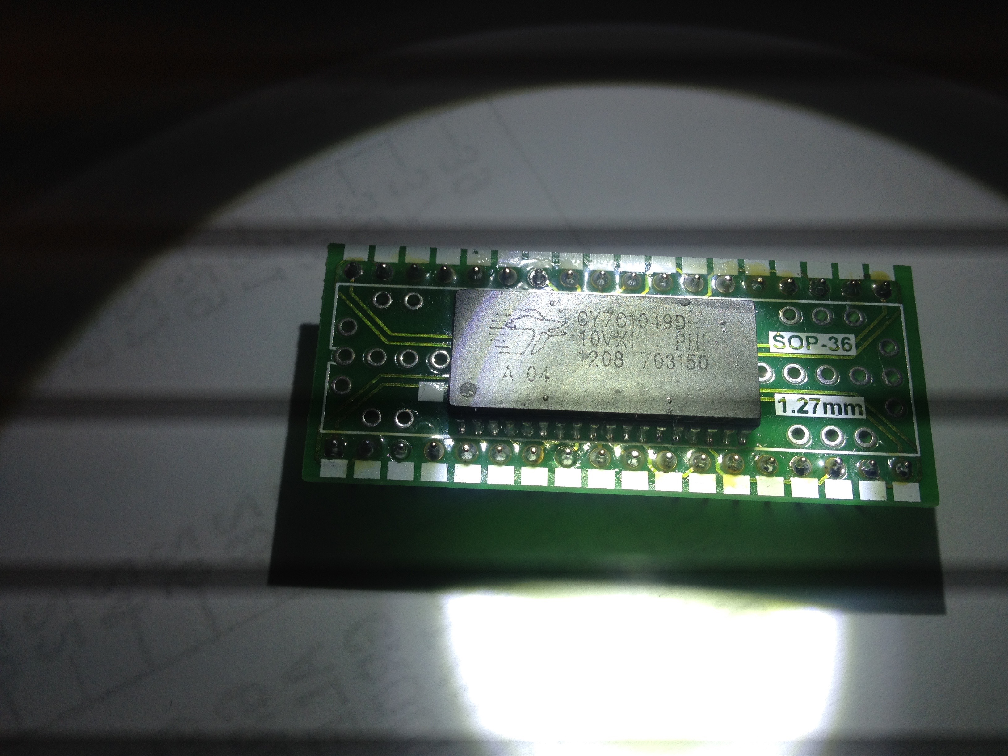

I think you put too much solder paste and that causes a lot of bridges. I really would consider to use a stencil (metal if possible). Especially with fine pitch TQFP (0.5mm) with only a little too much solder you automatically create bridges. I really look forward to see more results, because I also plan to jump on to the SMD track and I'm also considering to use a reflow oven (perhaps I use a real one as the small ones are really cheap). For the moment I mainly use adapters to be able to use fine pitch devices in my breadboard test setups. All hand soldered for the moment, which may take something like 20 minutes for a TQFP-100 including clean-up and tests.
TQFP-100 ATF1508AS on Test Adapter
But the key was to use a lot of solder flux and only very very little solder. Especially on J-leads
High-Speed 512kbyte SRAM on Test Adapter
However solder flux is no option for a reflow oven and so the only solution in my opinion is to apply the correct amount of solder from the very beginning using a stencil. One down-side when applying solder with a stencil is that you must be very careful when placing chips with a lot of pins as they must not be bent in any way else the pins that are bent upwards will not solder.

...l hand soldered for the moment, which may take something like 20 minutes for a TQFP-100 including clean-up and tests.
I've done similar hand solder adapter attachments (TQFP 144). I ruined one part, but the second one was good. Lots and lots of flux, hardly any solder. Basically just tin the tip. The other thing you need is some very fine tweezers. The hard thing is lining the part up. I can see from your photo that the pins are off by maybe 20% of a pin pitch. Luckily you'll get away with that. :)
