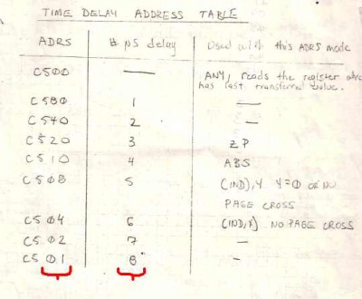

nyef wrote:
I'm also reminded of reading about the software interface of an early version of the macintosh
Wow! -- very entertaining. Those guys are definitely using a shift-register time bomb! :twisted: In this excerpt from Burrells' chart, I've marked (in red) how the lower address bus is used as a bit-map that specifies time delay.
