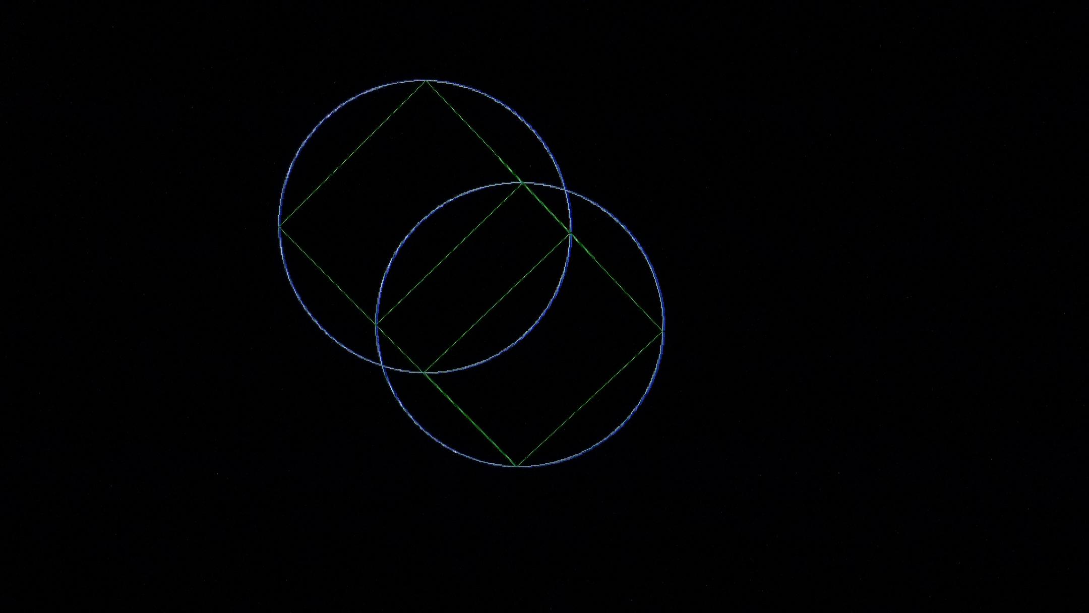

The software has really changed alot. I have a few macros now.
side_map1: side of a square from LUT1.
square_map1:use side_map1 to draw 4 lines using the LUT1 circle coordinates.
side_map2: side of a square from LUT2.
square_map2:use side_map2 to draw 4 lines using the LUT2 circle coordinates.
cube_map12: use square_map1 & square_map2 to draw 2 squares and 4 interconnecting lines.
VIDEO
This pic below is before rotation:

I had an issue to resolve before full rotation in the video above. In that video, it is only 1/4 rotation. It is based on the value 'OFFSET' from 0-255. Higher values resulted in (0,0) coordinates because it was going out of range in the LUT, which is only an 10-bit, 1024 range. SO I modified it...
I made a modification to the above macro's, it's is almost 100% I had to mask off unneeded bits for the LUTs, also I added more to the delay for the video($FFFF instead of $03FF)... I just posted a new video, slowed down.
This is the main control loop now (not previously posted), :
ANOTHER VIDEO Still an error. Gotta figure it out, then on to 2 planes. EDIT:BAH! The first AND mask in the square_map1 macro is wrong, 1 too many 1's . The replace function must have skipped over the very first one when I was editing.

This video shows correct motion. I changed the delay value to speed it up also. Now on to the Z plane!
