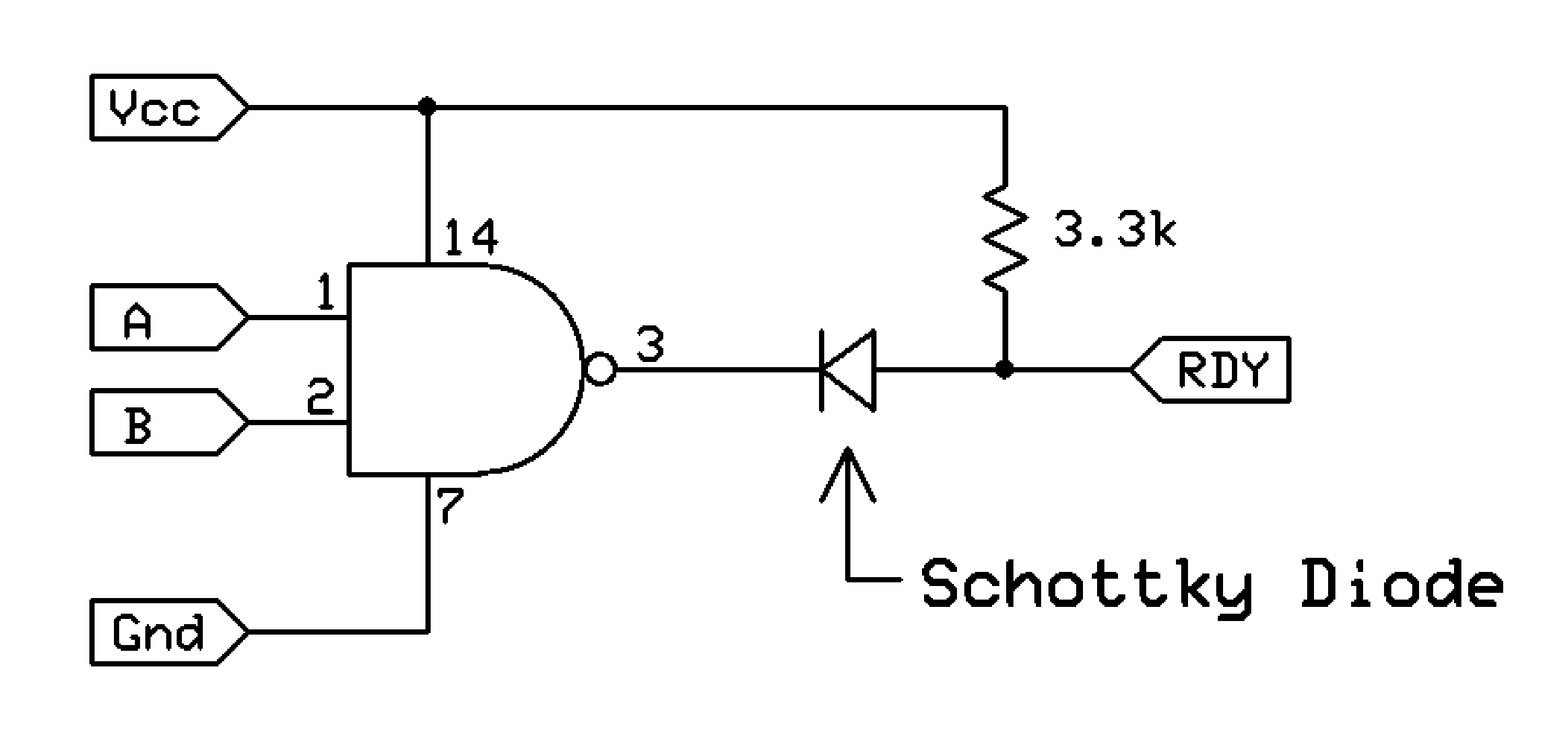

I noticed RDY is a bidirectional signal... is there a canonical way to make sure that a device and the CPU won't try to control the RDY line simultaneously?
The MPU will only pull RDY low if a WAI instruction is executed. So all you gotta do is connect RDY to the other device's output through a Schottky diode, with the anode connected to RDY. Be sure there is a pullup on RDY. 3.3K is a good value.

But then does that arrangement allow external devices to control RDY? Is it that when the cathode of the diode is at low voltage, most voltage will be lost through the pullup, and when the cathode of the diode is at high voltage, little current flows from anode to cathode and the resistor pulls up the voltage at RDY to logic high?
This must be one of those setups where all I/O and peripherals connect to the RDY pin using pull-up resistors and any one of them can pull the line low- just like the IRQ pin.

They can pull it down if they're not ready to move on, as in the case of slow memory that still needs more time to get the data.
A Shottky diode's forward voltage drop is only around a quarter of a volt; so if the cathode is pulled nearly to ground, the anode will still be in solid "0" territory. The pull-up resistor will have about 4.4 volts on it (5V minus .25 minus I'm going with .15V at the cathode for a CMOS output that's driving 1.3mA), which will drive about 1.3mA through a 3.3K. When the cathode of the diode is higher than the anode, no current will flow through it, so the processor is not pulling RDY down against something that's trying to pull it up at the same time; ie, there's no contention. The diode will isolate them when it's biased in that direction.

Driving RDY From Other Logic
Unless both inputs on the NAND gate are high, the output of the gate will be high and RDY will not be affected in any way. If the MPU executes WAI during this time, the diode will be reverse biased and RDY will go low. If both NAND inputs go high, the gate's output will go low and pull RDY low, regardless of what the MPU is doing. That's all there is to it.
As Garth noted above, the worst-case current flow will be about 1.4 MA through the 3.3K resistor, so size the diode accordingly.

Would it not be appropriate to use a logic gate with an open-collector output?
Sure, if one is available for the application. It would be easy in a PLD to tri-state the output when not wait-stating.
However, if the wait-state circuit is being implemented in discrete logic, it may be that RDY will be driven from the Q output of a flip-flop. So the diode would become de rigueur.
