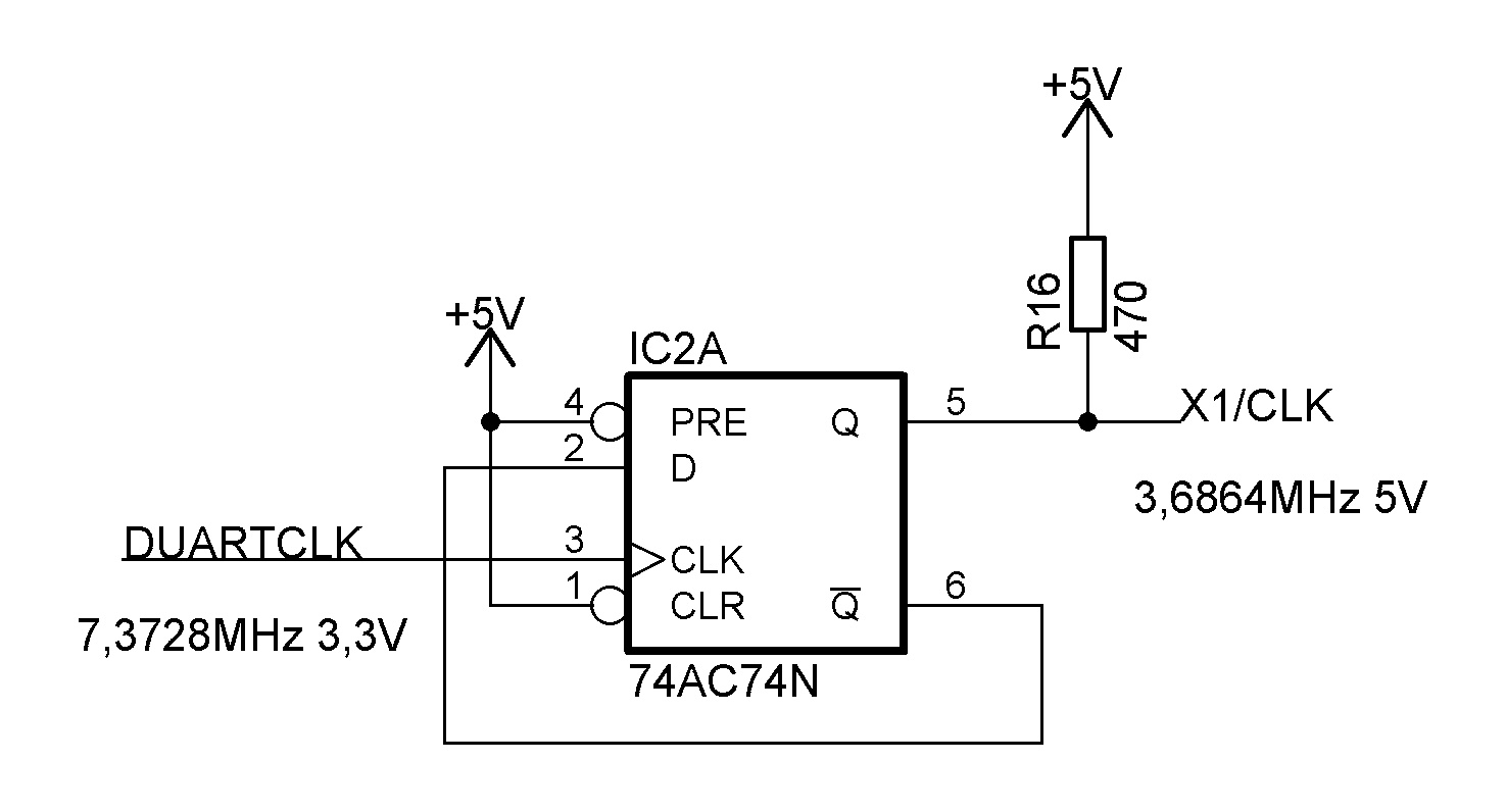

I’ve come up with a solution to ease myself with leaving two options open to use on the circuit board. Given all the information I find the flip-flop the most appealing.
As a backup option, I’ll leave room for a crystal and two capacitors.
I also looked at the datasheet of the can oscillators I have (1,8432 and 7,3728 :) ), and indeed they are improved since the 75mA. They need 20mA to 35mA depending on the frequency.
The odd thing is that my “local” supplier has can oscillators with a lot of different frequencies, except for the 3,6864MHz.

I suppose the Flip-Flop uses a VCC=5V, so I think you better use a 74ACT74 so the 3.3V Logic Levels will be clearly recognized as high level. The AC only version are a bit tight, they need 3.15V at VCC=4.5 and for higher VCC it will be clearly more than 3.3V. The ACT version will recognize 2.0V as High Level regardless of Supply (4.5 to 5.5V). You also don't need R16.
+1. CMOS already pulls up pretty much all the way to its positive power supply rail. 74ACT is also quite a bit stronger than 74HCT. The resistor is only recommended if you have to use something like 74xx TTL or 74LS.
Thanks, your right. I have the 74HCT74 here at home. If it won’t suffice, I have to search for a place where to buy a few ACT’s as a private person. I normally order from http://www.rechelt.de. They don’t have a lot of special or rare parts, but for the most parts they’re quite fast and not too expensive.
OK, I wasn’t sure about R16, it was mentioned in the datasheet, so I added it for the case it would be needed.

It appears that Reichelt doesn't stock anything in 74ABT or 74ACT. As it is expected to only drive the xCLK input of the 26C92, I don't think you need to get too excited about how hard the 74HCT74 drives its output.
