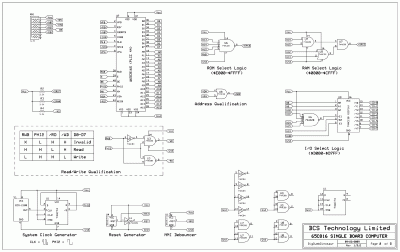

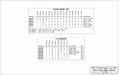

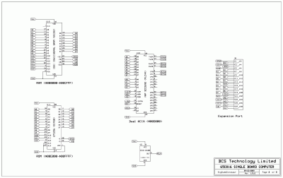

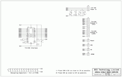

Edit1: found BDD's POC schematics. Nice!
Excellent. My website is due for more updating but time has not allowed me to do a long burn on it. The schematics you found, however, contain the hardware bug-fixes that corrected timing issues that popped up in the initial unit (V1.0).
Edit: I attached the schematics for POC V1.1, which are more up to date that the schematics you found. As I said, I need to update the website. I omitted the SCSI host adapter schematic.
POC V1.1: Memory Map
POC V1.1: Microprocessor Interface
POC V1.1: RAM, ROM & I/O
POC V1.1: External Interface
