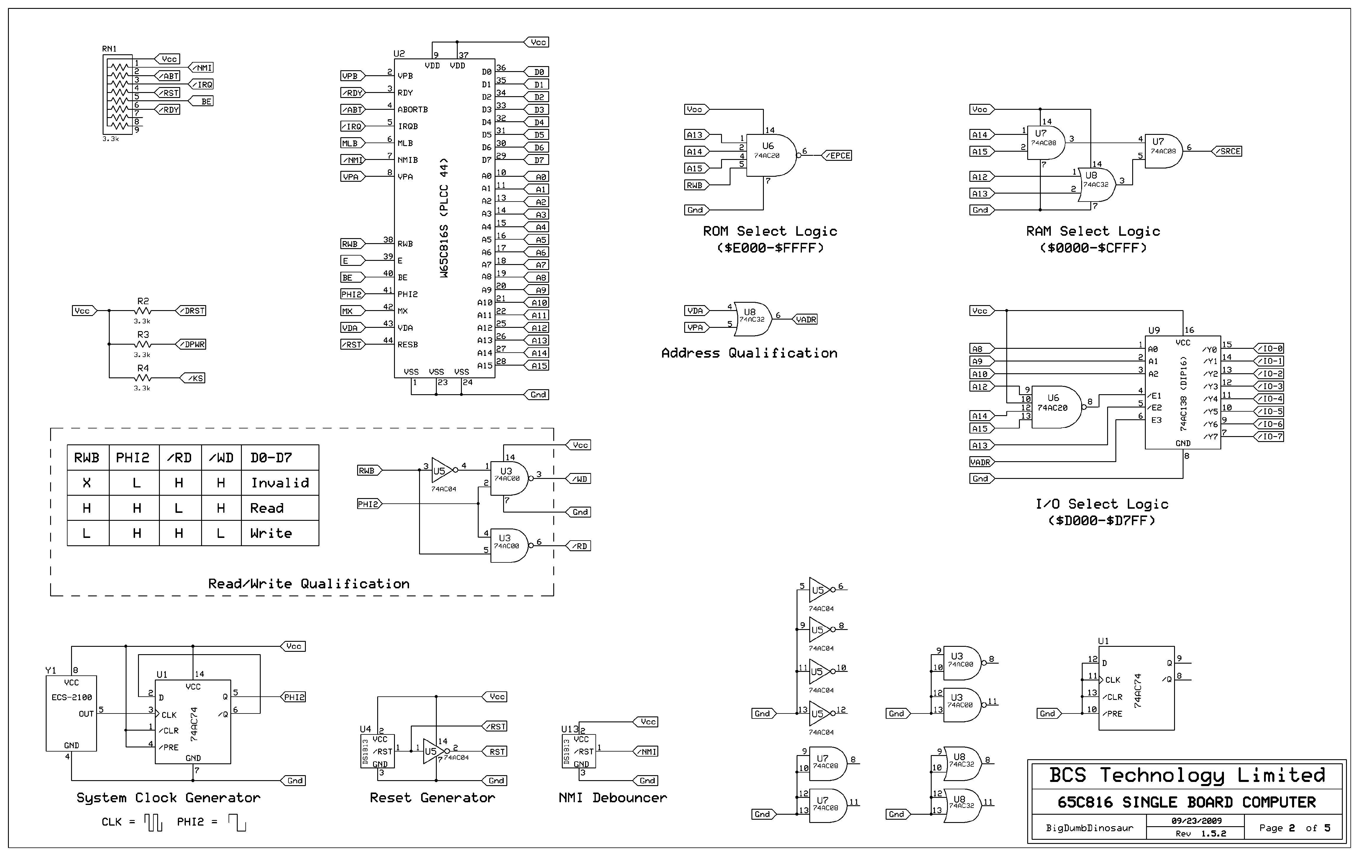

Naturally, your glue logic should be 74AC or 74HC, not 74LS.
You don’t mention 74HCT for a reason?
The '154 in CMOS is in a .300"-wide skinny DIP
actually my supplier does have both, .300” and .600” DIP.

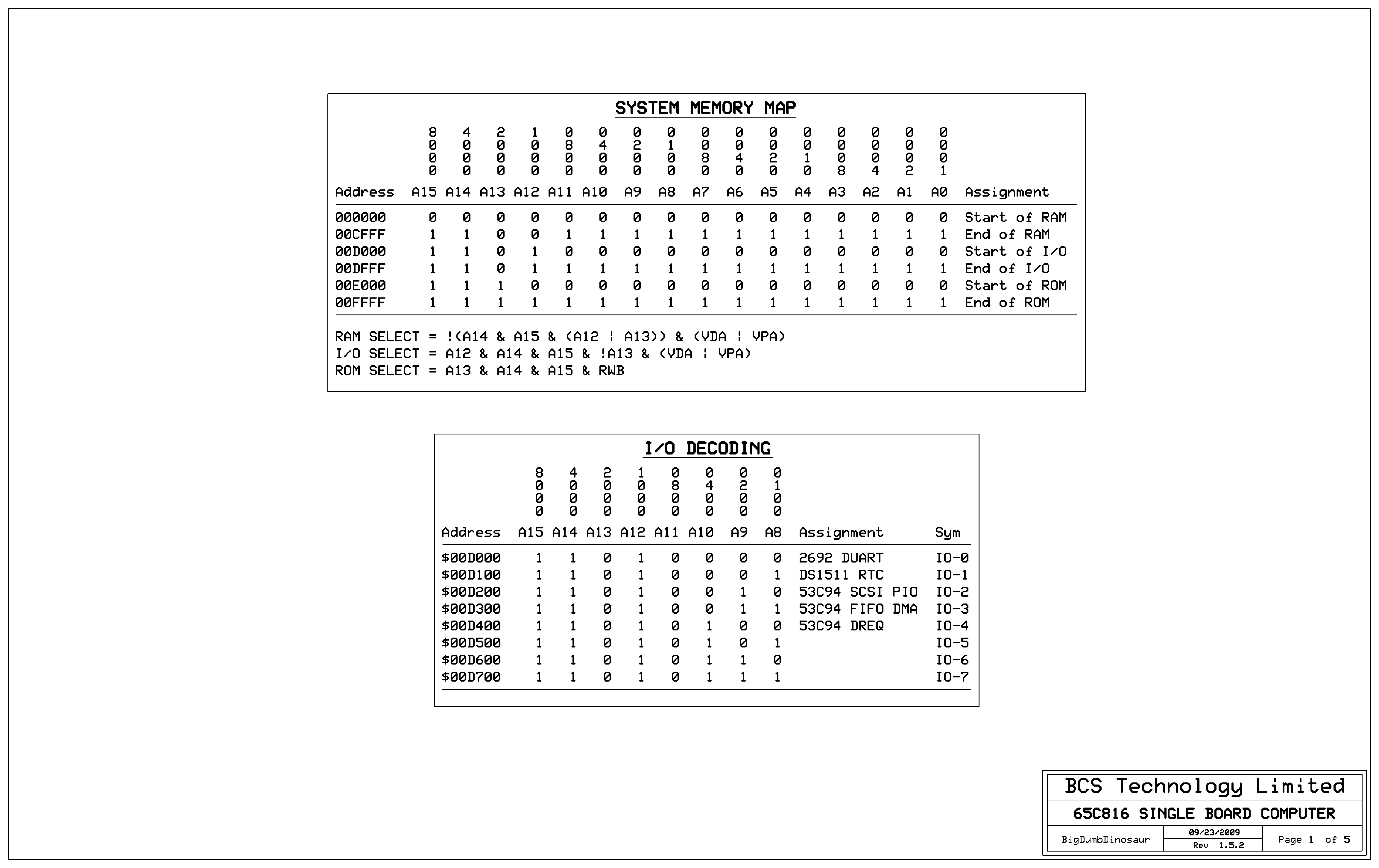

A bit of technical pedantry: "banking" in the 65C816 sense is nothing like what you would see in a C-128. The C-128 was dependent on the actions of the 8722 MMU and the PLA (which was most of the C-128's glue logic) to select one 64KB bank or the other, maintain a common area at low RAM, and map ROM and I/O in or out as needed. The ability to configure a common area was de rigueur as without it, bi-directional cross-bank transfers were all but impossible (BASIC would not have been able to run). Also, the C-128's kernel had to write some ISR front-end code into both RAM0 and RAM1 to assure that the 8502 would have a place to land when an interrupt occurred. That code had to push the registers, read the MMU configuration at $FF00 and push it, and then write $00 to $FF00 to map in the kernel ROM. It was a complicated and somewhat fragile arrangement with which I got very familiar back when I professionally programmed that machine.
In contrast, the 65C816 can address a full 24 bits of RAM with minimal glue logic (a 74AC573 or 74ABT573 latch to drive A16-A23 from D0-D7 and an out-of-phase clock to gate the '573) and without the need for common RAM areas. Several ways are available to access the entire 16MB space without any special steps, including using a 24 bit direct page (aka zero page) pointer. When an interrupt hits, the '816 will go back to (program) bank $00 to fetch the ISR vector and start executing the ISR without the rest of the hardware having to do anything special. When the ISR RTIs, the '816 will return to the bank in which it was executing when the interrupt hit, again without the system logic having to do anything special. That is all in stark contrast to the hoop-jumping done by the C-128, and is much simpler than trying to make a 65(c)02 address more than 64KB.
That said, you aren't obligated to use the A16-A23 address component at all, and can completely ignore it like I did with my POC V1 units. As long as the glue logic is correctly implemented, the '816 will pretend it only knows about a 16 bit address bus and will behave like a 65C02 on a big dose of steroids. You can run the '816 in emulation mode (the default at power-on or reset) until you get comfortable with your system, and then start exploring native mode and 16 bit programming. Once you get some experience under your belt with this hardware you can design version two with A16-A23 decoding hardware and rig up as much RAM as you want.

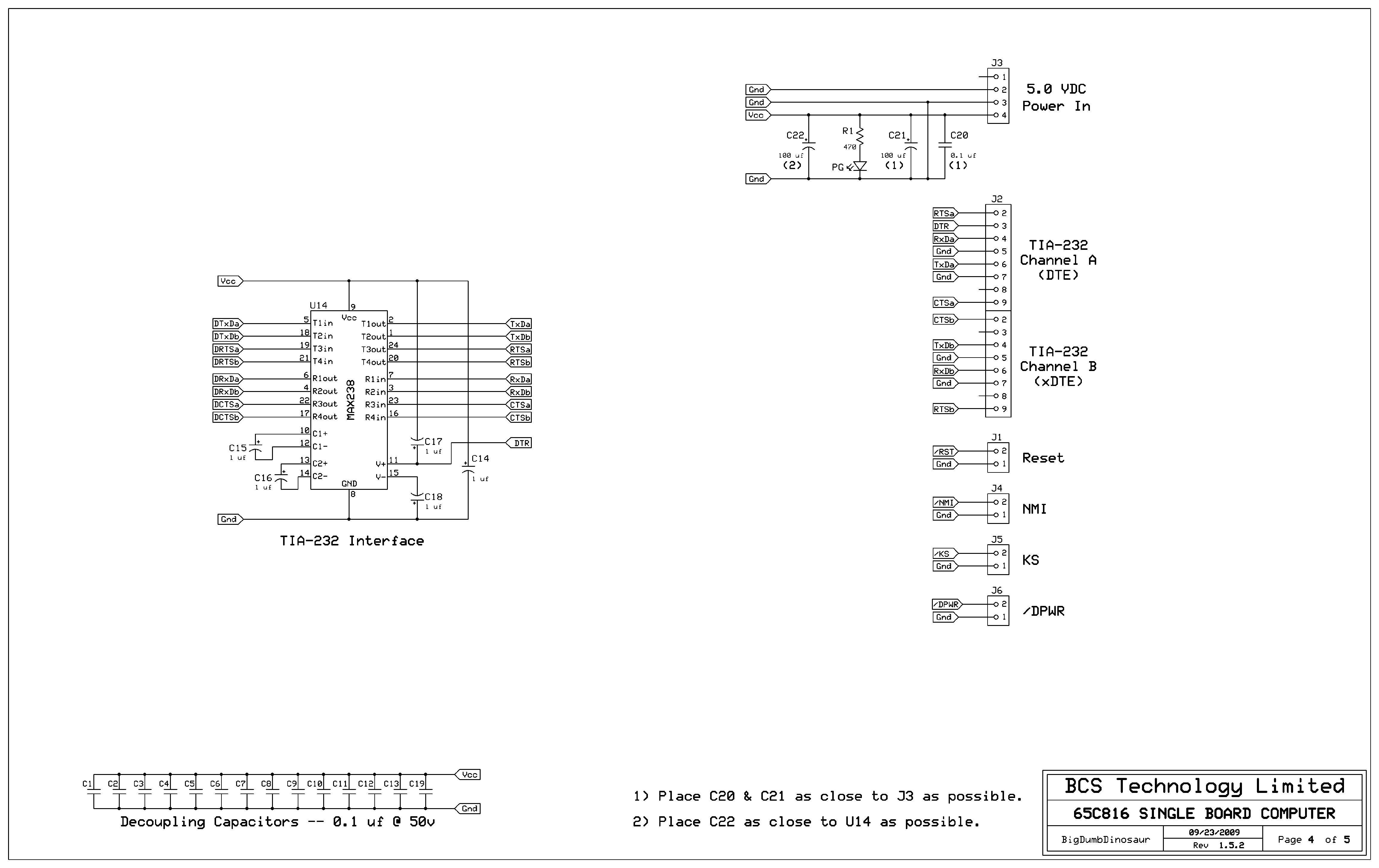

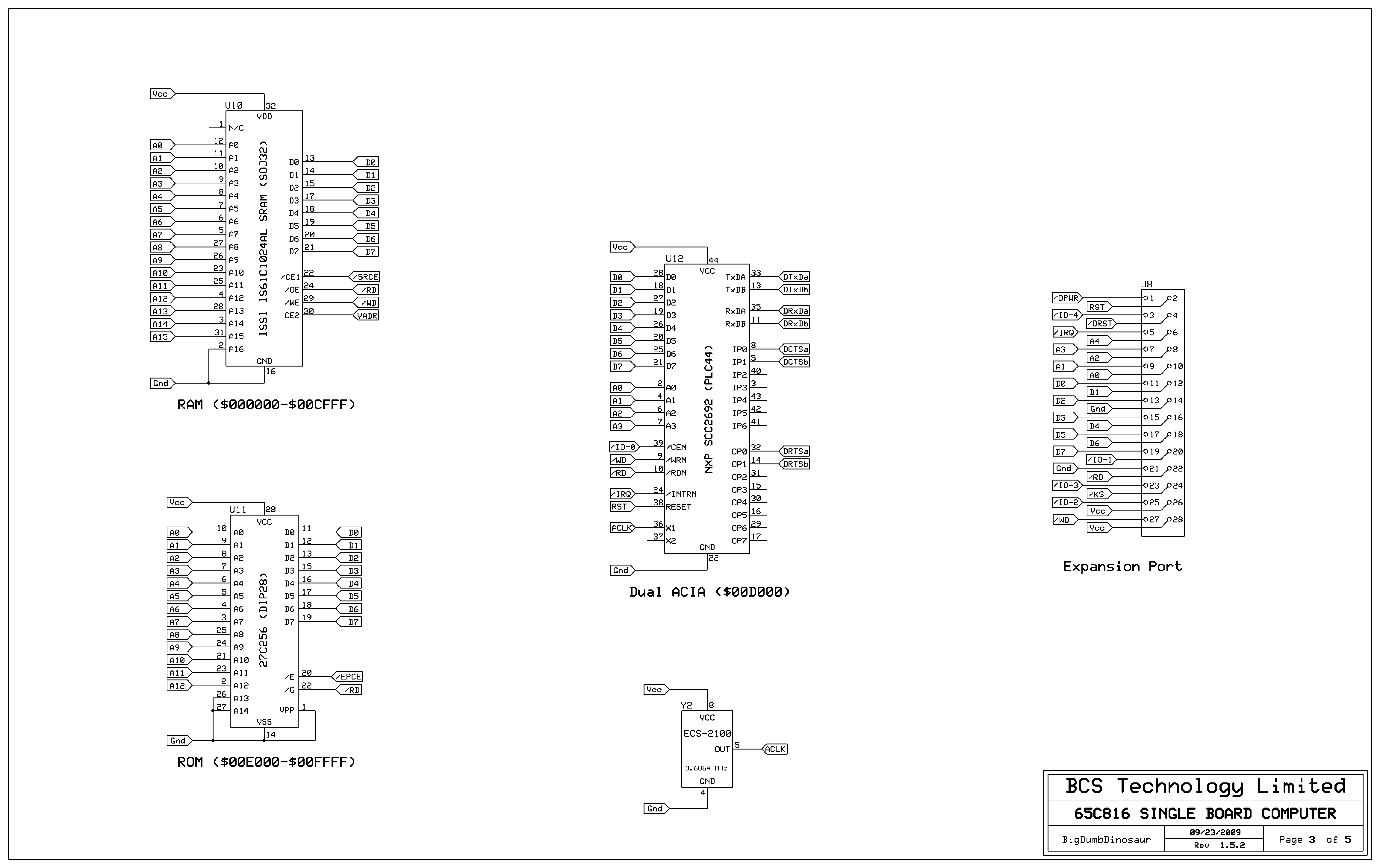

Excellent. My website is due for more updating but time has not allowed me to do a long burn on it. The schematics you found, however, contain the hardware bug-fixes that corrected timing issues that popped up in the initial unit (V1.0).
Edit: I attached the schematics for POC V1.1, which are more up to date that the schematics you found. As I said, I need to update the website. I omitted the SCSI host adapter schematic.
POC V1.1: Memory Map
POC V1.1: Microprocessor Interface
POC V1.1: RAM, ROM & I/O
POC V1.1: External Interface
