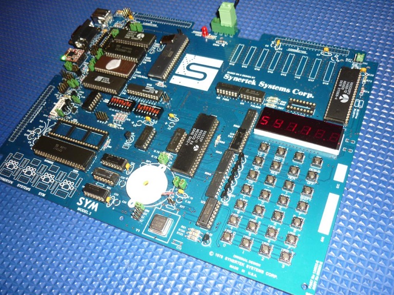

Posted: Sun Apr 28, 2013 7:49 am
by andysa
I have used a variety of sources for the 6502, 6522 and 6532 USED in this project, as can be seen in the photo.
What is not immediately apparent though, is the 6522 for IC U25 at the top of the board, which is actually a WDC W65C22S6TPG-14.
6532's are indeed getting hard to souce. I relied on Ebay for mine. It appears to work ok, though I am a bit suspicious of the date code and whether this is a genuine Rockwell device.
So, my progress so far...
A SYM running Supermon 1.1, RAE and BASIC.
Address decoding using a 22V10 PLD.
USB interface based around a FTDI FT232BL
Minimalistic file system using a 4D Systems "uDRIVE" SD card module (the small red board mounted just below the DB15 connector)
In regards to making the PCB available, I dont know what the legalities would be in doing this.

Great job! I'm interested in that SD interface for the AIM-65. Glad you got a 6532...did you get it from China? Also, legally IMHO, you designed this so you own it...if you're worried about an infringement suit. On the other hand, disclaim "for your own use only" but put a copyright symbol on it via screening or sticker or scratched on and you should be good to sell them with all your rights reserved. This is not something that is going to raise a big ruckus by any owner's of the SYM-1's rights unless they want to buy it from you and distribute it. The SuperMONITOR code is way past its copyright period IMHO. Good luck!
If that 6522 really is a W65C22S you may have a not-too-obvious problem involving the device's totem-pole IRQ output—the NMOS 6522 had an open-drain IRQ output. You should be using the W65C22N for an exact replacement. Did you isolate the VIA's IRQ output via a Schottky diode?
If my fading memory correctly serves me, the Rockwell 6532 was an exact clone of the MOS Technology part, as were RIOTs produced by other sources. So its pedigree is probably not important.
