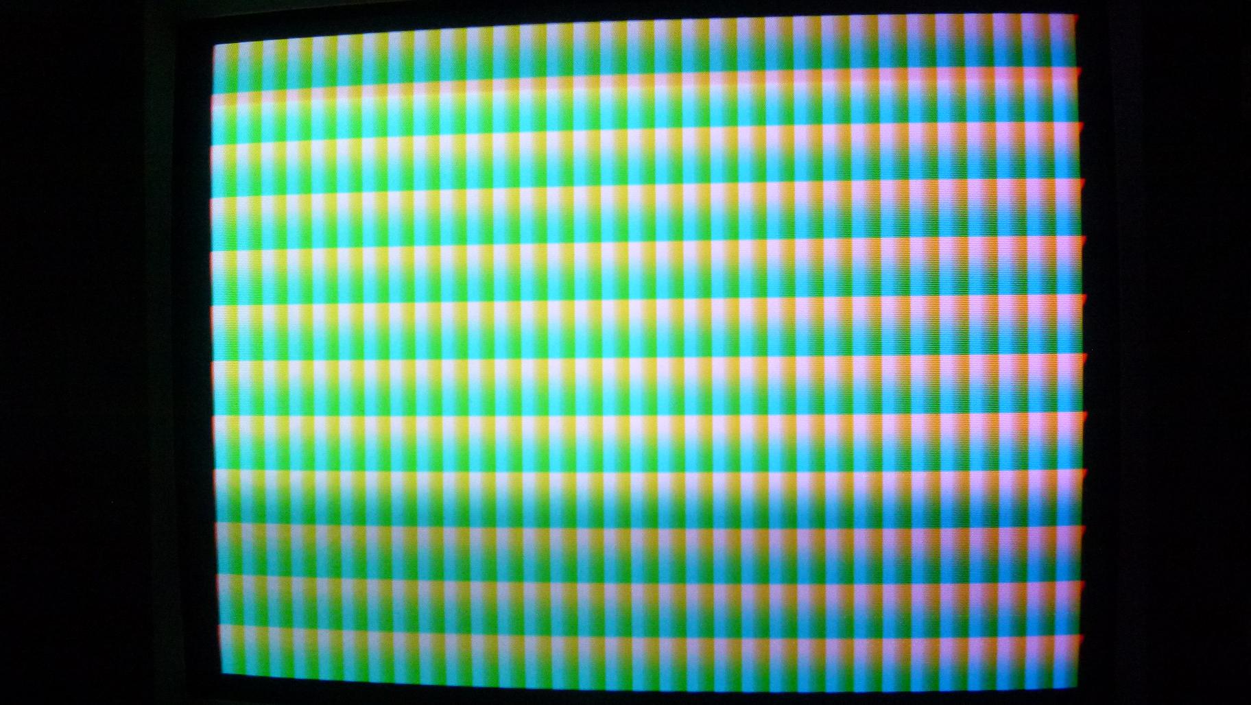

Also, with:
...AA          STA ($0000),Y        ;$8000_0000 begin videoRAM
            INC A
            DEY
            BNE AA
:D
ElEctric_EyE
Posts: 3260
Joined: 02 Mar 2009
Location: OH, USA
Re: Interfacing external RAM to a Xilinx FPGA using Verilog
Post by ElEctric_EyE »
An interesting observation:
Writing all blue pixels ($001F) to the videoram results in a almost 100% blue screen with different shades of blue present.
Writing all green pixels ($07E0) results in 100% green.
Writing all red pixels ($F800) is horrible, with different shades of red.
Arlet
Joined: 16 Nov 2010
Post by Arlet »
Does it get worse if you put your finger on the signal wires ? Could be a timing issue. Your code assumes the data is ready on the next cycle, but that ignores the IO buffer and trace delays. That's why in my SRAM code, you'll see that I wait an extra cycle before using the data from the bus (that was at 100 MHz using 10 ns SRAM):

ElEctric_EyE
Posts: 3260
Joined: 02 Mar 2009
Location: OH, USA
Arlet, I'll check this out tomorrow and see if I can experiment with the IOB delays, maybe change the slew_rate or do what you have done.
Here are the files needed to create the project, it should run on the board you have. I have a feeling my RST.v circuit does not last long enough because after shutting down power to the board and powering back up, red is much more consistently random. More experiments are needed...
