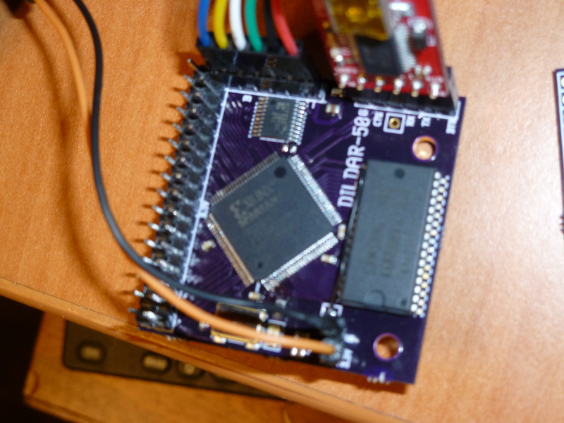

I've been working on a low cost FPGA board for a while:
This is a Xilinx XC3S50 board with configuration flash, a crystal, an LED and regulators, with 60 IO pins. It fits quite a bit of logic, or even a 6502 core (Arlet's) with 8K RAM/ROM running at 100MHz and a UART in less than 1/2 available space.
Members of this board can order from me directly (PM me), US$20 (plus shipping) while supplies last. I will have a bunch of them at the end of the month.
The second board also has 128K of fast SRAM capable of running a 6502 at 45MHz (in preliminary tests). There is only one row of IOs (30 pins) as the rest are used by the SRAM and UART connector. US$25 (plus shipping) for 6502.org members.
I will soon start a new thread about these boards and of course publish all the specs and code I have available.
I am negotiating with manufacturers and trying to keep the price affordable. In the meantime I've arranged for a small run with parts I have in stock.
P.S. The pins in these prototypes are soldered on top, but they can be soldered down. With only one row down on each side they can be placed into a breadboard.

Great boards and very nice to see that you'll sell them to us!
I assume they are 3V and not 5V tolerant? As such they don't quite address the replacement of XC95XX, but certainly deserve a thread of their own. And a mention in our FPGA dev board roundup thread (viewtopic.php?f=10&t=1787).

The boards are officially 3.3V, but can work with 5V systems using a trick (a 300 ohm resistor and a setting that activates an internal diode CORRECTION: internal clamp diode is always on, so just a resistor should do it). I've never used Spartan 3 chips in 5V systems, but others have.
Shipping to Norway from US is $2.10 for first class and goes up quickly for any tracked services. Priority Mail is $23.95.
The boards are shipped without the pins attached (different people may wish to connect different pins), so they are rather flat and should be able to go first class in an envelope, but I found that a lot depends on who is at the post office desk and what mood they are in.
My other project, 6502 Playground uses a different chip (XC3S700AN) and has a 6502 onboard. It is not related to this one.

A clarification after much searching:
Spartan 3 devices should work with 5V circuits with a simple 300 ohm resistor. The internal clamp diode is always enabled, so nothing else should be necessary.
Re: A cheap replacement for the now already antique XC95xx C
Posted: Fri Aug 16, 2013 4:55 am
by Arlet
When interfacing 3.3V and 5V parts, keep in mind that the 3.3V high output voltage may not meet high voltage threshold requirements on the 5V part. Check your datasheets carefully.
