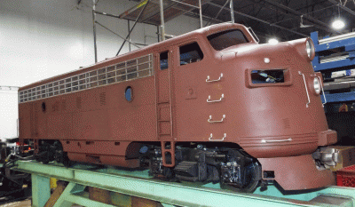

I bumped into this topic while searching for something else and recalled the discussion about my locomotive project. Here are a few pictures of it with the body installed, although not yet finished or in paint.

BDD, looks like a real labour of love. It's hard to figure it out from the pics, but what's the scale?

The scale is 1.6 inches to the foot. The unit is about 16 inches wide, 22½ inches from the railhead to the top of the (yet-to-be-mounted) air horns, 6½ feet long and weighs nearly a half ton. The prime mover is a Briggs & Stratton industrial V-twin, developing 16 horsepower.

Here are some more recent picture of my locomotive. Also a link to a video shot during some load testing. Progress has been slowed a lot by my ongoing medical issues.
