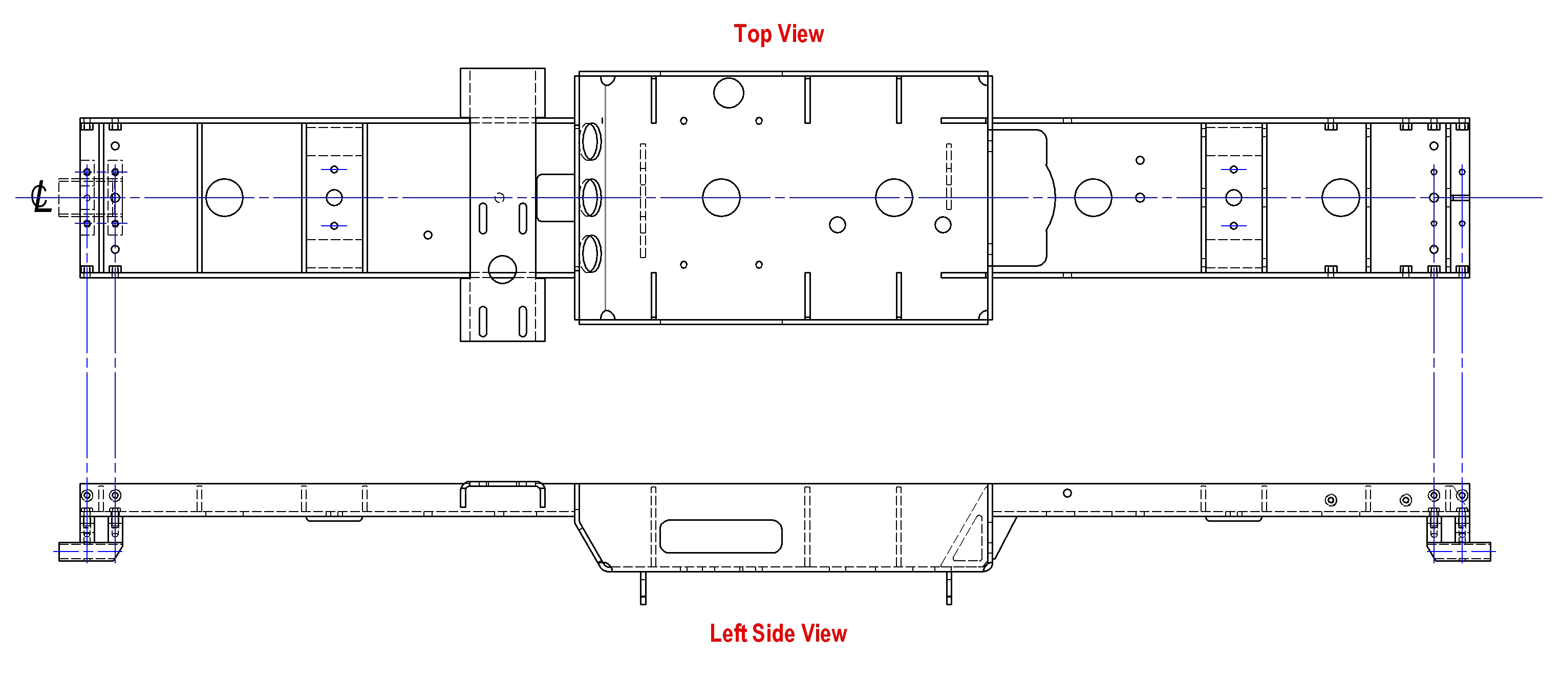

Re: TAKING A BREAK
Dajgoro wrote:
How do you bend the steel to get that U shape chassis, it is 1-2cm thick after all. Or do you order it that way?
It is 1/4 inch or 6.35 mm thick. A local shop has a large brake press that can bend that stuff. They also have laser cutters, which are used to shape pieces, as well as put holes where needed. The laser cutting is accurate to about .003 inches or .076 mm.

Access to laser cutting had a significant effect on my design. In years past, I would have fabricated something like this from sections of tubing and/or CF bar stock (frame rigidity is paramount in a locomotive, and weight helps as well). Using laser cutting, I could build the frame from formed pieces cut from hot rolled plate steel, achieving the same degree of rigidity, and with much less fitting and welding. Basically, the frame is in three pieces, the middle section being the most complex (it's like a tub). Simple fixturing, along with using a modified Black & Decker laser level to align everything, was all it took to create the frame. After welding, the overall length was within 1/32 inch (0.8 mm) of the designed dimension of 76.375 inches (193.99 cm). The welded frame with all brackets in place weighs about 145 pounds (65.9 kg).

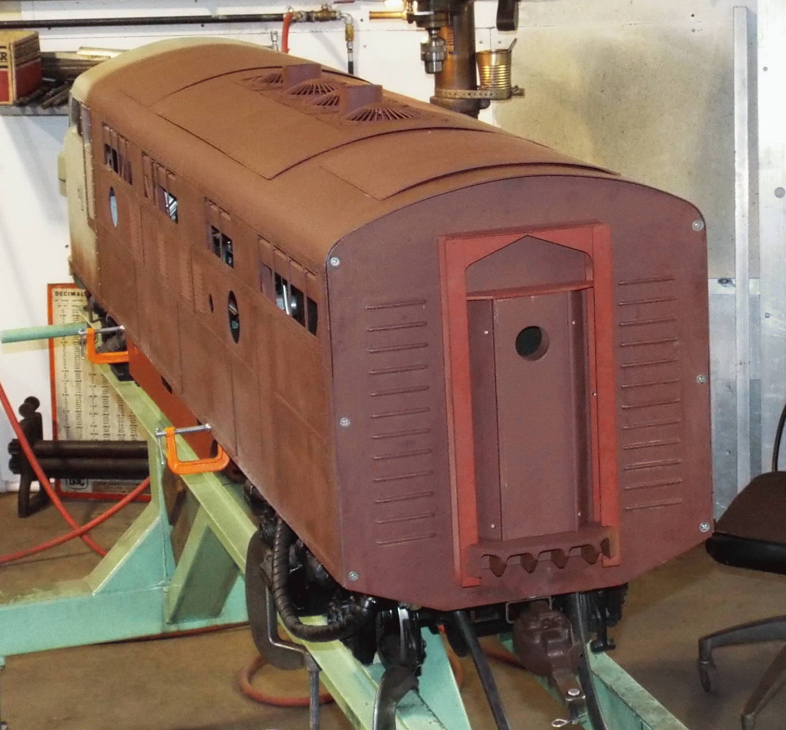

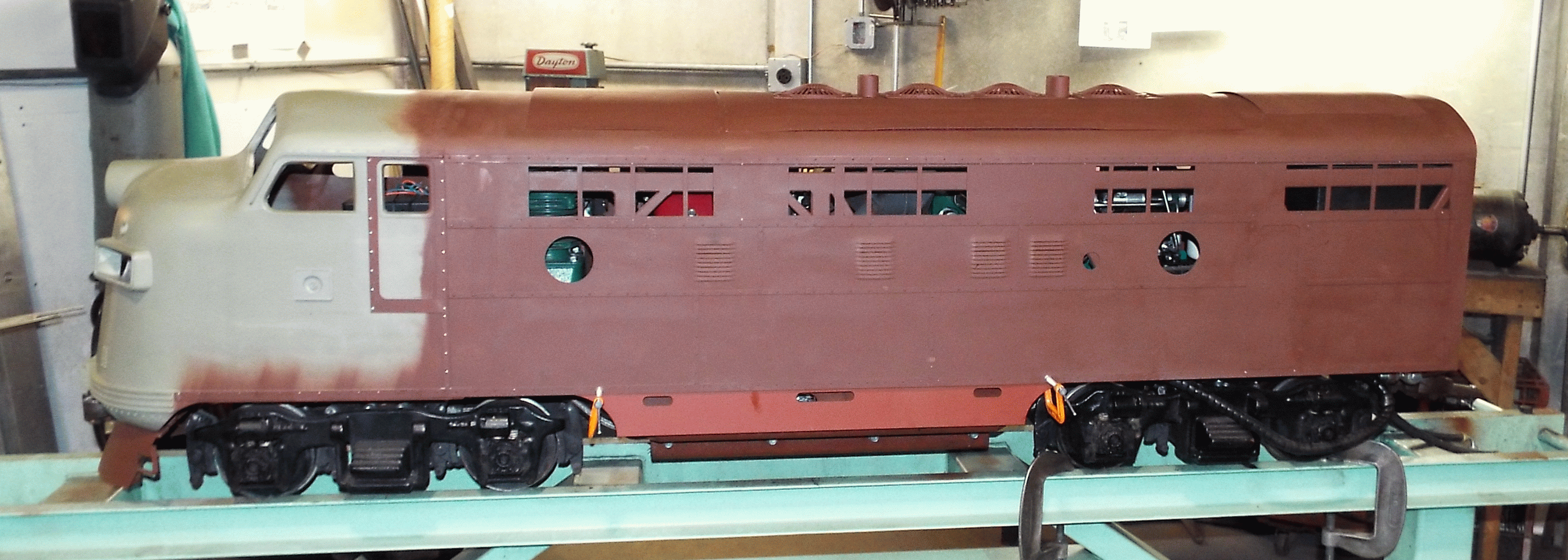

I bumped into this topic while searching for something else and recalled the discussion about my locomotive project. Here are a few pictures of it with the body installed, although not yet finished or in paint.

BDD, looks like a real labour of love. It's hard to figure it out from the pics, but what's the scale?

Re: TAKING A BREAK

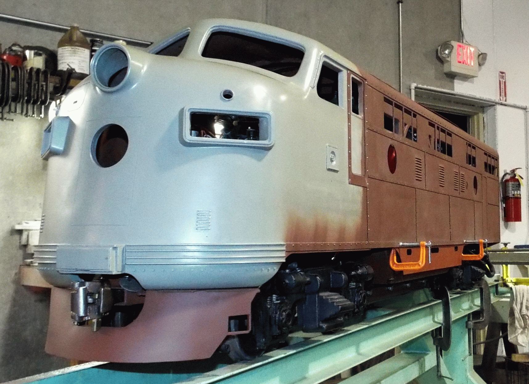

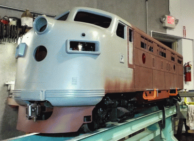

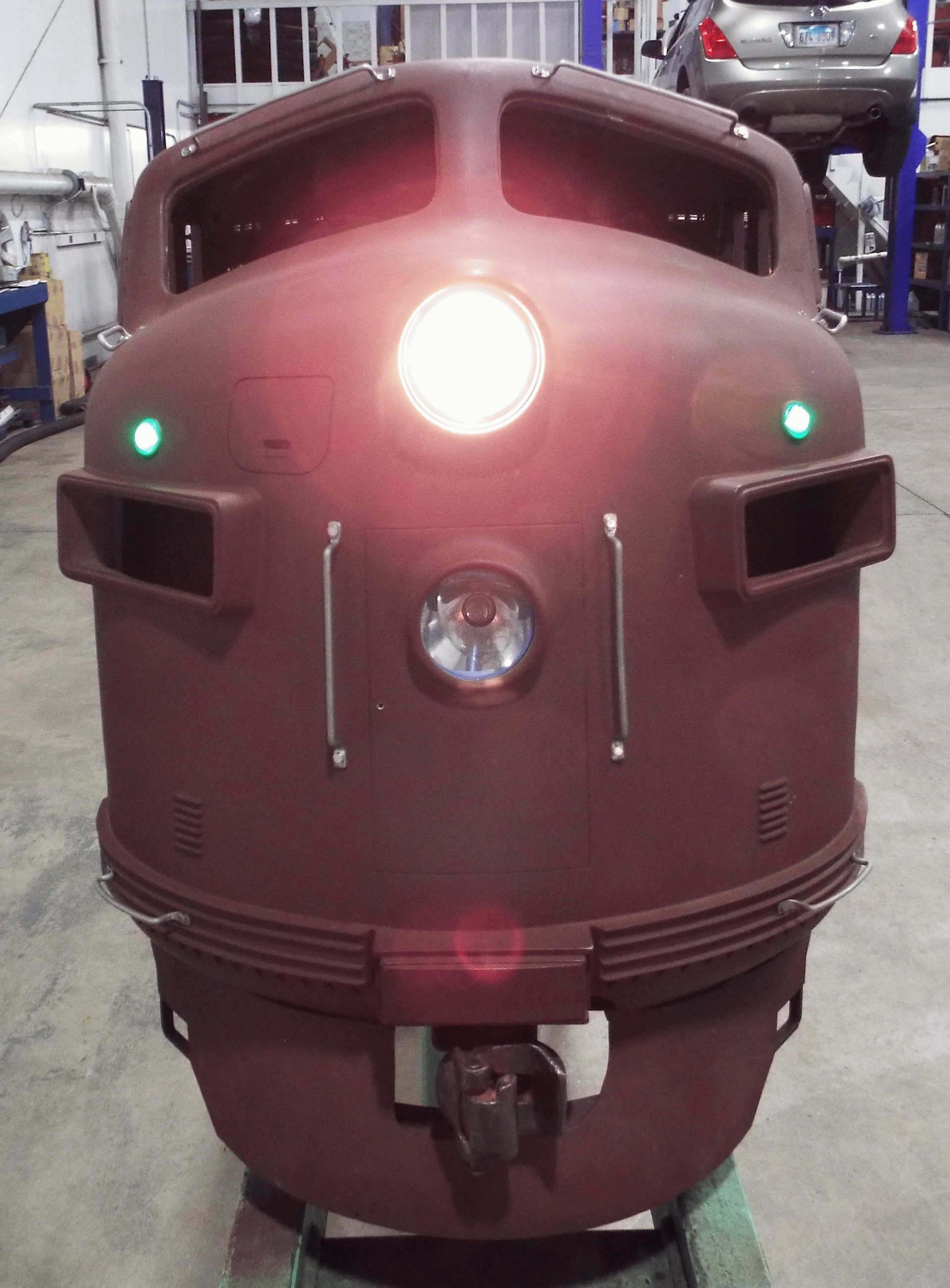

TAKING A BREAK: An Update
Here are some more recent picture of my locomotive. Also a link to a video shot during some load testing. Progress has been slowed a lot by my ongoing medical issues.
