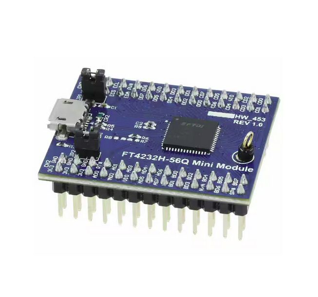

Experimental IO (including usb LPT ports) on the modern PC
Posted: Fri Jul 07, 2023 7:24 pm
by Dr Jefyll
In a post elsewhere, Ed summarizes the distinctly intriguing FT4232H. (emphasis added)
I checked the datasheet. It's a device with a USB side and a serial interface side. The USB side acts as a peripheral so it connects to a USB host. The serial interface side includes i2c and SPI modes which are driven by the chip, so the chip is the host. Also includes UART which can be bidirectional or unidirectional. Typically you might use UART mode and connect it to the UART on your own project. Either side can then send bytes to the other, and it's up to you what protocol you build on top of that. The chip also includes some GPIOs, so the host side can control those to bit-bang some other protocol, although I would guess only slowly.
Edited to add: the data sheet for the chip, and an image and datasheet for the FT4232H-56Q Mini Module.
