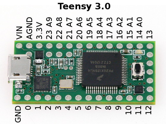

be quick to catch this Kickstarter: from $22 for 48MHz ARM dev board
(will be available commercially in due course.)
Edit: just 16kByte RAM
