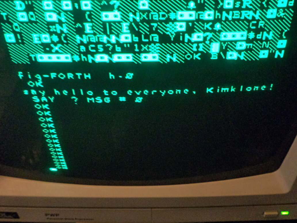

This last shot is just silliness, hamming it up for the camera. After the Fig-Forth greeting and OK prompt, you can see I've entered a text string in English -- not Forth.
Playing coy, perhaps, KK responds with message code zero, indicating it hasn't recognized the first word, "say." (Then I hit CR a bunch of times to bring the dialog to center screen.)
