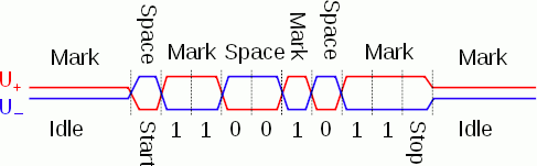

I'll try my hand at a description that's short yet useful.
In interfaces, bits go through one at a time, not 4, 8, 16, or any other number like processor data buses use.  Obviously the receiver needs a reference so it can tell what bit it is receiving at any given time.
In RS-232, that reference is strictly the timing, and the transmitter and receiver must agree that every bit takes a certain number of microseconds.  Each frame begins with a "0" start bit, and its leading edge starts the receiver's timer.  Then the receiver knows when to sample the data for each bit after that, usually 8 data bits, optionally (but not often) a parity bit for error detection, and one or more "1" stop bits which also serve for error detection as well as setting up the line for the next frame's start bit.  You can see that if the transmitter's and receiver's bit clocks don't quite run the same speed, you'll be coming up with errors.  After ten bits in a frame, a 5% error is half a bit time, which will put you in the transition area between bits.  In many situations, you can get away with a 2% speed error.  RC timing is not tight enough; but ceramic resonators, which have less than 1% error, will be good enough.  Usually crystal control is used, which it more accurate.
RS-232 voltages are high to minimize interference, which is the main reason line drivers and receivers such as the popular MAX232 are used.  (There are plenty of other line drivers and receivers though.  I prefer the MC145406 which has three of each in a 16-pin IC.)  The RS-232 specification says the receiver must interpret -3 to -25 volts as a "1", and +3 to +25 volts as a "0".  (The line drivers and receivers invert the voltage, making a "1" the low voltage and a "0" the high voltage.)  The transmitter must transmit -5 to -15 volts for a "1", and +5 to +15 for a "0", and must withstand shorts to ground indefinitely without damage.  The area from -3V to +3V is not defined.  The load offered by the receiver is to be 3,000 to 7,000 ohms.  Additional lines are often used, most commonly for the receiver to tell the transmitter if it is ready for more data.  These additional lines are simple logic states (driven to RS-232 voltages), and do not have the start, stop, parity, and data bits.
Intended uses for RS-232 are for communication between pieces of equipment across a room, even a big one like a factory or large office.  RS-232 can typically go at least a few hundred feet, depending on bit rate and wire type.  It reaches much, much farther than USB.  I have an RS-232 primer on my website, at http://wilsonminesco.com/RS-232/RS-232primer.html .
If RS-232 doesn't go far enough for you, or you want something similar that goes a lot faster, you can go to RS-422 or RS-485 which are differential (balanced), and the output can come from 5V or 3V drivers since the inputs can tolerate up to 6V and you only need 200mV difference between the two wires to get a valid logic level.  Here's the idea, showing transmitting $D3:
RS-422 can do 10Mbps at 40 feet, and RS-485 can do 35Mbps at 33 feet.  Both can go at least 90kbps at 3/4 mile.  A rule of thumb for RS-485 max speed versus cable length is that the speed in bit/s multiplied by the length in meters should not exceed 10^8.  Thus a 50-meter cable (164 feet) should not signal faster than 2 Mbit/s.
