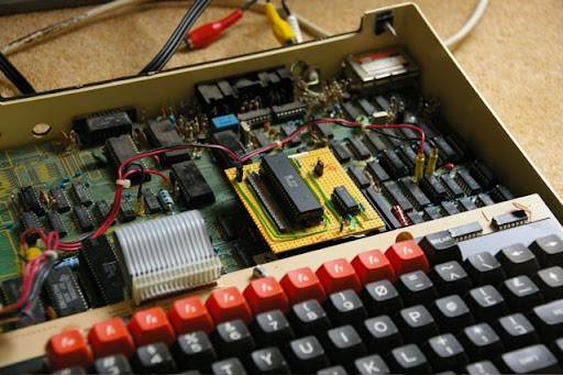

We've got a similar project, which we term our level1b board, but I think Garth is referring to the simpler substitution of just the CPU, which we term level0:

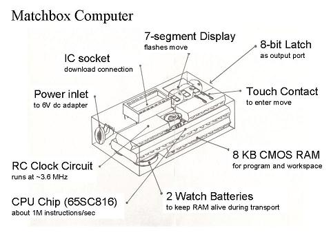

Dragging us back to the topic of running chess on a faster CPU, and to compare with the primitive stripboard picture above, our old friend H.G.Muller built a nice 65816 chess computer in a matchbox:
His pages tell the fascinating story of his Micro-Max short(!) chess program. Maybe even those 2kbytes of C would compile down to an 8k ROM...
