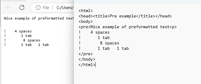

anyway the <pre> - </pre> tags have existed since the very early versions of Html: they are meant for preformatted monospaced texts, especially valid for displaying source code; with those tags any spaces or tabs are rendered as they were entered.
