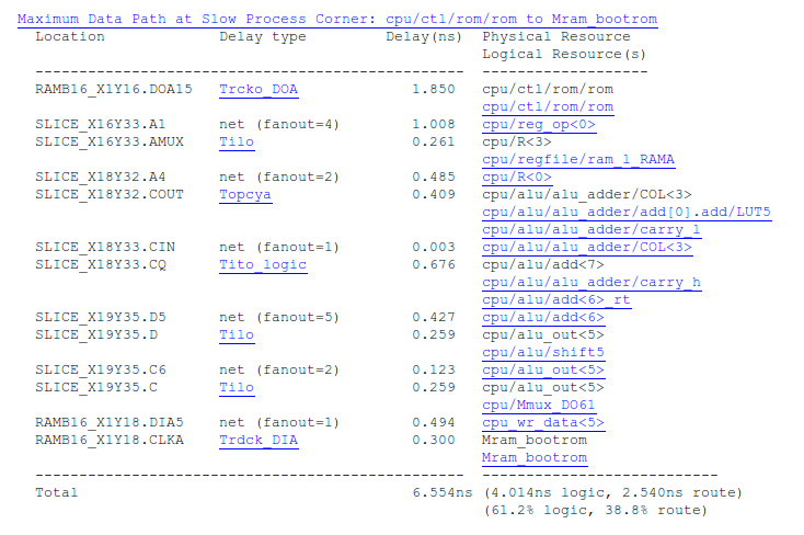

Final design, generic version, still has around 60 slices (there's some random variation in each run). Connected to single block RAM, it meets 8 ns constraint out of the box, and 7 ns with SmartExplorer pushing.
The Spartan-6 version has 120 LUTs, around 50 slices when synthesized without any placement constraints, and around 6.6 ns with SmartExplorer. I tried hand placement of a couple of things, but that only made things worse. I'll have to test some more with that, but I doubt there is much improvement possible.
Longest path in nearly all cases is microcode ROM->register file->ALU adder->ALU shifter->DB out mux->RAM. Nothing fancy, really, and nothing that suggests any possible improvement. In earlier timing runs that I did, the output mux may have been optimized away, so I got some slightly better results.
As you can see in the timing report, logic takes more than 4 ns, and routing a pretty good 2.5 ns, so there's not much hope of improving things with better placement. The critical path is already fairly tight.

There are two things that could possibly be improved in this path. First of all, getting rid of the microcode ROM could help, but since that's a big project, I was thinking I could perhaps work on that in stages. I could keep the microcode ROM for everything except the register select, and then see a) how much space it would take to generate that register number in logic, and b) how much the timing impact would be.
Secondly, if we're dealing with dual port block RAM, we can add a register stage to hold the DO+AB and do the actual write 1 cycle later. Unless you're doing self modifying code of the next byte, I don't think this would break anything.
I realize that the heavily optimized data path requires more complicated control logic. That's not a problem with a ROM, but it could be an issue with distributed logic. For instance, the ZP / ZP,X / ZP,Y / (ZP), Y / (ZP) / (ZP,X) are all handled in exactly the same way during the first cycle, namely ABL <= DB + REG, where REG is selected to be X, Y, or the special zero register. This simplifies the address logic, but it forces the control logic to select the zero register for many instructions.
I'm not too keen on redoing the entire design. My preference would be just to replace the control logic, and maintain the current data path.
