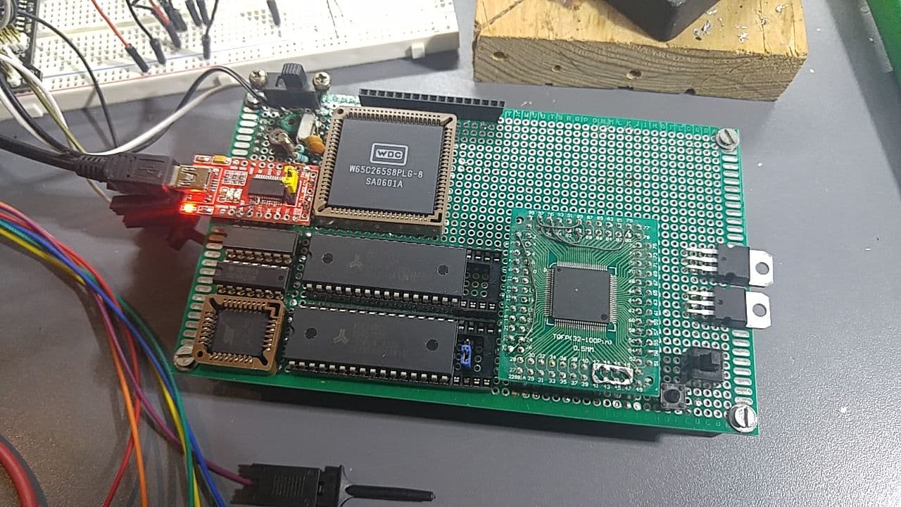

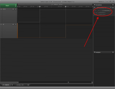

After some modifications to my board, I finally got the delay I was trying to get.
I added another 74HC00, to be able to debounce the best way they say, the reset circuit. I added a SPDT non-locking push button to get the RESB line go low and high after releasing it. And I put a RC network before the BE line so I finally got this 375ns (shown 0.375 us) delay.
I also programmed the EEPROM with a copy of the Mensch ROM Monitor in the same memory location where the internal copy is ($E000-$FFFF), but with a modified compiled date:

The datasheet specifies that there is no max time of delay of BE after RESB for the emulation mode to be set and external memory used, instead of the internal one.
So I just can understand why it doesn't boot from the external chips... I'm doing wrong, or I'm misunderstanding the BE driven BCR setting.

Mistery solved: the BE driven BCR mode has no purpose other than testing the chip by using in circuit emulation mode. It has nothing to do with the use I had understood of making the '265s boot directly with external memory.
So now I have to think of another method to be able to have a kind of 'debug mode boot', and I think how I'm doing it:
I'm repurposing the debounce circuit I implemented as a way to cut VDD to the EEPROM chip, so the '265s will not be able to detect it while the push button is kept pressed while also pressing the reset button, or powering up the board. Once in booted in the Mensch ROM monitor, the user could release that button and have the EEPROM powered again, so it could be read and erased by using 265SXB-hacker.

I have a board with "user boot" and "debug boot".
I repurposed the debounce circuit, and now it's powering the EEPROM.
So as intended, I now have two buttons in my board:
- "reset" button
- "debug" button
If I press the "reset" button alone, it will boot to sxb-hacker directly, as I programmed the EEPROM with the hacker starting from $8004, and put the 'WDC' string in $8000.
If I press the "debug" button first, and while kept pressed I press and then release the "reset" button, the EEPROM gets no power and the board boots into Mensch ROM Monitor. Then, I can release the "debug" button so tbe EEPROM gets powered and access it to erase it if needed.
I also added
lda	#$FF
sta	SSCR
in the reset routine of the hacker, and I think this way the '265s is using only external RAM, but I have no equipment to confirm this.
Of course that this is all only proof of concept.
