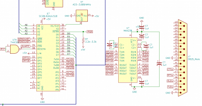

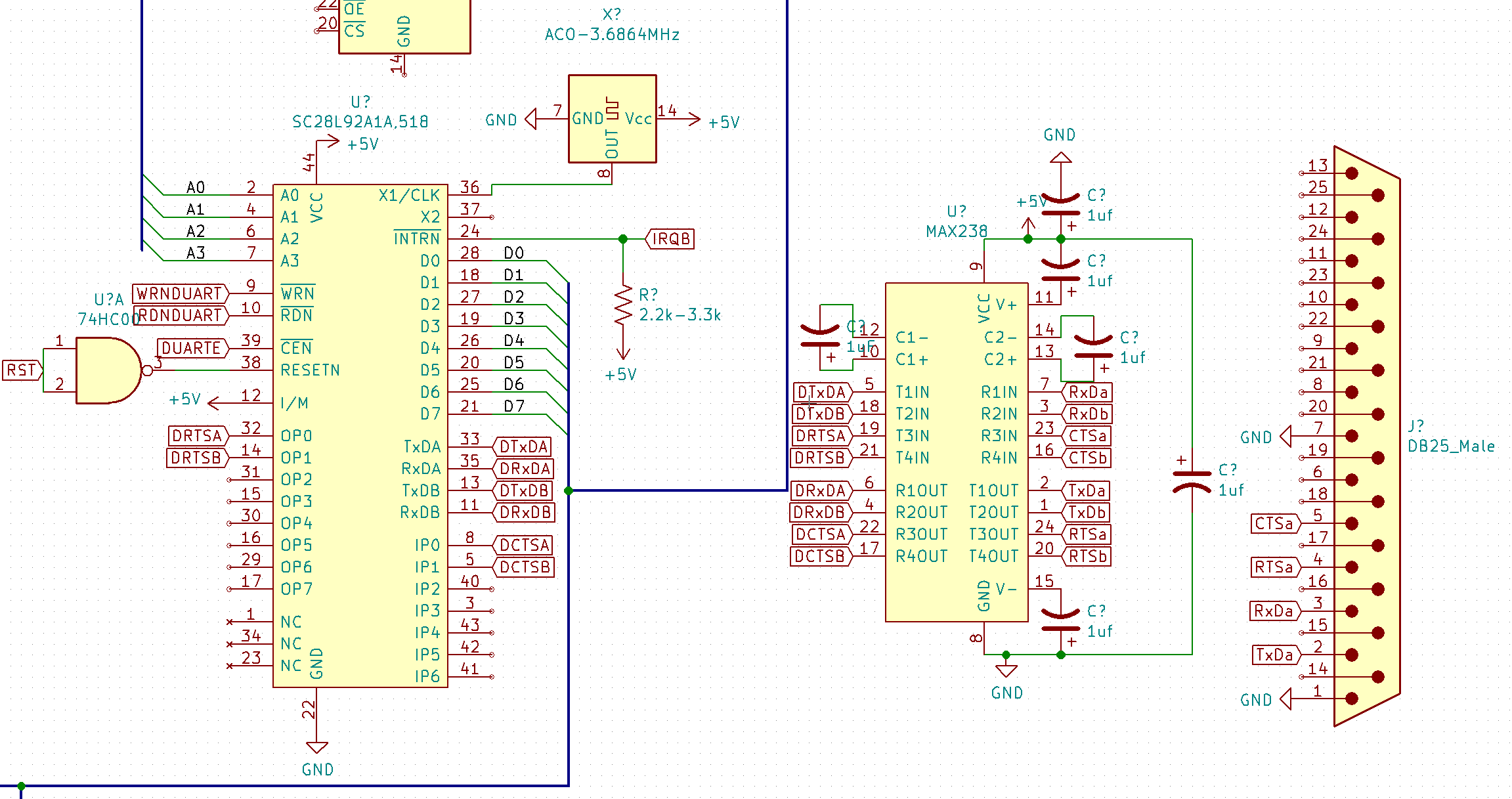

An update, I've began laying out the schematic (again, somehow I guess the program crashed while I was gone or something, wasn't open and my schematic was gone) and I've decided to incorporate the 28L92 (in plcc package from mouser) since I'm already having to use a plcc for the 65SPI. Because of this, I can use the documentation for it and make it a lot easier to integrate it as a DUART.
I do have a question though, and I think BigDumbDinosaur may know the answer. In the documentation on integrating the 28L92, it states to use a 3 to 8 converter for selecting the UART, listing the other 7 outputs as "fill as necessary" or similar. Are the other pins for other IO chips? Or are the other pins used within the UART somehow? If anyone knows the answer drop it here, I'll post the schematic once it's more fleshed out.
Re: 65XX SBC general help and color display help needed
Yes, those are for other I/O devices. The 3-to-8 decoder is part of your address decoding circuitry.

I've just finished setting up the backend of the RS232 circuit (address decoding is on its way to it, just have to uncomplicate my memory map) Here's a picture of the relevant area of the schematic, does it look right to everyone?
(BTW, I've been making KiCad parts like crazy, if there's somewhere that, when I'm done, I can put all these parts so others can have access and use them in the future that would be great)
