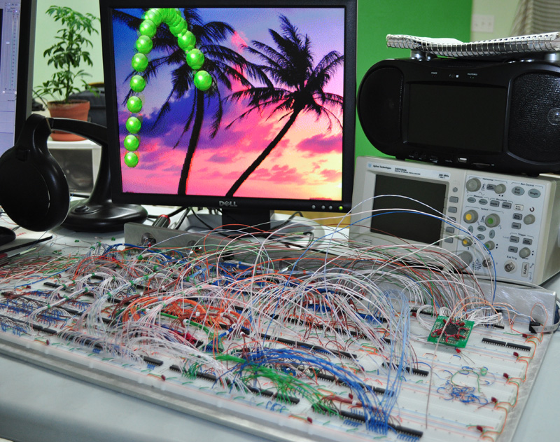

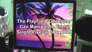

I did some testing on the new added feature that allows the PlayField Generator to select a start and end line to draw rather than simply blasting the entire 400x300 windowed section to the Video memory, and it worked great! By selectively rendering lines from the giant PlayField memory, cool effects such as Parallax Scrolling or entire screen manipulations can be done.
At this point, I would call the Video Section of Vulcan-74 complete! That's a good thing, because I am almost out of board space.
There "might" be enough room for the 6502 and multiplexing circuit, but if not, I will just jack in another large series of breadboards and forge ahead!
Just think... the final version will have almost as many ICs in the Sound Generator as I have on the board already!
So here is the messy state of the board as of tonight...
Initial wiring is never pretty!
Since I am satisfied with the 32/16MHz speed of the new and improved PlayField Generator, it is time to clean up all the wiring and claim success.
A few more demos and tests will be done to really work out the hardware, and then the 6502 gets a new home.
Check out this quick video demo that draws the PlayField Image to the screen by shifting every single horizontal line one at a time...
https://youtu.be/XuzK2BwvmKQ
I threw in a few dozen Sprites as well just to show off the raw screaming retro power available in this tangle of 20 cent chips and wires!
The next demos will show something a lot more interesting that bouncing balls and warping screens!
So far so good... 120 logic chips, 4000 wires, and a 15 foot square breadboard running at 30 MHz!
Until next time!

I will now continue to clean up wring and then post some photos of the project before moving onto the 6502 / IO stage.
What is interesting is that Vulcan-74 uses only 12 different ICs! They are...
74HC04
74HC08
74HC32
74HC193
74HC590
74HC4017
74HC74
74HC139
74HC574
74HC245
74HC688
CY7C1049
In the final design, the only new part will be the 6502, so the entire project will be made of only 13 ICs, 11 of them standard 7400 logic components.
The Sound System will also use only the same ICs.
I will be able to describe the final unit in 2 vastly different ways...
- Vulcan-74 is a Retro Game System built using only 13 ICs.
- Vulcan-74 is a Retro Game System built using over 240 ICs.
Will post some photos of the cleaned up board soon, along with some better video demos showing the various features.
I also have the dual joystick function working, so will add that to the video.
Radical Brad
Each wire that is not a bundle is hand shaped and then installed (like a muffler installed in a car!).
It's like doing surgery! Very carefully trying not to rip up other wires as I feed the snake-like wire into the board.
Gave some thought about re-introducing the palette option, but then remembered why I left it out in the first place.
To make this work, I would need at least 2 extra SRAMs (3 for 24 bit color), which would mean 512K SRAMs since there are no 12ns 32k DIP parts.
I did find 15ns 32K DIP parts, but this timing crawls over the safety margin ever so slightly for 20MHz operation.
The other issue is that a blanking and buffer circuit has to be added for every SRAM in the palette system as well.
In previous tests, I concluded that you cannot drive the DAC directly from SRAM output due to imbalanced propagation in the output.
The output MUST be latched up via 74HC574 or some banding will be visible on the monitor. Yes, a monitor can see .5ns!
I got away with this for NTSC or CRT VGA monitors in the past, but in this project, I am driving a new LCD monitor.
One of the rules... perfect video with absolutely no glitches or artifacts, so I will keep things they way they are now.
Having met all of my video goals (plus the added PlayField Generator), I have decided to finally stop feeding the monster!
I also wrote an image / sprite processing PC program as well, and it uses the current RRR-GGG-BB color space to convert BMP to data.
74HC04
74HC08
74HC32
74HC193
74HC590
74HC4017
74HC74
74HC139
74HC574
74HC245
74HC688
CY7C1049
Radical Brad

Update : Vulcan-74 Expands!!
In order to deal with the lack of real estate, I am making another 24 panel breadboard to double the size of the project.
Yep, this thing is going to double in size with the Sound Generator! The new giant board will be 48 panels in size!
Since the Video System and Sound System are completely independent systems, I will make 2 separate 24 panel boards and simply connect them with an 8 bit bus and some control wires. This will make it a little easier to work on the board, since the 2 panels together will span almost 5 feet wide!
My new expanded breadboard will have 830x48 = 39840 tie points!
Hopefully, I won't run out of breadboard space, or I will have to knock down a wall and expand my lab into the bar area of the basement, and this would not go over well with Mister Daniels, Morgan, Beam, or Cuervo.
Now back to wire cleanup as I await the next shipment of breadboard panels.
...Any doubters lingering out there that say a breadboard with 240 ICs can't run properly at 20 / 30 MHz!??
Radical Brad
