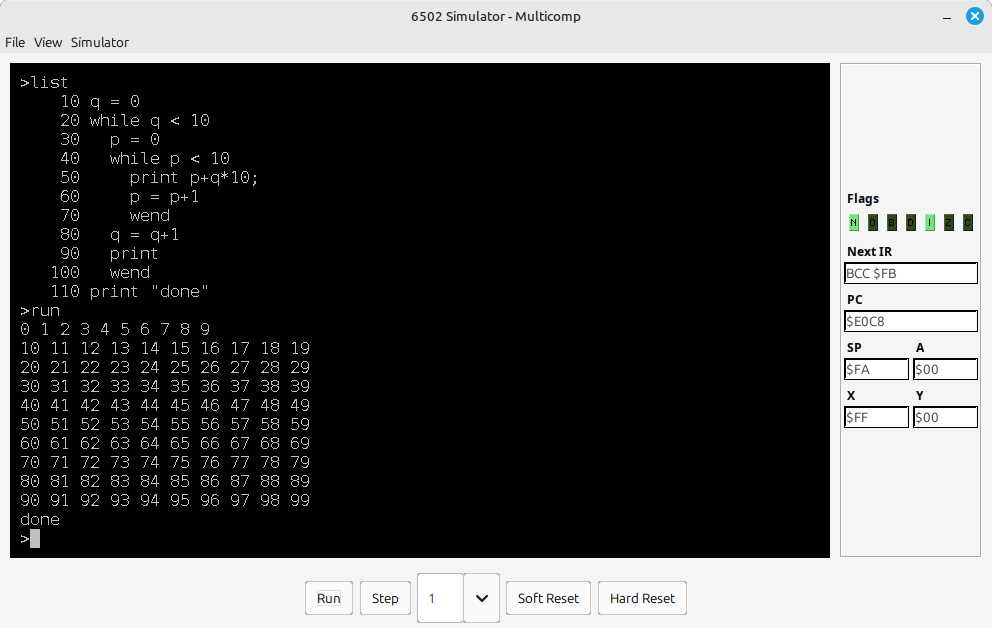

Oops, I forgot to show the while/end demo.

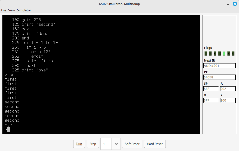

Here's a little monstrosity that someone evil might try. What should happen? I note that some online BASICs simply refuse to even give it a go:
100 GOTO 225
125 PRINT "SECOND NEXT"
150 NEXT
175 PRINT "DONE"
200 END
225 FOR I = 1 TO 10
250 IF I > 5 GOTO 125
275 PRINT "FIRST NEXT"
300 NEXT
barnacle

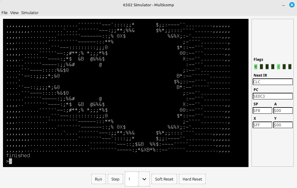

Here's a traditional test: on the simulator at a nominal 8MHz it took almost exactly two minutes (and at a nominal 1MHz twelve; something ain't right!)
It did the top two lines but scrolled them off the top.

Your evil code sticks in a loop, I don't know what's going on but I refer m'learned colleague to 'goto considered harmful'.

barnacle
Posts: 1831
Joined: 19 Jan 2004
Re: Neolithic Tiny Basic
Post by barnacle »
On retrying and typing it correctly (for my syntax):
And correctly continues to the next line. I am not at all sure what's happening there, but on NTB, next is just a marker, so I suspect that the next at 150 is just returning a null to the inner loop; the one that matters and has to find the next line so it knows where to go is in the for at 225.

This takes 10.5 minutes on my 2MHz (6507) system. A tokenised BASIC ought to be must faster. (Much!)
Mandelbrot - Gordons TinyBasic - Integers
Start
......,,,,,,,,,,,,,,,,,,,,,,'''''''''~~~~~=+:*$O:;==~~'''''',,,,,,,,,,,........
.......,,,,,,,,,,,,,,,,,,,,,'''''''''~~~==+%*O  ;;%=~~~~''''',,,,,,,,,.........
.....,,,,,,''''''~~=+X::+; :+++:;%                        &&=~~''',,,,,,,......
....,,''''''''~~~~=+:%  *O  B*;*%                          $=~~'',,,,,,,,......
,,,,,,''''''~~~~~=++;*X        B                            =~~''',,,,,,,,,,,,.
,,,,''~~==++++:+*&                                       O:=~~'''''',,,,,,,,,,.
Finished/[code]
