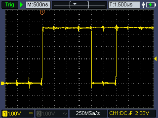

adrianhudson wrote:
This is phi2 at the 'C02 pin37 with the probe GND lead removed and a GND spring to the oscillator can (its that close)
at phi2 in pin to can with probe spring gnd.png (5.36 KiB) Viewed 4148 times
Thank you for clearly describing how you grounded your probe. I see a reasonably good looking square wave at 1MHz. I can see that you have properly adjusted the compensation on your probes (assuming you are using the 10X setting, which you should prefer when possible). I do note that GND (indicated by the thicker yellow arrow at the left of the screen) is in the middle of this waveform, but then I also notice that channel 1 is in AC mode by looking in the lower left and seeing the sine wave next to channel 1. AC mode subtracts the DC offset and puts the "average" voltage at 0V on the screen. We will generally prefer DC mode for all waveforms for digital logic work except for a few special cases. I do see a little wiggle at the bottom of the waveform, just after the falling edge, that might be something interesting (especially if it shows up in other places at larger amplitudes), but it is unconcerning at the amplitude shown. This is a perfectly good clock here, but it's right at the oscillator output - you will want to see what it looks like in other places (using the ground of the chip you are probing it on).

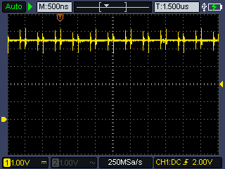

adrianhudson wrote:
This is A0 at the CPU. You can see the clock noise
A0 at CPU.png (5.17 KiB) Viewed 4148 times
This looks like a very good A0 signal. I don't see anything that concerns me here. Your ground is properly connected (looking at the large yellow arrow at the left side of the screen). I do note that your scope is showing multiple traces on top of each other (looking at the right side where it appears the signal is high and low at the same time). This is OK as long as you know your scope does this. You might have trace persistence turned on, but a glance in the user's manual for your scope does not show a way to turn it on/off. Because we are potentially looking for "glitches", we actually prefer this mode of looking at things because it will show normal looking traces AND the glitchy one if it happens while the scope is looking.

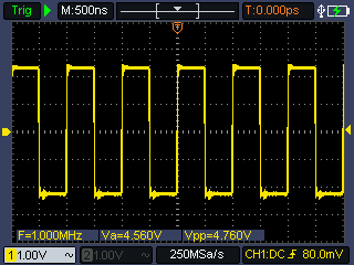

Here is +5V at the oscillator pin
5V at osc can.png (4.92 KiB) Viewed 4148 times
Normally I might be concerned at the ringing spikes that are not 500ns apart (we expect small ringing at both rising and falling clock edges, but not when the clock is steady high or steady low), however we know (from your previous scope shot) that your scope shows multiple traces overlapped and I see your trigger (the smaller yellow arrow on the right) isn't at a useful level here. Your trigger is set to 2V rising edge (as noted in the bottom right corner) however this trace has no portion that crosses 2 V in either direction, so the scope is auto-triggering (as noted in the upper left hand corner). This means the scope just picks a starting time (not synchronized with the signal) and draws the trace. Because your scope shows multiple traces of the signal on the screen, we get what appears to be 2 traces, both with the expected ringing at 1MHz rate, but they are not properly overlaid on top of each other. To fix this, move the trigger point up until it is in the trace. I'd move it up to the lowest point (below the 5V level) where it reliably triggers (as noted by "Trig" appearing in the upper left corner of the screen). Having the clock on one channel and triggering off it would also fix this issue.
It's worth noting that the amplitude of the ringing is about +/- 0.5V. That's not a terrible or unexpected level here, but it is worth looking in other places as well. Because they are only one pixel wide, I would zoom in to investigate them, but they should be fine here. It's worth looking at 5V of all the chips, but make sure you are using the ground for that particular chip so you get an idea of what the chip actually sees for power.

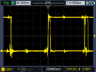

I have the pullup resistors still attached on the data lines, so I disconnected the resistor on D0 and here is a trace of D0 at the RAM chip pin
D0 at RAM pull disconnected.png (5.45 KiB) Viewed 4148 times
This scope shot is interesting. We have multiple overlapping traces of this signal again, which makes things a bit confusing. The only place where the signals really should be overlapping is at the trigger point (noted by the orange T at the top of the screen) and all traces should be a rising edge crossing 2V (as per your settings in the lower right corner). The interesting part here is that D0 is being driven high (rising edge at the trigger point in the middle of the screen) and the immediately driven low about 50ns later on at least one trace. That doesn't look like a pullup driving it high (it's too fast of a rise) and it doesn't look like it is floating - it looks like it is being actively driven high and then low. This might be related to your issue and it is worth investigating.
The other overlapping areas are inconclusive because we can't tell which trace is high or low before and after the transition. Because there is that small gap at the bottom, just after the trigger point, I can tell that there is at least 1 trace that went high and then very quickly went low. As noted by others, the older micros might be too slow to even notice but the newer WDC parts may see that and sample the data during the glitch. Having everything synchronized to the clock using a second trace would likely make this much clearer and help determine if it's a problem or not. If the falling edge is during (or even very close) to that kind of glitch, it might be your problem.

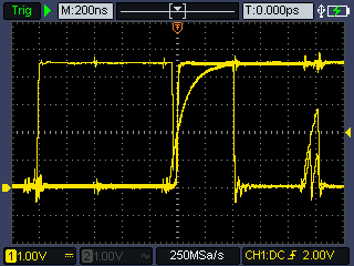

Here is D1 (with its pullup attached) at the RAM chip pin
D1 at RAM pullup.png (5.96 KiB) Viewed 4148 times
Clock noise is everywhere and what are those curved - really slow rise lines on D1 (with pullup) (they are also on D2-7)?
When using pullups, the "shark fin" sections are totally normal. That's the resistor "charging" the capacitance of the bus and is a standard Resistor-Capacitor charging curve. The resistors are there to help finish pulling up for chips that can only pull part-way up but not quite high enough (one of the potential issues were were looking for based on the discussion so far). The data only needs to be valid at the falling edge of the clock (so falling edge would be good for triggering on the clock on a second channel here), so it's technically OK to be in the middle as long as it's not on a clock edge. I don't really see any waveforms that look like the data line isn't getting high enough, and the sharkfins shown look like times the bus simply isn't driven by any chip. The sharkfin in the middle is an entire half-cycle that the bus was not driven. The sharkfin on the right is a little more interesting. The bus was undriven for about 100ns before someone decided it should be low and drove it low (most likely propagation delay in chip select and inside the memory). The little double sharkfin drawn in the same place is a little weird, though.

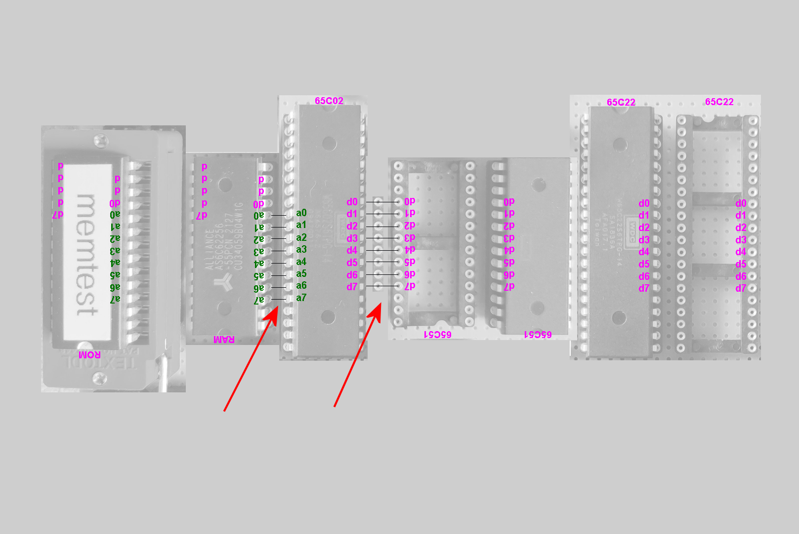

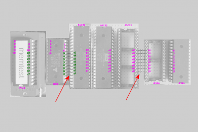

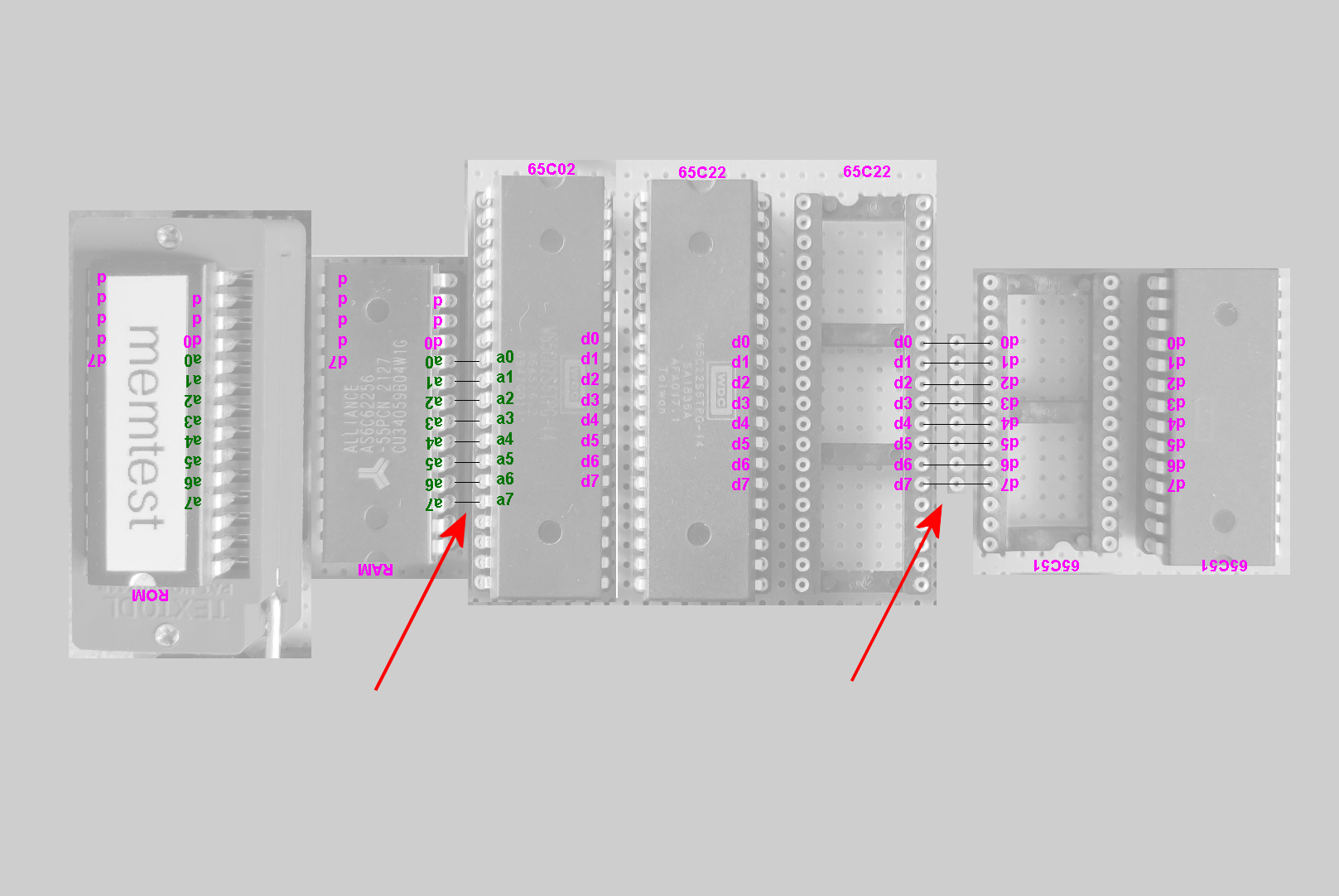

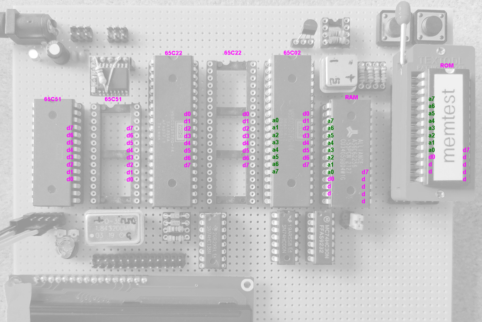

Is it too late to make a suggestion regarding layout? I'll tell you what I'd consider, and why.
Your original layout (above) is quite compact, and has all the major chips aligned with pin 1 toward the north, which is nice when troubleshooting -- you don't have to stop and think where pin 1 is. But, on the downside, the data bus pins (labeled in pink) don't necessarily align from one chip to the next. For example, among the eight databus lines, the CPU and the two VIAs have d0 toward the north and d7 toward the south. This is a partial mismatch with the RAM/ROM and a compete mismatch with the two 6551s, which have d7 toward the north and d0 toward the south.
I realize you're working with wire-wrap, and it's not really a problem for the eight data lines to do backflips and cross over one another on short notice, as it were. But consider the layout below. This too is a compact layout, and not only do the databus pins align nicely from one chip to the next; the low eight address lines (labeled in green) do, too. And favorable alignment is a distinct advantage if the design should ever migrate to PCB.
And... there's an advantage even with a wirewrap implementation. Let's face it; wirewrap is labor intensive. It takes a lot of work! But I found a useful shortcut that applies when a row of pins on one chip needs to connect to a row of more-or-less adjacent pins on the neighboring chip. What I do -- before the wire wrapping starts -- is make those more-or-less adjacent connections with bare, fine-gauge wire, soldered as it reaches each pin. YMMV, but I find this a lot faster than wirewrapping. It also conserves height on the wirewrap pins.
The red arrows indicate two sets of opportunities to use the soldered approach... and the ones on the right are actually triple decker because I included a SIP socket for a pullup array. (The socket may end up unpopulated, but it's there in case we need it.) And the soldered approach I'm suggesting avoids a total of 48 wraps.
Just a suggestion! I admit the idea involves a degree of tradeoff. But I'm lazy, and I would seriously consider doing it this way! (and all the more so if a PCB implementation might someday exist)
Even if you do use wirewrap, adjacent connections are still easier because the wire can be entirely bare -- you needn't leave any insulation.
Afterthought: because they connect to the Outside World, there might be an argument for putting the VIAs on the outside (like this):

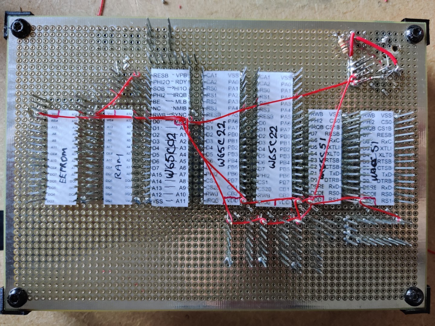

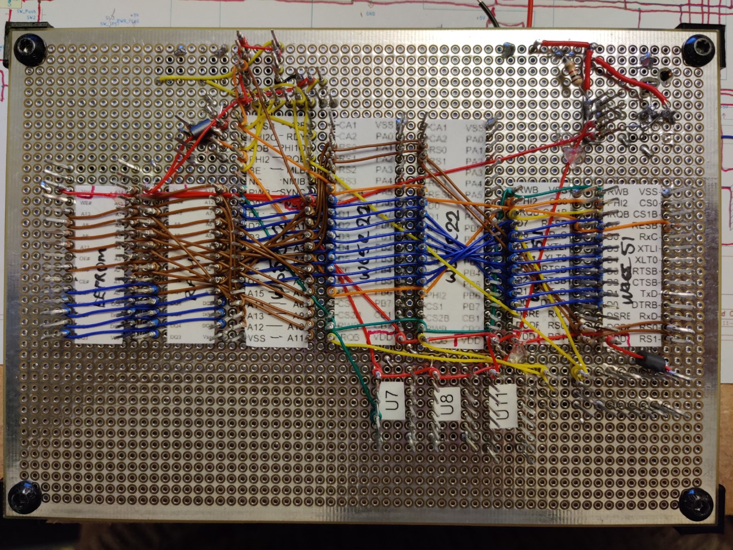

Oh dear, I feel really so guilty now. I have progressed beyond being able to implement your thoughts. DrJeffyl and floobydust, thank you so much for all your time though.
First I did this:
and then this:
This is where I am at the moment. I will pause to hear comments before continuing.
Posts: 3525
Re: Strange memory write problems
You're welcome. And I can easily understand your eagerness to move forward. Moreover, since this thread began you've been subjected to an absolute barrage of information and opinions! It would be no wonder if you sometimes feel the urge to tune out the external noise and instead rely on your own thoughts and intuition.

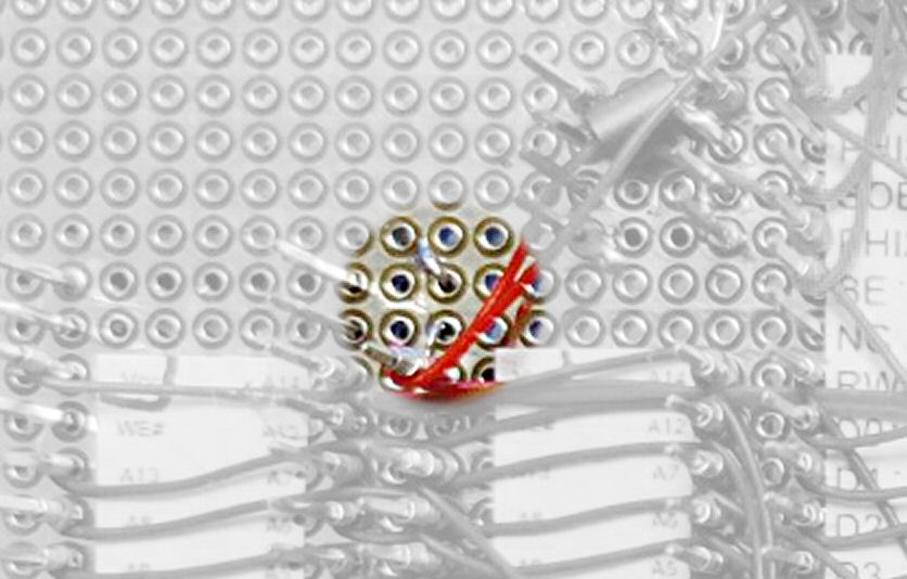

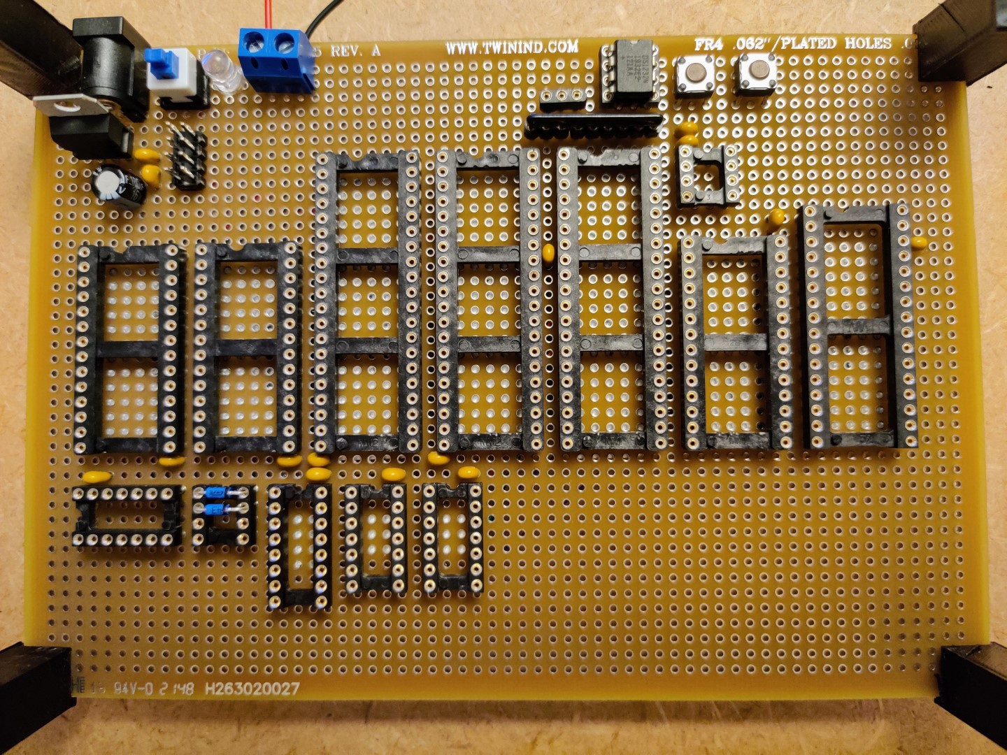

Looks good to me. I can't see all the bypass caps, but I'd say the example below is satisfactory. Myself, I might've opted for an SMD cap located on the wiring side (not the component side), but that's a small-ish distinction.
Just one minor suggestion. As you continue to add wiring, it's maybe a good idea to stop occasionally and check for continuity between ground and +5... and of course there should be none. But if you've accidentally created a short somewhere then it's better to be aware of that sooner rather than later.

... And I can easily understand your eagerness to move forward. Moreover, since this thread began you've been subjected to an absolute barrage of information and opinions! It would be no wonder if you sometimes feel the urge to tune out the external noise and instead rely on your own thoughts and intuition.
Hello Jeff. You are very perceptive. There has been a lot to think about and you are right about all the input from everyone (and for which I remain very, very grateful). I decided I could battle on and keep trying to troubleshoot it or just start again.The problem has been that each area - components working - wiring - glue logic - timings etc - each area has worked at some point so "there is nothing wrong", yet plainly there is.
I'm not quite sure where I will be if it still has the same problems - but we will cross that bridge when we come to it :-)
Ahh, yes, the caps. Here's the other side (black things are the legs temporarily on the top side while I work on the bottom):
I never even contemplated putting SMD components on perfboard but I see now that you can. Why though choose SMD over the through hole ones? Are they better? I guess no leads??
Which "leads" me on to the next question (sorry about that)... What value? Arrrggh!! I used 10nF. Some say 100nF. I mentally tossed a coin. I might put both on the CPU chip. Good idea?? I put both (and a 100 uF) on the voltage regulator.
Some notes on the pic
1. the edge connector is just a short cut round the voltage regulator straight to my new bench power supply. It wont be used when its all finished.
2. I had a DS1232 MicroMonitor knocking about so I put it on in place of the DS1813 - which I used for the NMI (at someone here's suggestion). I have defeated the watchdog function temporarily by wiring that to A0 - although, thinksing about it as I type - it does add another load to that address line and we are supposed to be giving this thing every chance of working so maybe not such a good idea. Never mind, I can always remove it from circuit and just use a pushbutton and capacitor!
3. I haven't put the socket for pull-ups in. I can add that later if I have problems.
Oh, I promise you... test, test, test, test... after every few connections!!
