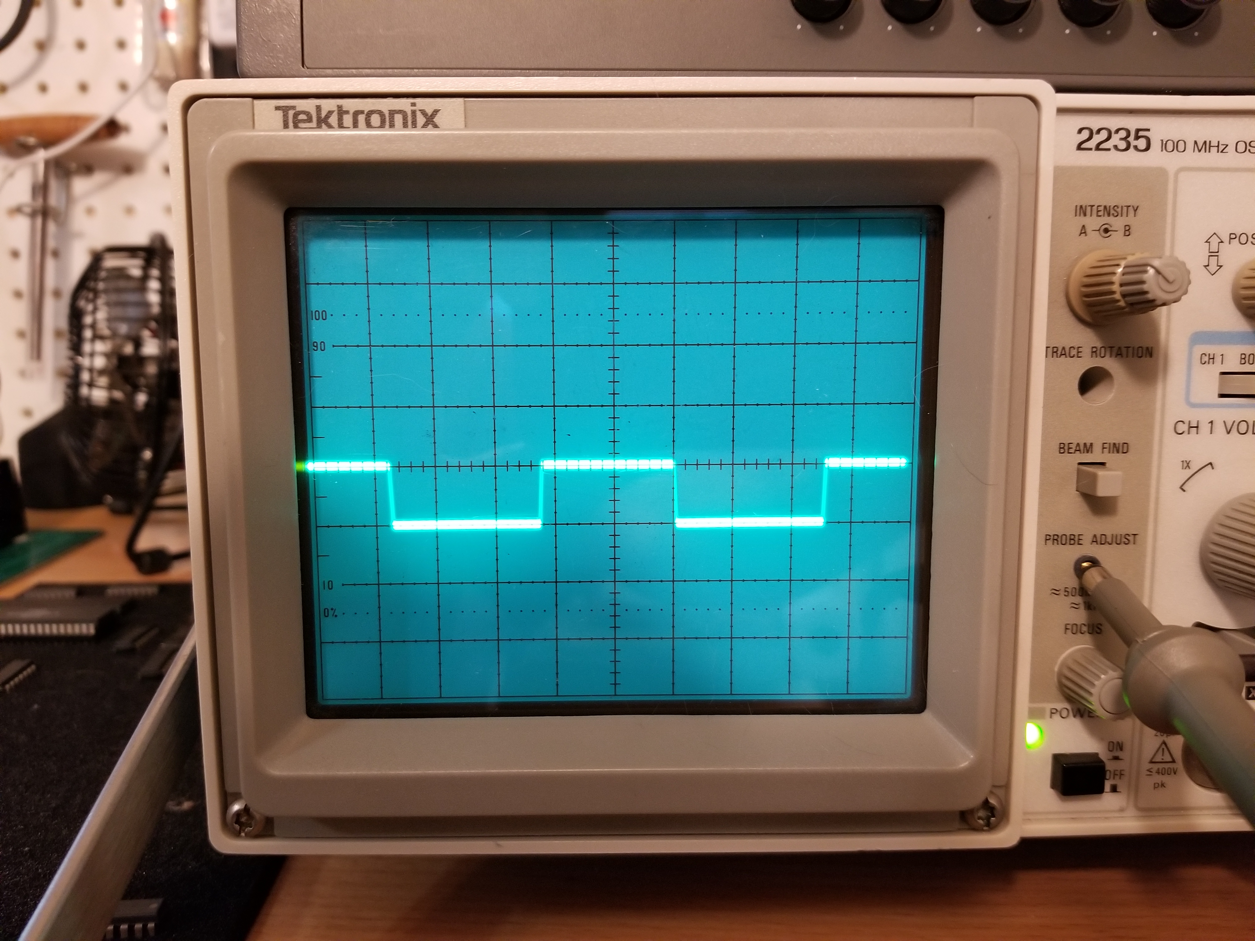

Here is my oscilloscope:
It's a Tektronix 2235 analog scope. I picked it up un eBay a few weeks ago; the seller accepted my (very low) offer, I think mainly because it had no probes, and therefore they couldn't test it. It has an "Appalachian State University" badge on it, so I guess it's school surplus. It's in great shape! Aside from some minor scuffing on the case the only damage is that the clear scale for channel 1 is half missing. The remaining half fell off the knob the first time I turned it. That's no big deal, though, because I can use the channel 2 scale for reference.

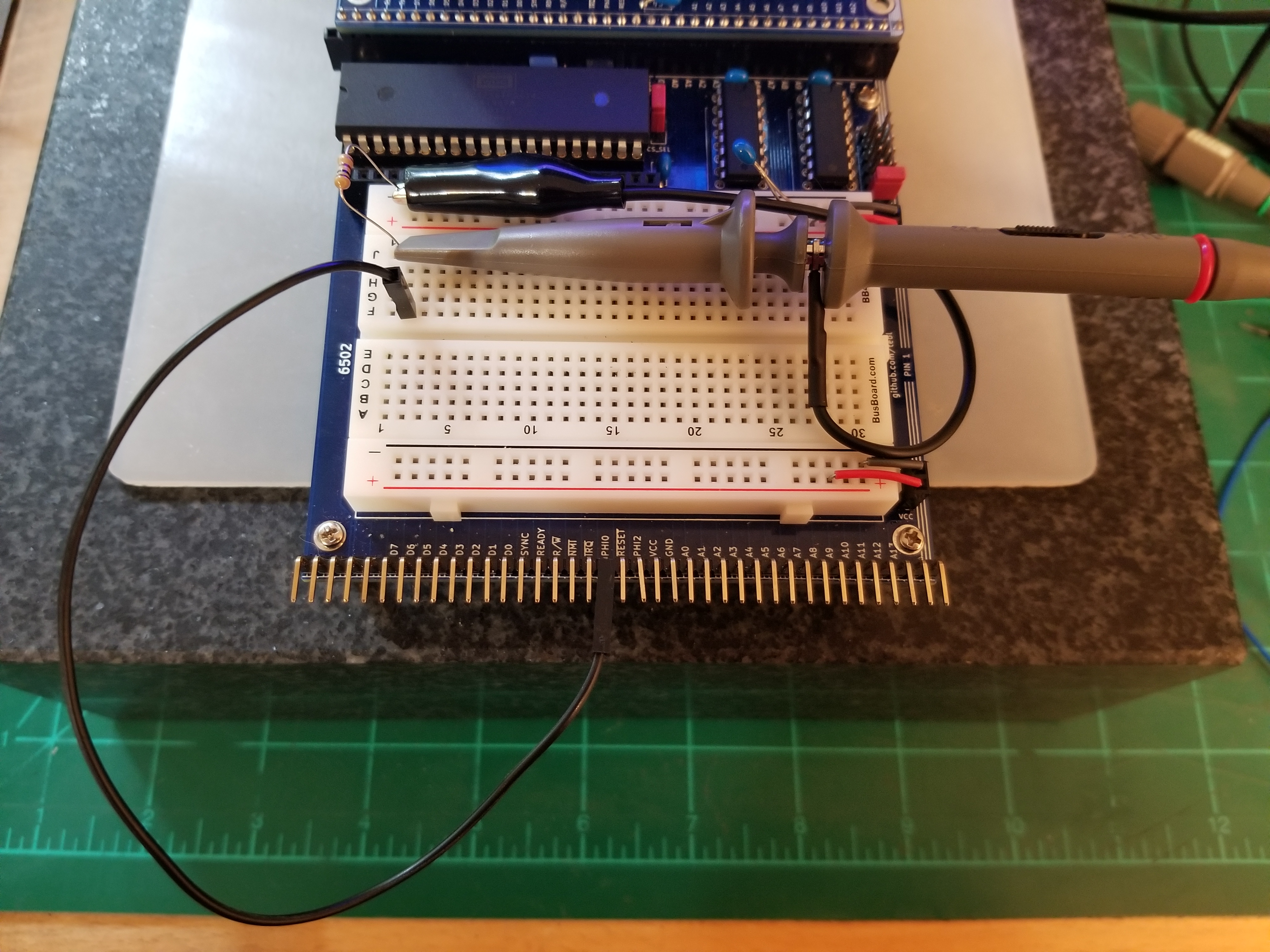

The RC Project Platform board I've mentioned before has all the bus signals broken out into a header. Probing the clock lines directly makes Blue April crashy. Since I was just recently reading about cross talk, ground bounce, high frequency noise, reflection, and bus termination, this did not surprise me. Blue April's bus is about 3 times as long as it was designed to be, and it's not terminated. I believe 75 ohms is the correct termination, but I don't have any 75 ohm resistors. So, in the electronics hobbyist spirit of "close enough is good enough" and "let's try it and see what happens," I put some 100 ohm resistors on the breadboard and connected the clock lines to them. This seemed to work OK.

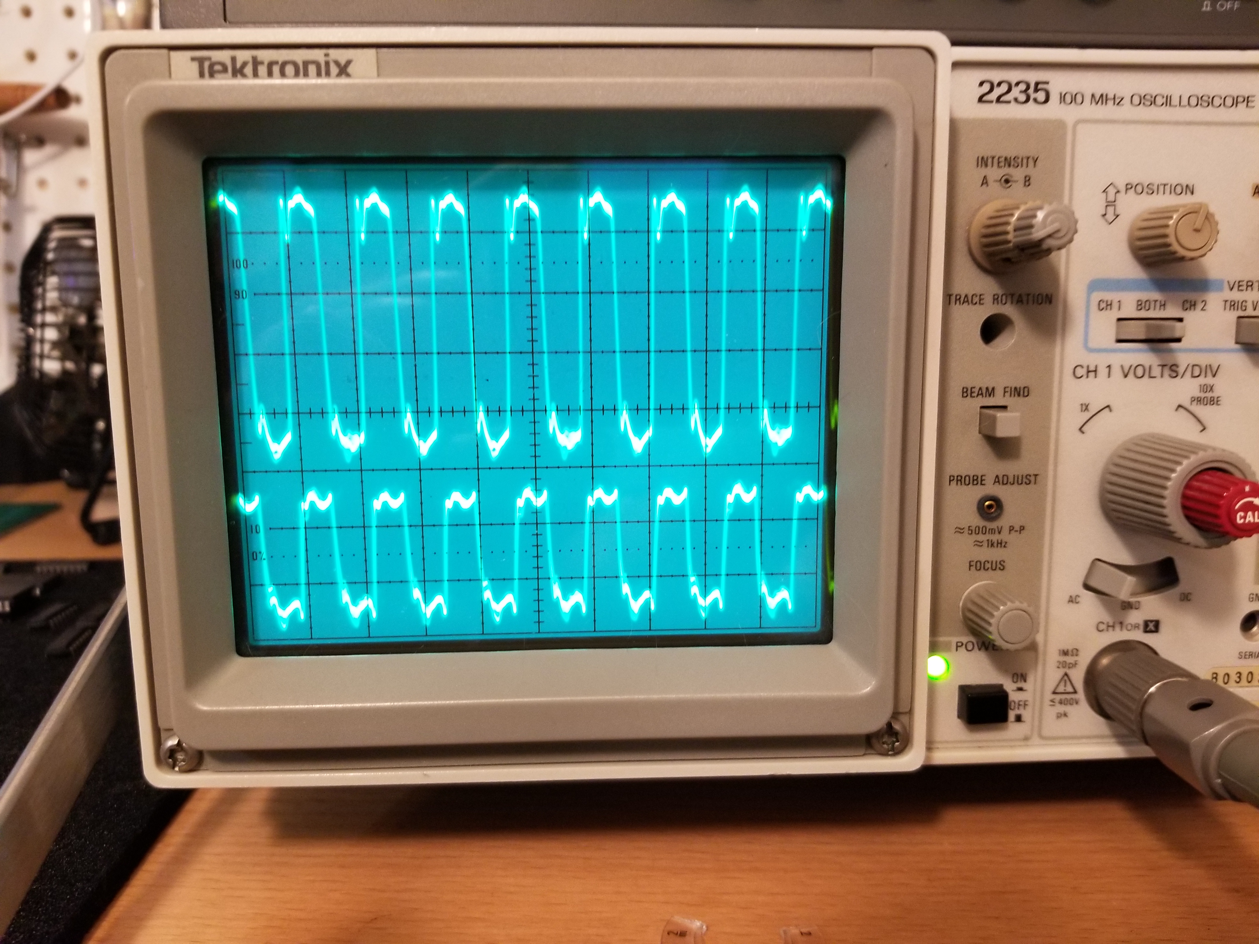

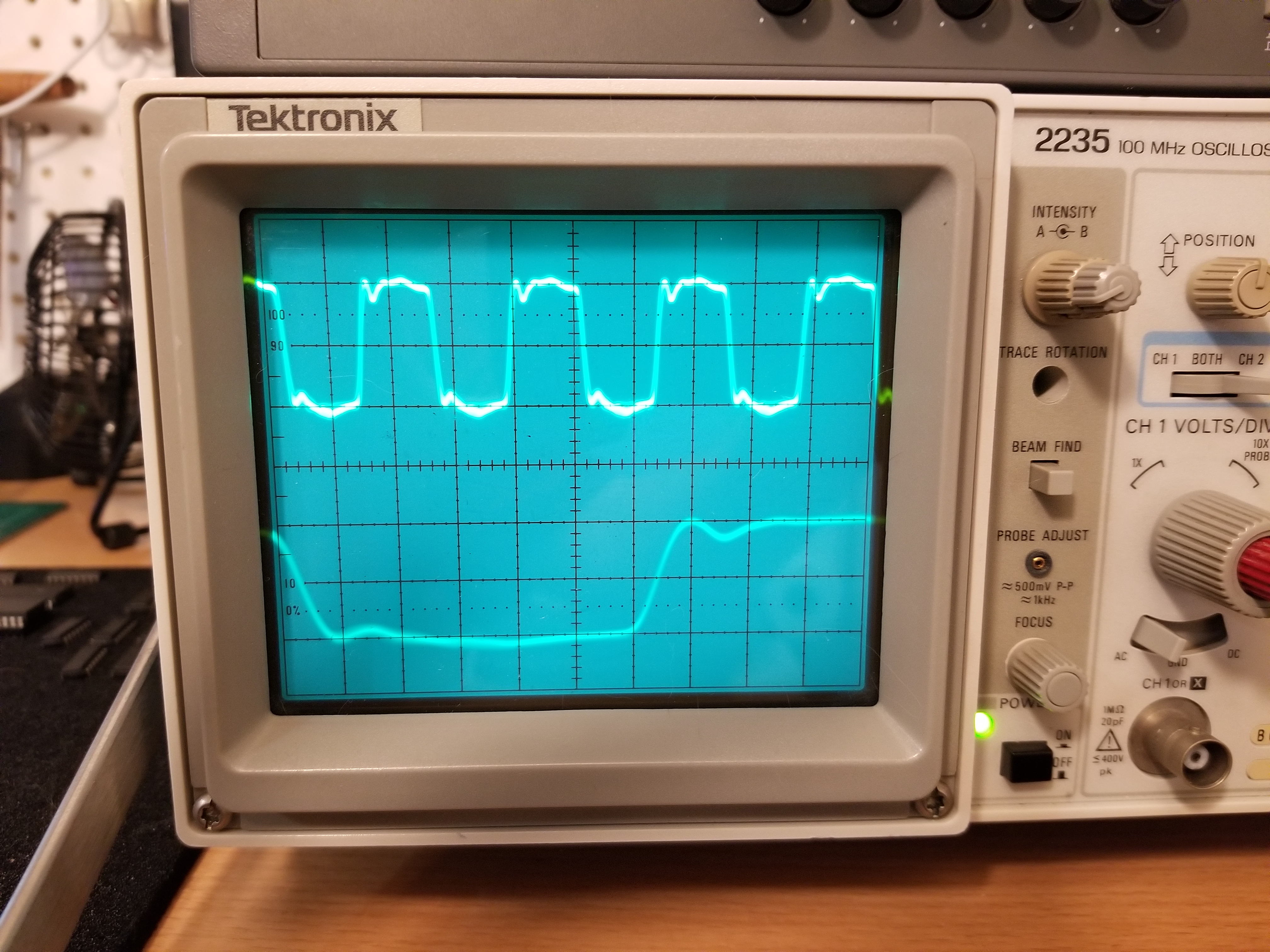

Here are the two clock signals stacked up for comparison, Phi 0 over Phi 2:
I believe that's 1 volt per division, and the field of view is 1 microsecond.

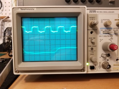

And here's Phi 0 with the B sweep zoomed in on the rising edge:
And here's Phi 2 with the same settings:
There are probably some things I can do to get a cleaner signal; I don't (yet!) have those nifty ground springs, for example.

What are you using for probes?
I got some inexpensive Hantek ones to get started with. I doubt they will last for decades the way the OEM ones do, but the specs were right and they got good reviews. I tracked down the recommended replacement for the missing OEM probes, and they cost over twice as much as I paid for the whole unit! They will be for a future "rainy day" upgrade. :)

I'm not familiar with Hantek probes. Are they compensated? Also, are you taking your readings with the probes in the ×10 setting?
I practiced with both settings; the pictures of my clock signals above are using 10x. At 1x the waveform looks like a sawtooth, I gather because it's missing too many high-frequency modes. Here are the specs for the probes:

The probe specs seem to be okay. While I wouldn't say they aren't affecting what you are observing, it would seem that with the specs you quoted, the effect on signal quality should be small. Can you please post a picture of what the calibration signal looks like?

Sure! The calibration signal is 500mV P-P at 1kHz. Here's .5 V/division by .2 ms in 10x mode:

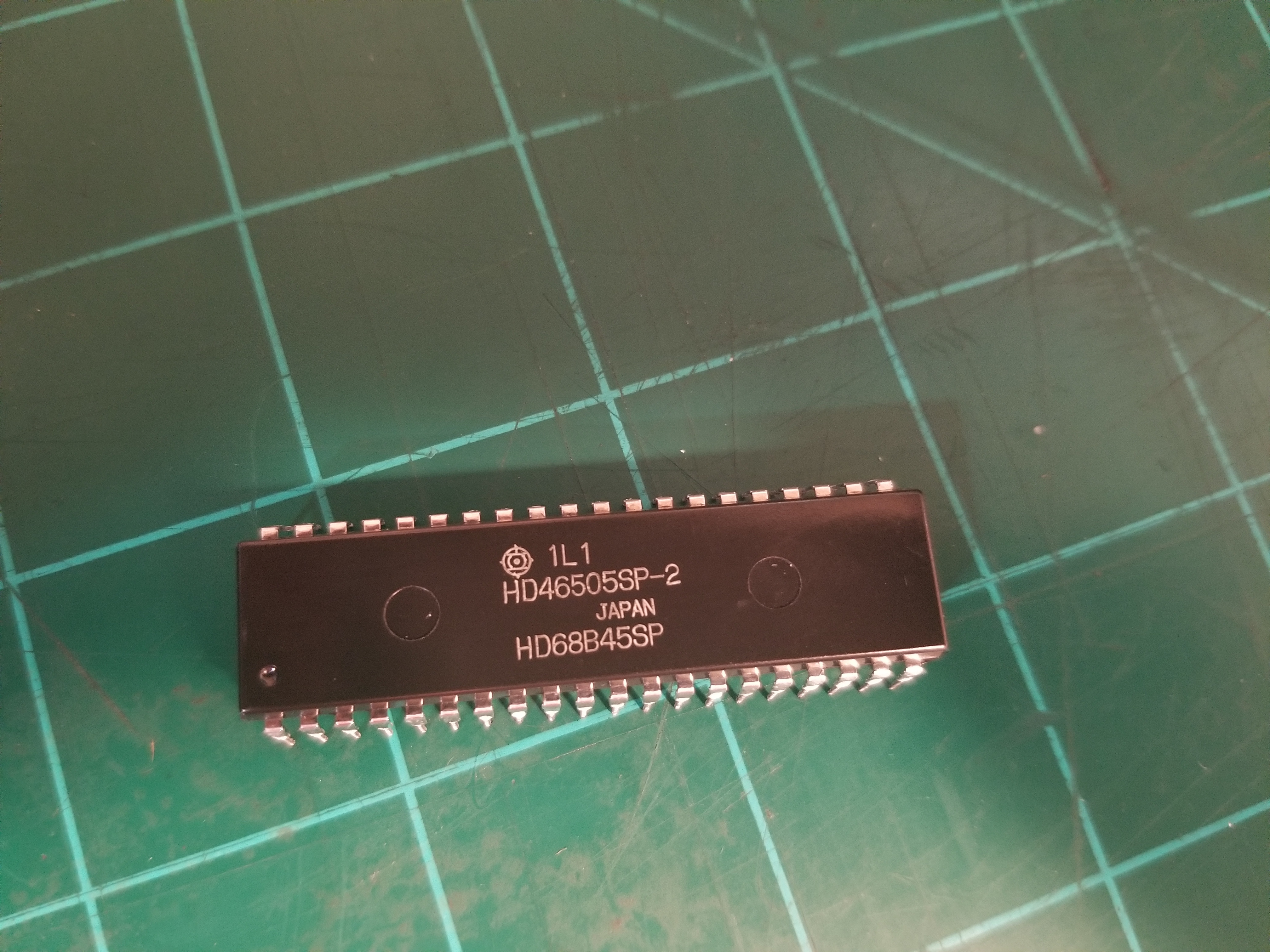

It's time to start working on something I've wanted for a while now, and that is: honest to goodness old school CRT video!
A while back I bought several of these Hitachi CRT controllers on eBay:
They are used pulls from working systems. The legs are a little grody, so I'll use a machine-pin IC socket even during breadboarding to avoid putting too much stress on them. These are pretty close copies of the Motorola MC6845 CRTC, with a few enhanced features. One of those enhanced features is that it can take up to a 3.7Mhz character clock, which means it's one of the few old-school CRTCs that can produce VGA timings - which I'm sure Chad will be excited to hear! :lol:

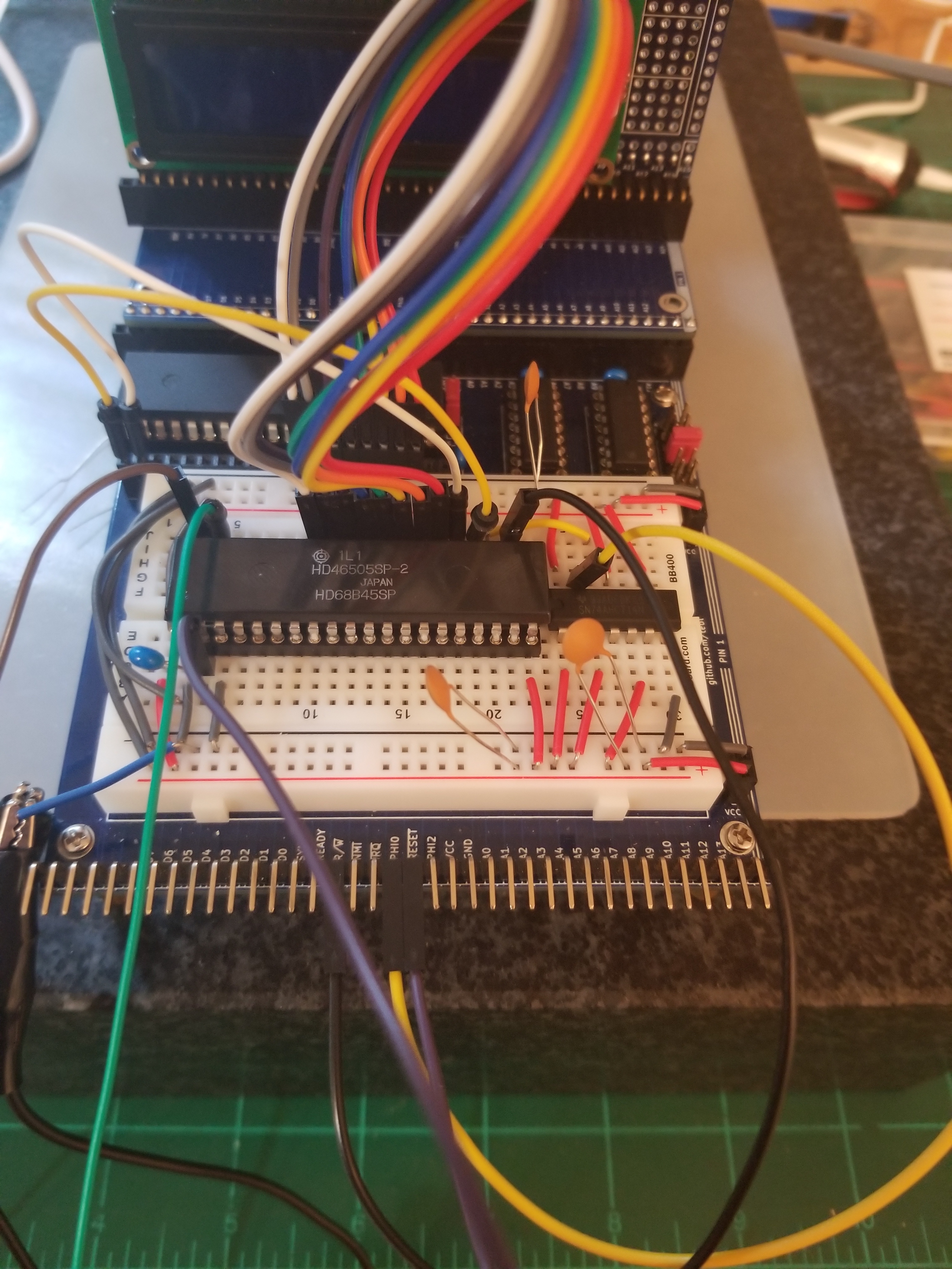

Then, in the spirit of Ben Eater, throwing it on the RC Project Platform, and connecting up some pins just to see if we can get it to do *something!*
First up, GND (with suitable bypass cap) and VCC are pins 1 and 20, respectively. That's easy enough. Then pin 3 is for light pen support. I don't have a light pen and, at least for now, have no plans to ever get one, so pin 3 can be tied low. Next up on the list of low-hanging fruit, pins 2 and 22 are the standard Motorola signals RESB and R/WB, so they can connect directly to the bus. Pin 23 is named `E` (Enable), but it is in fact the system clock input. Just like the stock 6845, the design of this chip has in mind that E will be connected to the Phi1 inverted clock output from the CPU for interleaved bus access. However, the RC6502 doesn't put Phi1 on the bus, and, anyway, I'd prefer to use the much nicer Phi0 clock coming off of the clock module. Fortunately I have plenty of spare 74AHCT14s leftover from the keyboard circuit, so I'll run Phi0 through that to get a nice inverted clock.
For address decoding, the HD6845 has pin 24 (RS) and 25 (CSB). RS is supposed to be tied to A0; taking it high gives you access to whatever register is currently selected by the Address Register. Taking it low gives you access to the Address Register itself. This means programming the HD6845's internal registers is, conceptually, a two step process, involving two consecutive memory locations. Pins 26 through 33 are the data pins, intended to be connected directly to the system data bus. Since the Project Platform doesn't have a huge amount of space, but it does have a spare VIA, and since I'm just trying to get to know the HD6845 a little bit, I'm not going to mess with address decoding; instead, the data pins connect to Port B, and CSB and RS will go to Port A. This makes writing to the CRTC a little more involved, but since that mostly only happens at system initialization, and since this is only temporary, it's no big deal. That pretty much completes the installation of the CRTC. It has a lot of memory address and raster address pins for the character generator, but since I don't have one of those yet, I'm not going to worry about them for now. There are three pins of interest left, though. Pin 21 is `CLK.` This is actually the input for the character clock. Theoretically this would be generated from the dot clock in the character generator, or supplied by an oscillator, but for now I'm just going to tie it to the 2MHz inverted system clock. Finally, pins 39 and 40 are HSYNC and VSYNC, respectively. I will tie them to my oscilloscope. :)
Here's everything hooked up:
Getting it to do something is now simply a matter of programming some sane values into its 18 control registers. The HD6845 thinks of everything in terms of characters rather than dots or clocks, so setting up the registers with something approximately normal is not too tricky; I went with 100 characters per line, 80 characters visible, 26 lines per frame, 24 lines visible. There are a couple of extra registers that let you tweak exactly where the sync pulses fall within the blanking periods, which I'm sure will be useful for whenever I eventually actually hook it up to a CRT. For now, I just want to make sure the chip is working, and programmable through the VIA. So I fired it up, and after twiddling with with my oscilloscope and laboriously counting 80+ clock pulses, I did indeed find an HSYNC pulse right where it was supposed to be. 8)

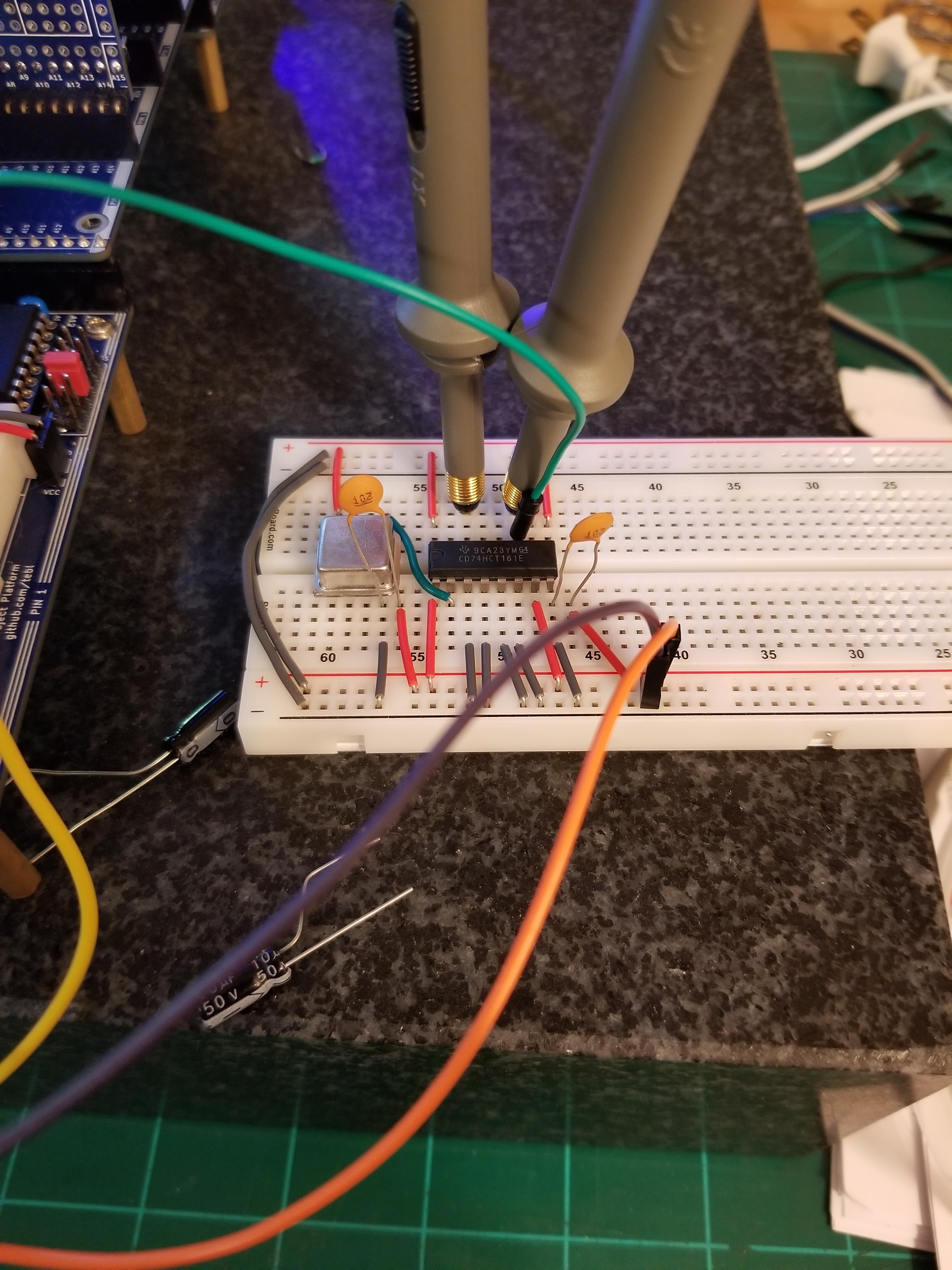

My Mouser order was delivered today, so I added the clock to my CRTC circuit. 13.5 MHz oscillators are Really Expensive (TM) for some reason, so I'm using a 27MHz one. It's hooked up to an 'AHCT161 to get /2, /4, /8, and /16 outputs. I'm using /2 (13.5MHz) as my NTSC dot clock, and /16 (which is 1/8th of /2) for my character clock - in other words, characters are 8 dots wide.
The clocks look pretty bouncy. I added a bunch of decoupling caps, some 10uF smoothing caps, and some ground return wires, but nothing really helped. I'm guessing it's just due to being on breadboards.

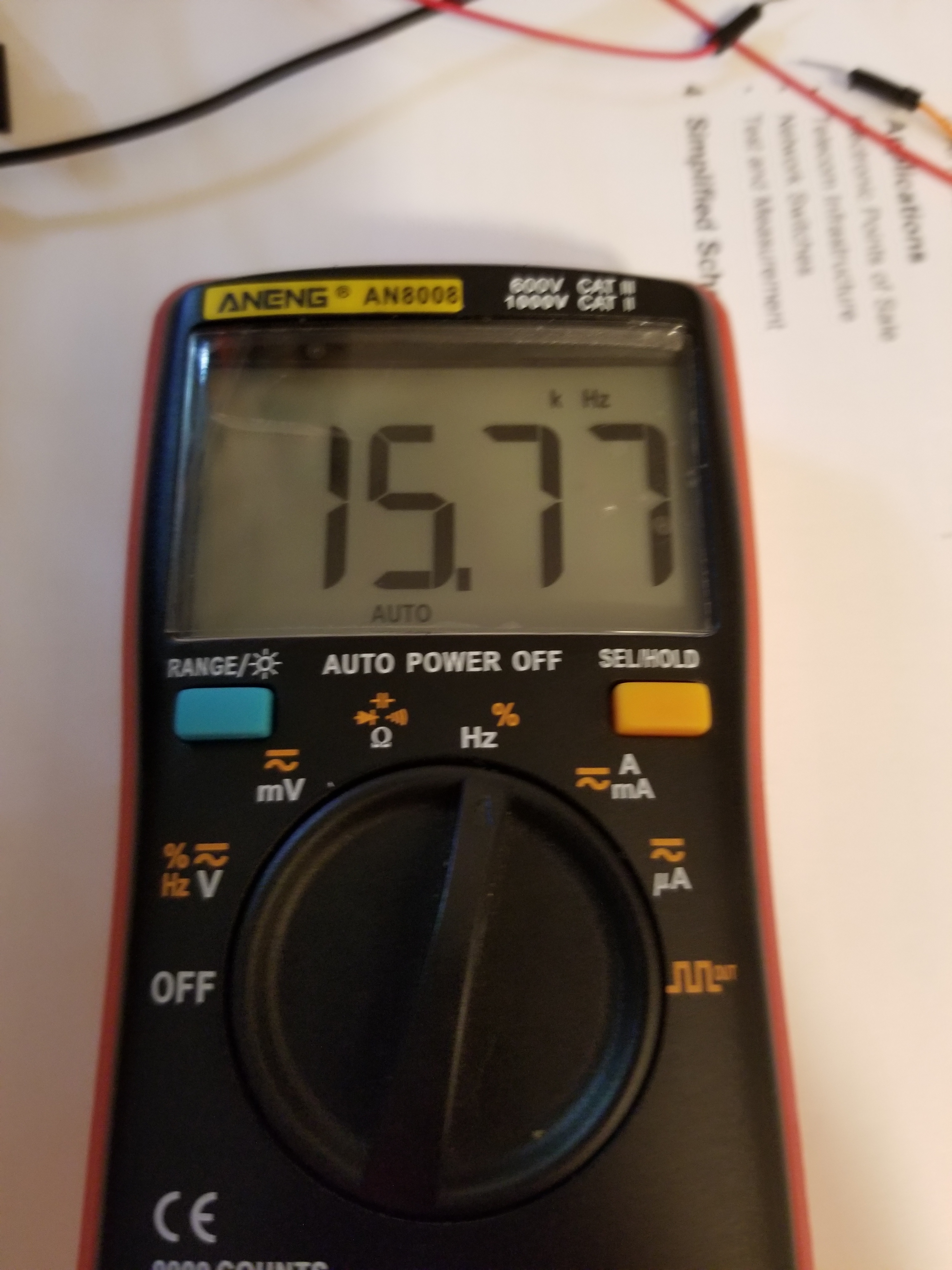

Then I did a little math (actually, I used this handy calculator: https://mrboot.de/mc6845.php, but what it spat out was pretty close to what I came up with by hand) and reprogrammed the CRTC registers. HSYNC and VSYNC are now looking pretty good!
