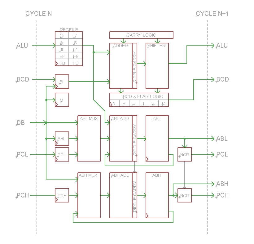

Here's a simplified schematic block diagram of the core datapath.
The blocks with the little '>' in the corner are registers. The output data on the right lines up with the input data on the left in the next cycle, except for the ABL/ABH on the right go into the memory, and then the DB on the left comes out.
