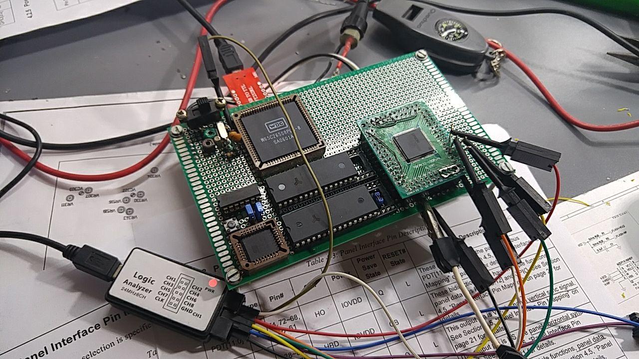

There are actually some forward movements with this.
As a workaround, because my focus is now in what I'm telling later, what I did was split the initialization routines in two parts: first one in $8000 and the second one, that should be done after a delay of 2500 microseconds, in $8100.
So I now call the $8000 code, and in the time I type the call to the $8100 code, those 2500 microseconds are already gone. It's a crude workaround, but that's what I'm able to do by now.

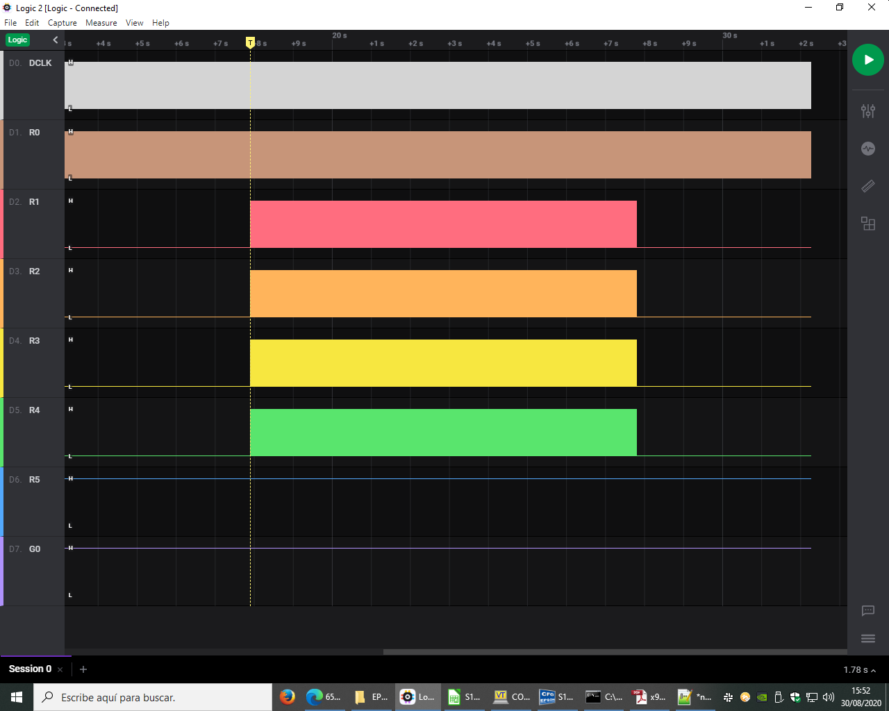

What I've been able to do is configuring the chip, and turn the panel interface (I still doesn't have the right connector for it) on and off. The logic analyzer show that behaviour:
What you are seeing is (forget the labels in every line, as shown in the screenshot):
LINE#  DESCRIPTION
1      The FCLKOB pin: the clock tick as it's being fed into the '265s.
2      The PHI2 pin: the clock tick that the '265s feeds to the rest of the system.
3      The PCLK pin: the clock tick that the EPSON chip feeds to the LCD panel.
4      The DE pin: the "display enable" that tells the LCD where to start drawing pixels.
5      The HS pin: the horizontal sync pulse.
6      The VS pin: the vertical sync pulse.
By manually modyfing a register, I can enable and disable those signals at will, and that's what you see in the graphic: it begins with the panel "off", then I turn it "on" and then I turn it back "off".
The setup for this capture.

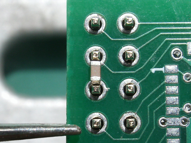

tokafondo wrote:
Maybe it' related to power lines noise or the capacitors I'm using or something.
tokafondo wrote:
I think that what's happening is that the LUT tables have its own format, so writing to certain areas is not allowed at all, and my mistake was to try to write to those areas as if they were just "RAM".
Well, I wish you luck, and hope for the best. Compared with earlier in the thread your construction techniques have improved a great deal, and maybe the caps and power arrangements are now Good Enough. But I'm a little doubtful, TBH. Given how time-consuming it can be to troubleshoot a flaky problem, I myself would do some further tidying up before proceeding.
At the very least, I'd recommend replacing the audio caps with monolithic ceramic or multilayer ceramic as suggested.
Another significant improvement is to shorten the connections between the caps and the video chip... and, to that end, relocating the cap can help a lot. As shown in the photo, SMD caps are small enough that they can mount between the pins of your breakout board. This brings them closer to the chip, and also frees up space on the wiring side of the main board.
It's very nice to see this project coming along, BTW! :)

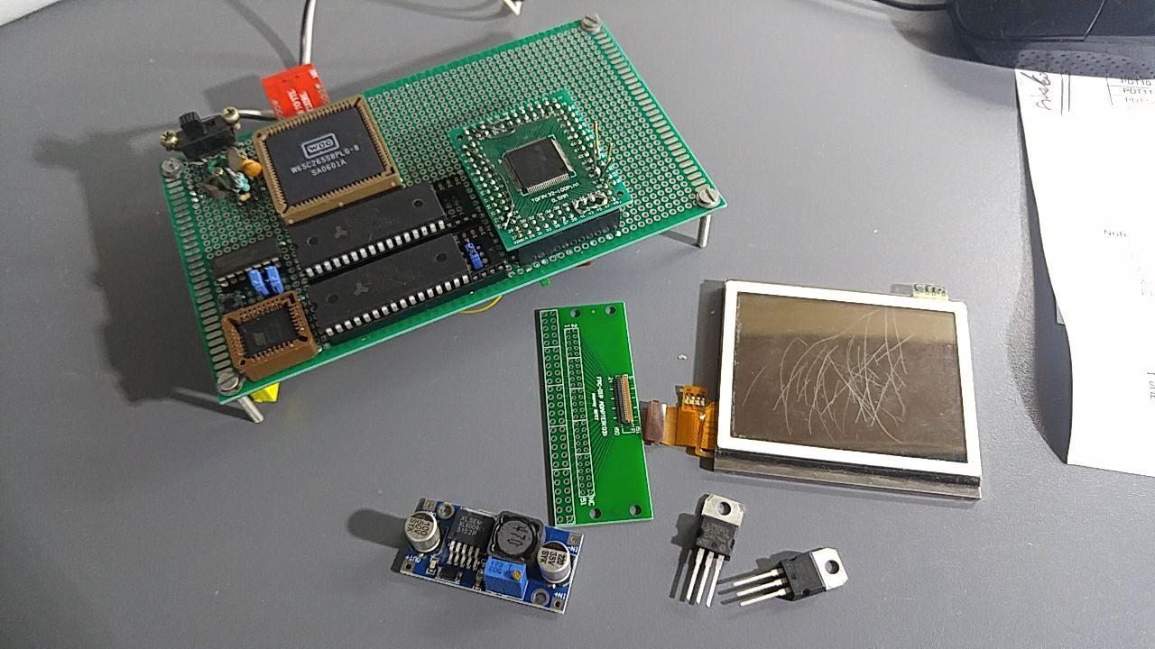

I think I have the parts needed to get my SBC to the next level. That LCD screen in the right comes from a Nintendo DS lite. What you see scratched is the touch screen. No worries by now, as I don't plan to have it working, but it could be fun, anyway.

So what I'm trying is to get is the '265s boot from the external EEPROM.
The usual way to do that is to burn the code you want to run in the EEPROM, and then put the "WDC" string in certain memory locations, so the ROM jumps to it and continue running from there.
But there is also another way, and it is bringing high the /BE line about 200ns after the /RESET line:
When BE goes high after RESB goes high the BCR sets up the W65C265S for emulation. Port 0 and 1 are the address outputs, Port 2 is the data I/O bus and RUN is the multiplexed RUN function.
That means, as I understand, that you can make the '265s boot like a normal 65816 does, in 6502 emulation mode. I don't know if the owners of a '265SXB can mod that board to make this happen, by tinkering with the /BE line in pin 46 of X265_BUS connector.
I'm testing in a protoboard with ways to create that 200ns delay, having success there. I have to repeat that success in my board.
And then I have to copy the Mensch ROM Monitor in my EEPROM and get my board to boot with that delay.
I think that what is achieved this way is to get the '265s run only with external memory. The internal 576 bytes of RAM and the 8K of ROM wouldn't be used at all. That would allow to work with a linear 32K RAM + 32K ROM of memory from the start, instead of messing around with the chip select lines to disable all the internal memory, a thing that's what usually done when booted from the Mensch Monitor.
I'm looking at the W65c134SXB board right now - it has a similar feature - ie. take BE low, then bring BE high some time after Reset goes high.
The board uses a simple RC network for the reset signal, so accurately timing it might be tricky, however my guess from reading the data sheet is that more likely to be a number of cycles from Reset going high rather than a fixed time and it looks like that might be 4 cycles (possibly 5) of the startup clock (which is off the 32768Hz xtal on the '134 SXB board)
So it may be possible to use a counter to gate BE high triggered by the Reset going high.
However, I have discounted this approach and will use the 'WDC' signature method - on the '134SXB it enables EEPROM from $8000 through $EFFF, checks for the 'WDC' signature, and if found JMPs to $8004. This check happens very early in the reset cycle, then my code at $8004 can disable the top 4K and swap-in the rest of the EEPROM and carry on.
Hopefully I'll have time today to adapt the code from Andrew Jacobs link viewtopic.php?f=4&t=6339#p79164 and give it a go.
My 'gotcha' is that if I get it wrong, I don't (currently) have an adapter for the EEPROM chip for my programmers, so if I screw it up, then I'll have to wait until I can get an adapter, so plan A is not NOT set the 'WDC' signature bytes and just start my code manually by typing the command at the ROM prompt.
BitWise
