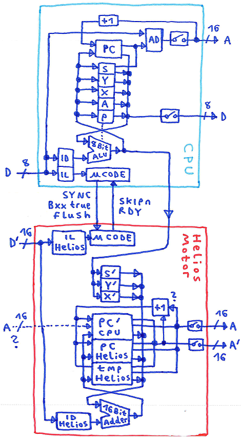

So I had started this way:
If the CPU would only do data calculations, it would have a higher bus bandwidth,
to compensate for this the Helios Motor would need a 16 Bit data bus (plus interleaved memory):
for being able to fetch 16 Bit pointers from program memory, zero page and stack.
A few things in the block diagram are not worked out well,
mainly because they don't need to be worked out well now. :lol:
Just watch out for question marks in the block diagram.
In case of JMP\JSR and Bxx taken, the 16 Bit incrementer in the CPU would need to be able to read an address from the address bus.
Considering the bus capacitances, this would affect the reliability of the design pretty much, but it's just a Gedankenexperiment anyhow.
//Physicist Schrödinger in the PC repair shop: my PC is working and not working at all, I'm happy and very disappointed.
The Helios Motor has a 16 Bit address adder, if we do flag evaluation in the Helios Motor
it isn't related to the ALU output like in the CPU,
it's for marking/flagging/categorizing valid pre_emptive address calculation results.
The CPU needs to tell the Helios Motor:
SYNC, I'm doing the next instruction fetch.
flush, forget the pre_calculated results because I'm taking an interrupt or such.
Bxx true, my PC needs new contents.
The Helios Motor needs to tell the CPU:
RDY, wait because I'm falling behind.
SKIPn, skip soandsomuch steps of microcode.
My next thought was: what, if disconnecting the CPU from the address bus, and generating the CPU address output inside the Helios Motor instead ?
Then I remembered Jeff's KimKlone.
It would simplify things a great deal if the Helios Motor would be able to send fake instruction Bytes into the CPU.
The Helios Motor is one instruction ahead of the CPU, so if it senses a "LDA ABS",
it could fake a "LDA #" instruction to the CPU, then place the address on the address bus in the right moment when the CPU reads data.
A "STA ABS" then would result in a faked "STA Z" for the CPU.
After doing some math, it appeared to me that with a Helios concept like in the block diagram,
most instructions in the CPU would take two cycles, so we can't go past 50MIPs at 100MHz anyway.
Original 6502 architecture would be 43MIPs at 100 MHz,
and for the amount of chips required for building a Helios Motor, that's "Meh".

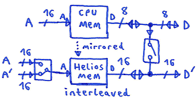

A conventional TTL CPU, plus a "hardware upgrade kit" containing a 16 Bit address adder and some additional stuff.
Modified Harvard design:
one bus system (8 Bit) for data,
one bus system (16 Bit) (interleaved memory) for instructions plus 16 Bit pointers in zero page and stack.
Something like a 6 level pipeline,
where the first half of the pipeline focuses on instruction predecoding and pre_emptive address calculations,
and the second half of the pipeline focuses on detailed instruction decoding and data calculations.
Breaking instruction decoding in two parts, address calculation and data calculation: pipelined instruction decoding that is.
Let's call it the Helios CPU. :lol:
Anyhow, when trying to do more than one instruction per machine cycle, it would be close to impossible
to get around having something in the CPU hardware that somehow resembles Harvard architecture and VLIW.

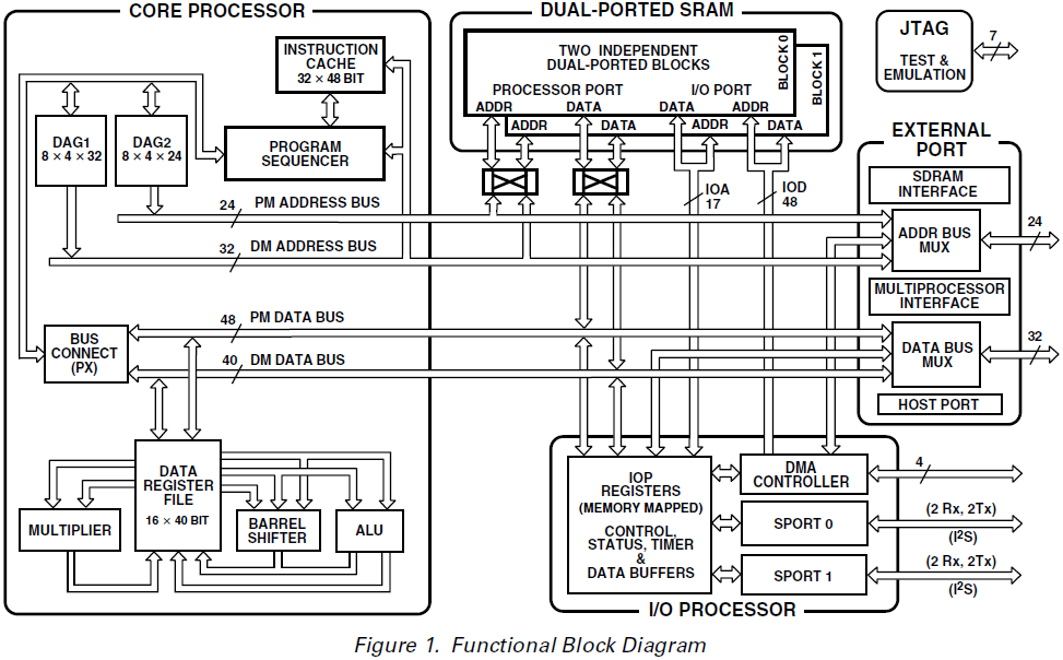

Since Harward design and VLIW went mentioned up in the thread, now for some shark tourism.
The only VLIW RISC I had tinkered with was the ADSL21065L, but it's been many years ago,
and it appears that some of my memory about the technical details isn't too correct.
ADSP21065L user's manual
ADSP21065L technical reference
ADSP21065L was designed for digital signal processing in the first place (only 32 Bit integer and 40 Bit floating point supported),
but with the help of a C compiler it also could do a good job as a "general purpose microcontroller".
//When defining a variable as char, int or long, the compiler stubbornly made it 32 Bit.
IIRC a lot of the VLIW instruction words could be conditional.
In addition to the usual set of jumps\calls and conditional branches,
there is a set of jumps\calls and conditional branches which take effect after two more instructions to prevent empty slots in the pipeline.
Two bus systems, one for instructions (48 Bit) and data (32 Bit \ 40 Bit or such).
One "data address generator" (DAG) feedig the address bus of one bus system.
Two RAM blocks on chip.
An ALU with a neat register file, and two address generators feeding the two bus systems.
//I'm leaving out a few details here, for instance that hardware multiplier.
Digital filtering seems to circle around multiplying a set of variables with a set of constants while accumulating the results,
and for this purpose the SHARC architecture makes a lot of sense.

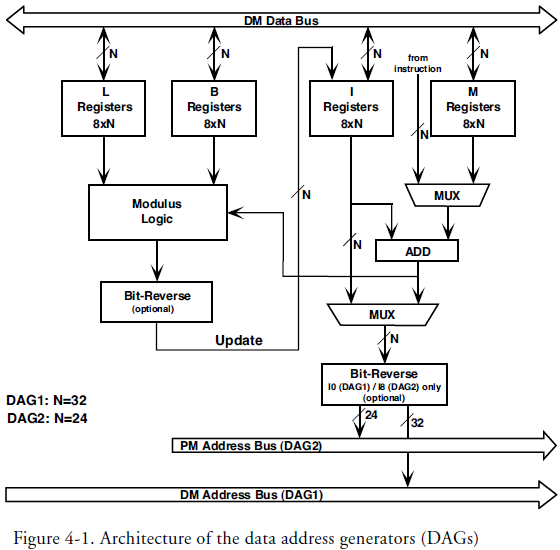

Address generators are powerful beasts.
They support Bit reversed addressing (for FFT calculations) and circular buffers anywhere in memory and at a variable size,
but since a 6502 isn't supposed to do fast FFT calculations and a 256 Bytes circular buffer simply could be implemented
by resorting to LDA ABS,X and STA ABS,X just ignore those two features (plus the related L and B registers).
Address generators are looking like this:

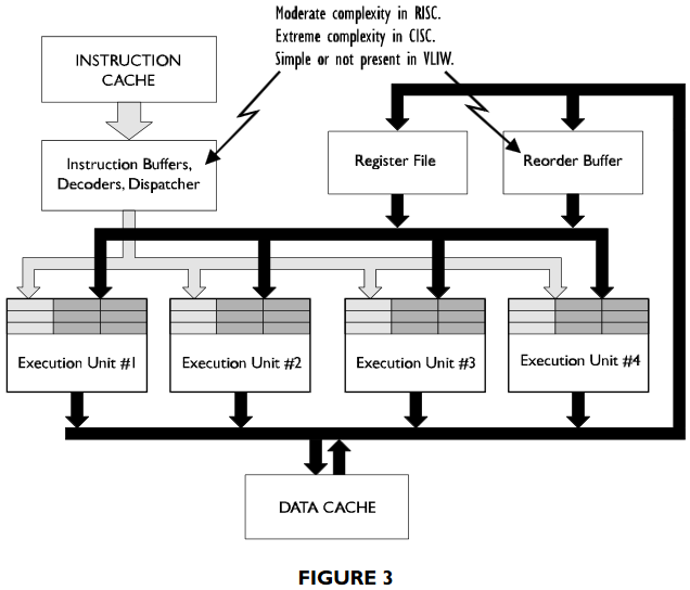

Found an old introduction from Philips Semiconductors about the basics of VLIW,
comparing CISC and RISC to VLIW.
Nice reading material.
And with that, I think the thread now contains enough material to make the VLIW concept a little bit more clear.

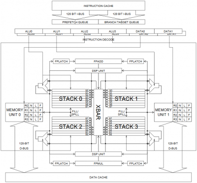

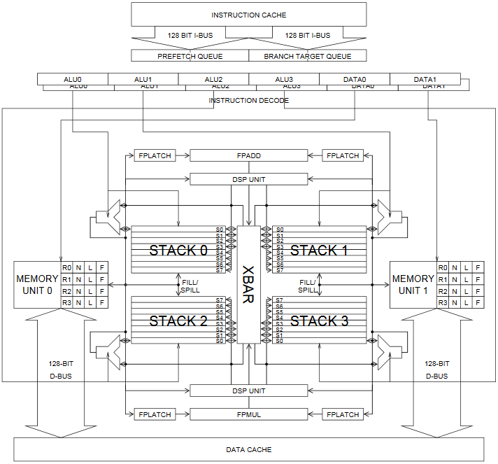

Bernd Paysan's 4stack VLIW Forth CPU, that's an interesting concept:
