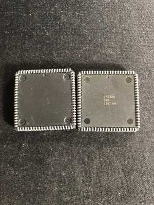

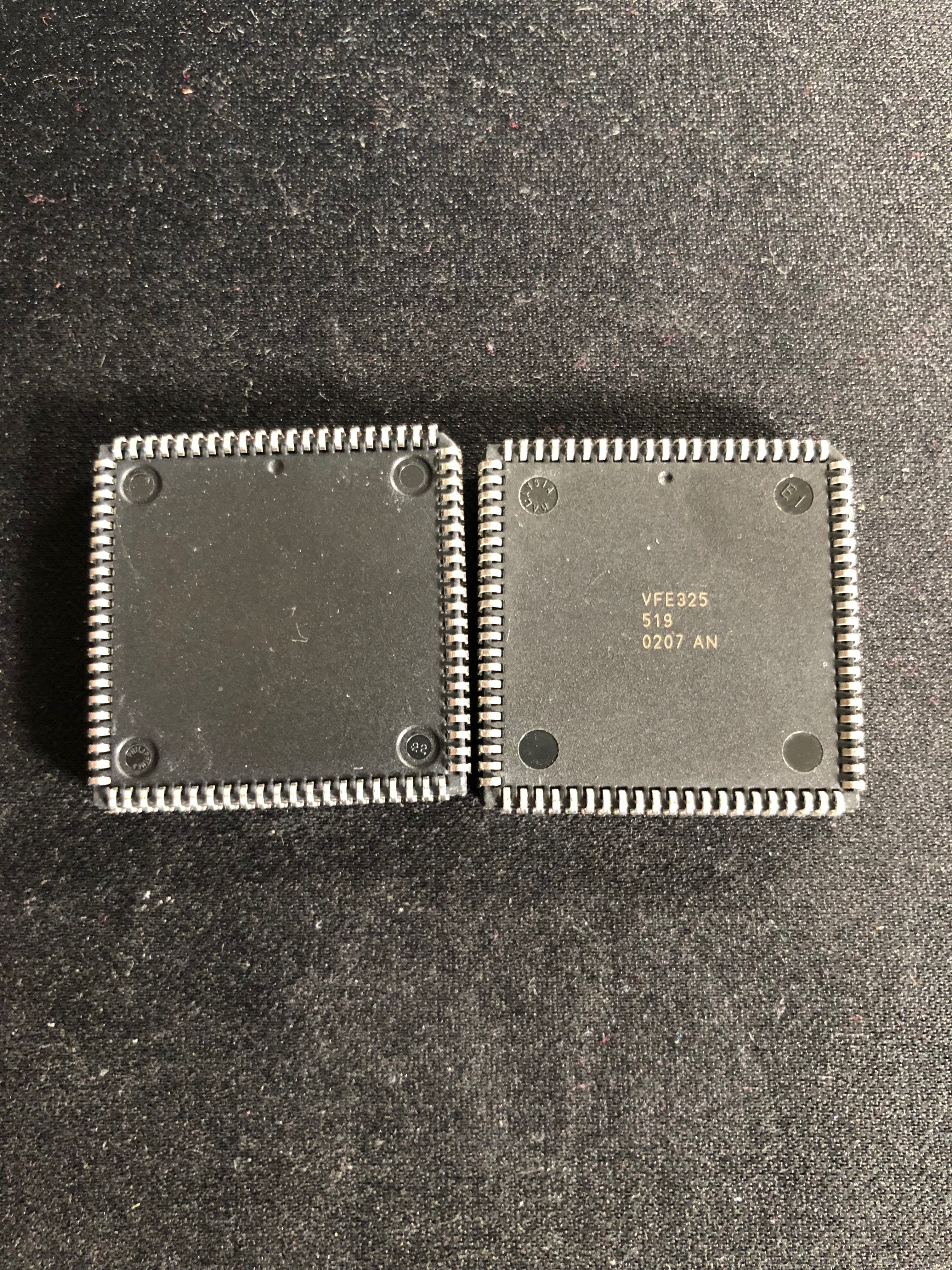

They're not 6502s but I ordered a bunch of Altera EPM7128's off ebay and none of them work at all.
Top-left is one I bought from a local reseller before they went obsolete (this one works), all the other ones are from ebay & are not detected by the programming cable. they could be pulls from some product where JTAG was disabled I guess?
Hopefully I eventually find some that work.
Mind sharing a picture from the bottom? If they're fake chips it'll be easier to tell by comparing the embossing on the bottom, which I've never seen being rewritten.

Yep, the embossing is different on the bottom. left is the working one, right is one of the ebay ones
Googling those numbers doesn't come up with anything which is a shame, I'm curious as to what they actually are
