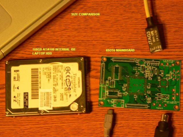

65Org16.x Dev. Board V1.0 using a Spartan 6 XC6LX9-3TQG144
ElEctric_EyE wrote:
What I plan to do is make a board that can fit 16 SDRAMs, and start off with one SDRAM (actually in addition to the one on the mainboard) and do some tests, and keep adding one until failures start occurring. This is just abit in the future though.
ElEctric_EyE
- Posts: 3260
- Joined: 02 Mar 2009
- Location: OH, USA
I've seen schematics of what I think are 50ohm termination resistors on all the Address, Bank, Clk, #CS, RAS/CAS lines, but it is a design using DDR2 SDRAM. Will continue looking into more designs before doing the layout...
Updating board layout pic tonight...
Also, just ordered the 3 remaining Mainboard IC's from Avnet.
Last edited by ElEctric_EyE on Tue Nov 22, 2011 12:46 am, edited 2 times in total.

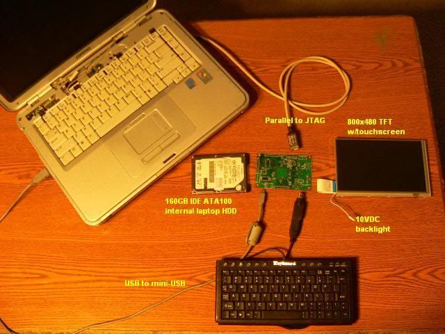

Now I can stop playing and start working...
Got all of the stuff from Digi-Key on the parts list today and all the connectors fit! Now I await my SMD tweezers, next tuesday, for soldering the 0603 parts. The 0603 parts are abit smaller than I would have preferred. These are the parts I mean to solder first as they are closest to the board and with the board clear I will have the best angles to get at them.
But I must start soldering something! Also I realized I must write down an assembly list... Also, time to step up the soldering station...
Last edited by ElEctric_EyE on Tue Nov 22, 2011 12:54 am, edited 4 times in total.
