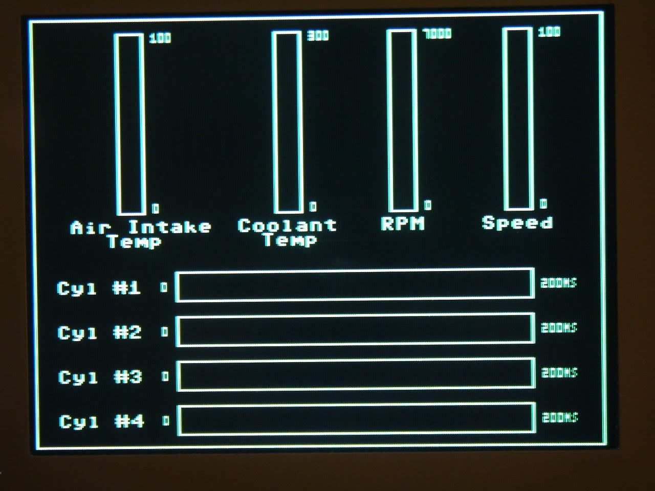

This will be the startup screen. All live data read from inputs will be put inside the boxes.
I am thinking about an alternate screen with large character's.. So you can switch between the fuel injector pulse widths (quick changing data), and the coolant temp, air temp, etc. (slow changing data). I will be looking at this datum while driving.
Notice as well, if I had a 640 H x 480 Vertical display, I could display another 4 cylinders, but all characters would be half sized...
EDIT:old image updated.
