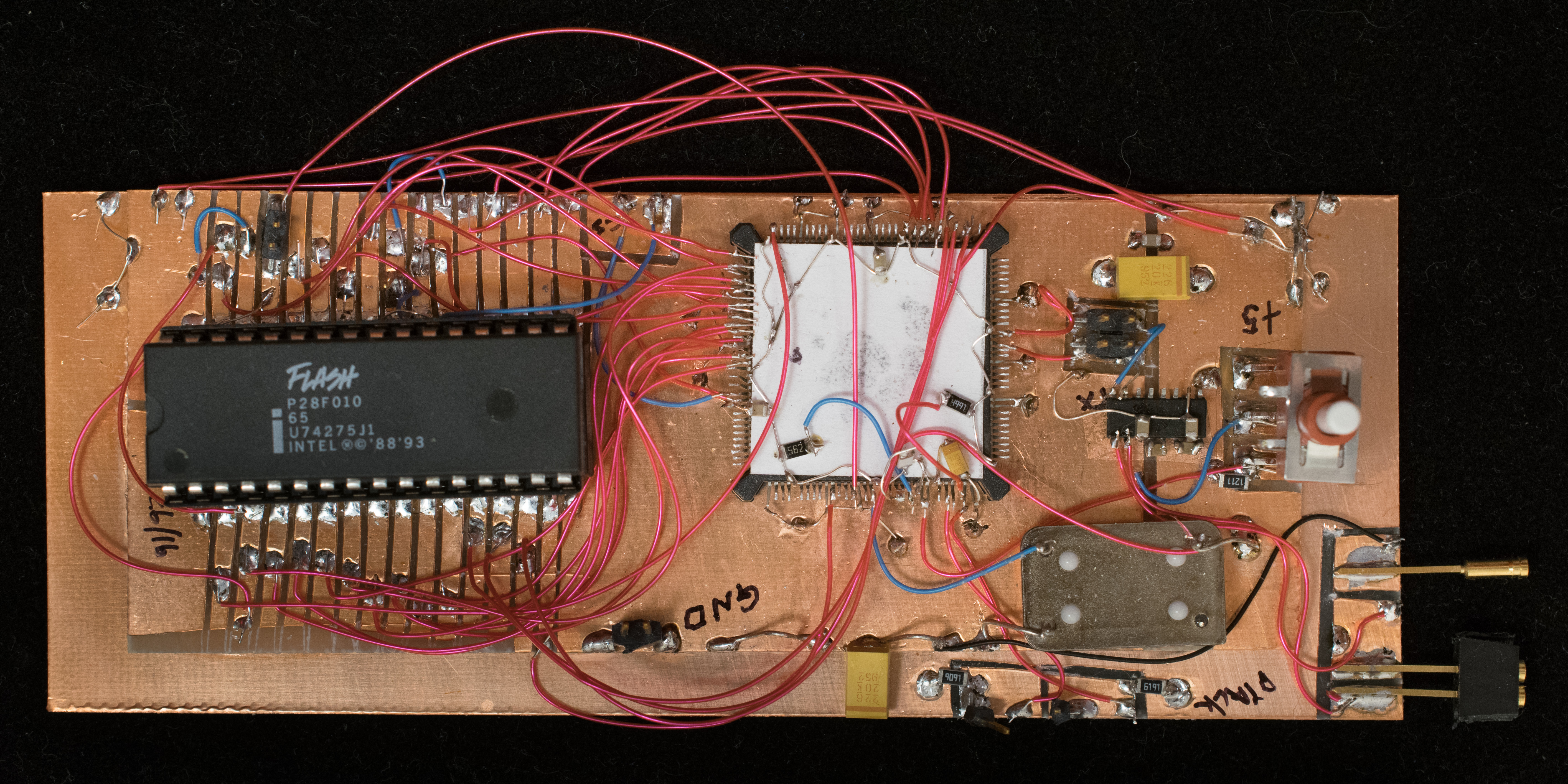

It is easier to prototype SMT by flipping the chip over like a “dead bug”. The ground leads can bend down to solder to ground foil and VCC leads can bend up to connect to power ring. The signal leads can bend at different angles to have more clearance. Photo shows a salvaged 68302 wired to DIP RAM and ROM. So it is quite possible to prototype QFP100 W65C265, but you do need more soldering practice.

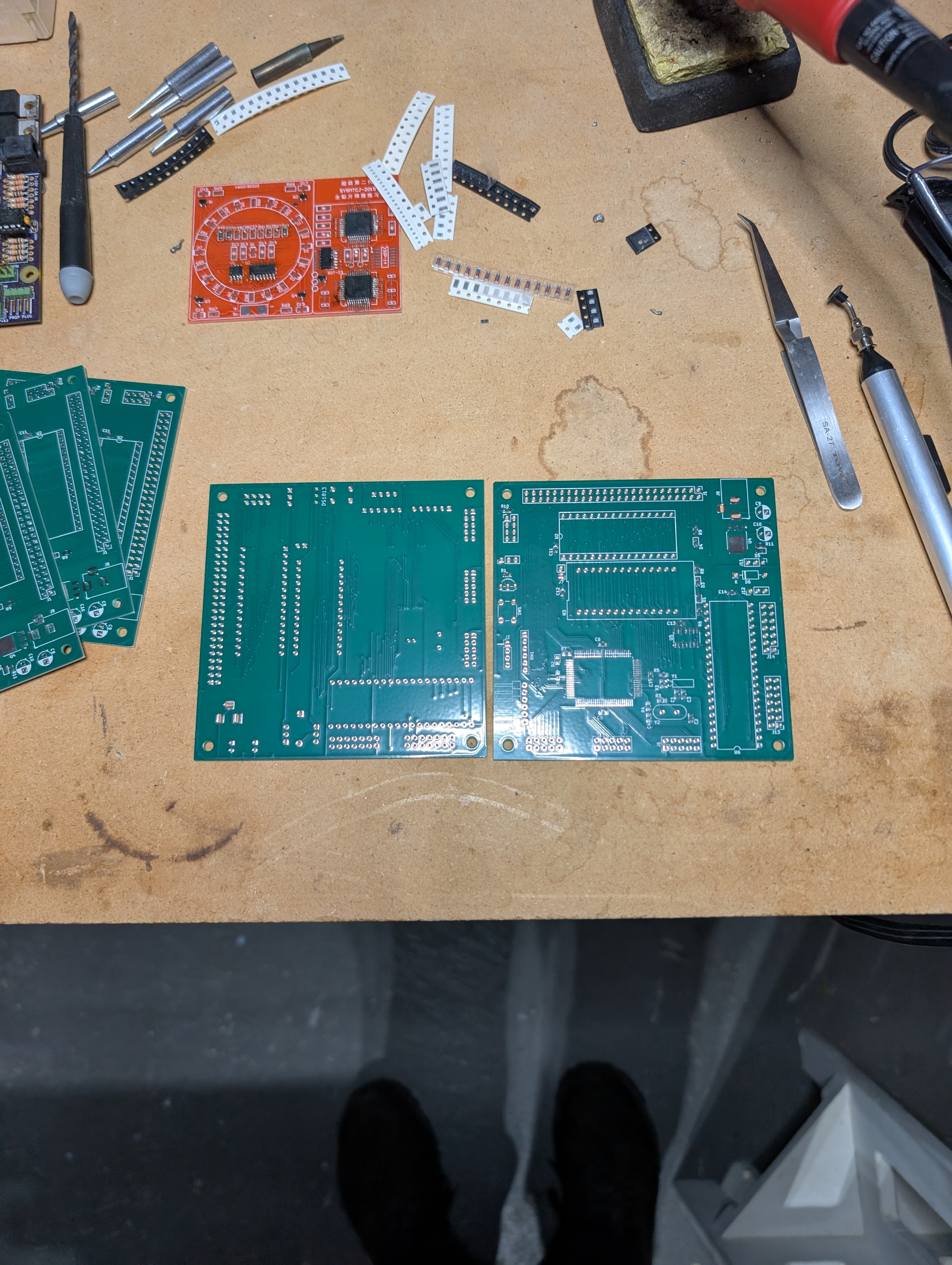

DHL just dropped off a package from PCBWay. It would have come on Friday, but I was out of town, and delayed it one business day. Overall speedy turnaround for something from halfway around the planet.
The PCBs are well packed, lots of padding, and the PCBs were vacuum packed in bubble wrap. The latter being tricky to open.
The PCB material is thick and everything looks good. Seeing it in real life makes me wish I put a bit more space between some of the SMD components. But I just need to be careful.
The Mouser order arrives on Wednesday with everything but the w65c265. I can assemble some of the board then, but finishing it will require the backorder to ship.
Above them is the SMB practice kit, which I haven't cleaned off the flux yet.
