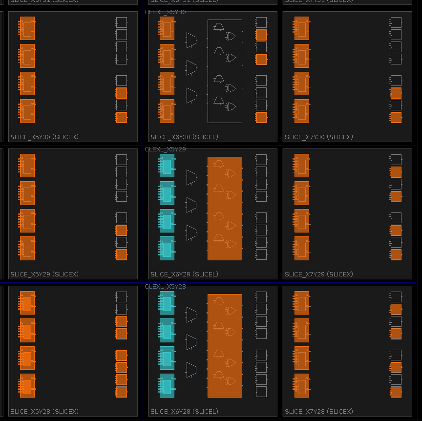

Finished converting the ALU verilog code (alu.v) into Spartan6 instances, including all ALU operations, BCD adjustment, flag updates, and condition code checks.
Tightest hand placement is possible in 3x3 square of slices, but that may not be an optimal arrangement for highest speed.
- 21 LUT5
- 19 LUT6 (8 use carry chain)
- 23 Flip-flops
Re: My new verilog 65C02 core.
Almost done with converting the control logic. A bit of manual coaxing can make it fit in 5 slices (and a ROM). There are still a few small optimizations possible, maybe worth about half a slice.
The control logic only uses 6 flops (the little squares on the right side of each slice), so it's mostly combinatorial logic.

Preliminary summary so far, with each individual module manually placed, but not yet integrated.
- ALU: 9 slices
- CTL: 5 slices
- ABL: 7 slices.
- ABH: 6 slices
- register file: 2 slices
- output mux: 2 slices
- total: 31 slices
