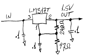

Well... I placed all the 100nf capacitors and started to put inside the square two lines of VDD: one for 1.5v and another one for 3.3v.
But once I put the voltage regulator, It had a drop of voltage to 1.2v. I already had it working in another place of the board giving 1.5v but now it dropped to 1.2v.
So I got all the low value 1W resistors I had at hand and started combinations until I had a voltage divider that gives me 1.45v. It's right for me because the chip works from about 1.36v.
So I converted 3.3v to 1.45v using a lot of 1W resistors, but... Is that the right way to do it? They say it can be done, but I don't know if it should be done this way. Will it make the chip work worse?
I burnt several capacitor plastic cases because the angle I put the solder iron tip. Inside the socket, the inner square carries 1.5v. The outer, 3.3v. And GND, outside the socket.
Should I go and buy a proper voltage regulator IC instead of this?
Yes. A resistive voltage divider's output will depend on the load. A regulator's output will be quite firm across its load range.

Is there any chip that directly gives 1.5v output, with no need of [a] regulator, like the 7805 does with 5v? I'll have to search...
The 7805 is a regulator, a linear one. Commercial designs using 1.5V would usually use a switching regulator (or "switch-mode power supply," or "SMPS" for short) to improve efficiency. If you're not needing to run it off a small battery and make the battery (or a charge) last a long time, a linear regulator should be fine for hobby use. It's possible there are integrated switching regulators available for 1.5V, perhaps from Pololu, but even proper board layout to get good behavior from a switching regulator is beyond the capability of most hobbyists. I would recommend an LM317T which is a linear regulator in a TO-220 package and you set its output voltage with a pair of resistors. For 1.5V, do it like this:
Again, make the capacitors monolithic ceramics.

I second Garth:
If you want to do some hobby tinkering with what's available at the electronics shop "at the next corner", go for LM317:
it's cheap, it's supposed to be available everywhere, and it's not easy to destroy that chip (when not reversing the power supply by accident).
And by all means: use ceramic capacitors (low ESR) in the power supply of your chips,
plastic film capacitors usually won't do for filtering voltage spikes out.
