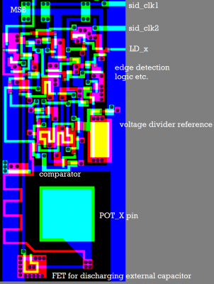

Now the circuitry close to the POT_X pin.
//POT_Y seems to have an identical layout, just mirrored.
Schematic:
Those two FETs working as a voltage comparator during sid_clk1 =1
and as a R\S flipflop with logic level outputs during sid_clk2 =1
gave me quite a headache.
So much for the paddles.

It appears that there is an error in my schematic:
