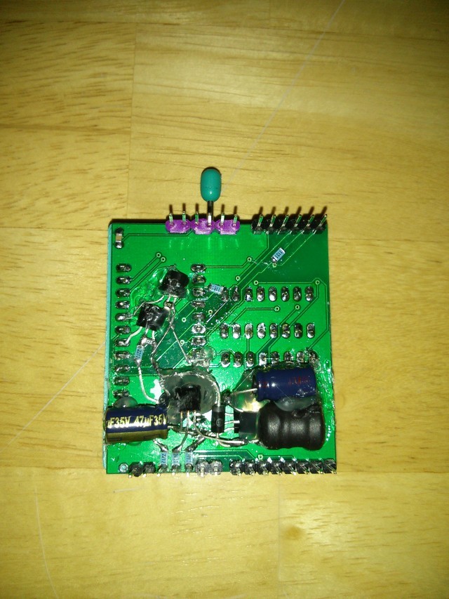

I've built the boost circuit and it works fine, I tweaked a few things to optimize it. It's nice that the voltage can be changed depending on the chip used. The Arduino sketch is unchanged, the voltage was very close to the calculation.
Another thing to consider is going with the 74HC164 instead, as the latch is not needed. This will free up an I/O pin and take less board space.

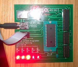

In case anyone's interested, I too have made a 28C256 EEPROM programmer. I made it for my 6809 based project. My programmer uses counters instead of shifters, and a standard ATMEGA8. My main motivation for making my own programmer was that nearly all the comercial ones work only on Windows. Plus of course it was done for fun.
Parts list:
* ATMEGA8
* 74HC590 8 bit counter
* Push button
* 3.5mm jack plug for serial
* USB socket for power
* LEDs and resistors
You can read about on my blog:
http://aslak3.blogspot.co.uk/2013/03/ee ... rcuit.html
http://aslak3.blogspot.co.uk/2013/03/ee ... -code.html
http://aslak3.blogspot.co.uk/2013/03/th ... ng-on.html
http://aslak3.blogspot.co.uk/2013/04/ee ... d-and.html
If anyone wants a PCB I made up 10 and have about 8 spare.

Yeah, great work guys. When I run out of the first batch of boards, I'll redesign the board with the booster circuit, and the ZIF holes will definitely be bigger. It should be possible to build the board without the booster components, if they aren't needed/wanted.

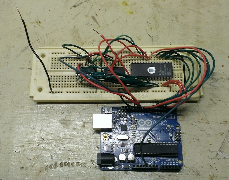

I built something very similar to this recently. A few differences:
1. It programs 2764s. That's what I chose to use because I had a bag of them lying around
2. Only uses 2 I/O lines for the shift registers instead of 3. You can tie SRCLK and RCLK together, you just have to clock it an extra time at the end to move the SR bits to the output latches.
3. All of the software is in the Arduino. It accepts Intel Hex record format. There is no GUI or CLI on the host - any terminal program that can upload a file and delay between lines will work. I use TeraTerm.
I built it on a solderless breadboard and it goes together in about 30 minutes. It is fragile and error-prone, but I only needed to burn a couple of ROMs with it to get my 6502 SBC online.
The Unaclocker and others described here look very nice and are clearly more mature, solid products. I wish I had seen them before doing my own - I probably wouldn't have bothered
But, just in case anyone needs to burn a 2764 or wants to integrate some of these features into their own design, I have attached a copy of my code. Feel free to do whatever you'd like with it.

I thought you needed 12v to program the 27 series eproms.. What are you doing for the +12v?
Re: 28Cxxx EEPROM Programmer
I am using the Arduino itself as the 5 volt supply. The 21 volts ONLY goes to the Vpp pin and only when it's in write mode. I found out the hard way that if you leave Vpp at 21V during an Arduino reboot it will corrupt the ROM
IIRC, your design uses a charge pump and a transistor switch to generate and control Vpp. That is a more elegant and foolproof way to do it.

I sold out, all 10 of the boards I had made. I created a new board with rpress's revisions and just sent that off to the fab. I'll have to order some more eeproms to confirm the new design works. And rpress, I'll send you one of the new boards when they get here.
