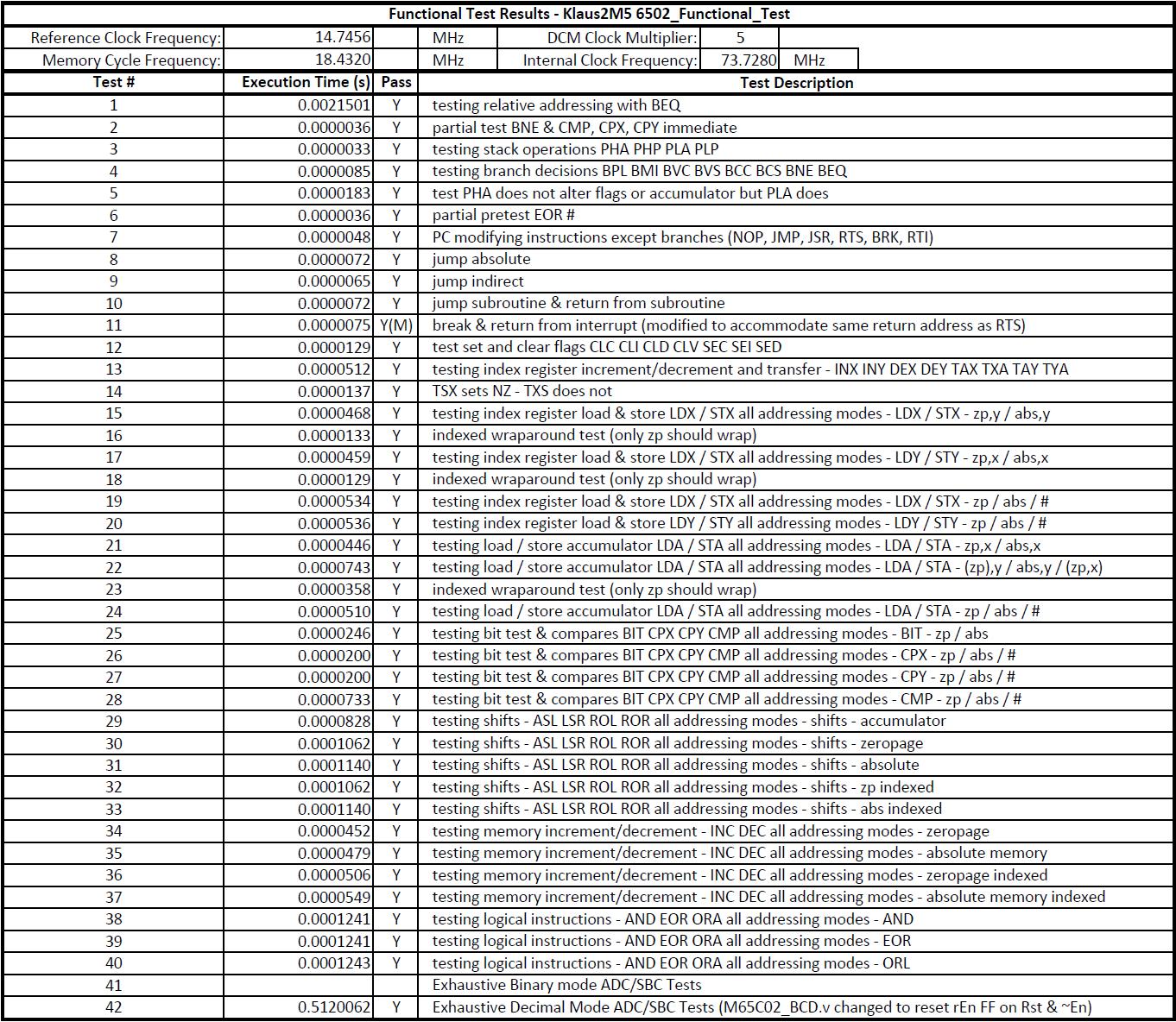

Succeeded in loading the 6502 functional test suite into my simulation environment. It has completed tests through number $29 (41), before it ran out of memory. I've gone back through the thread looking for the total number of tests conducted, and I can find no mention of the number of tests. I expect there to be $2A (42). Can you confirm the total number of tests conducted with this component of the functional test suite? Also, is it possible to jump into test $29? I'd like to avoid using ModelSim for the simulation.
Just to be above board regarding the M65C02 processor core, M65C02_Core.v, and the example soft-processor, M65C02.v, that I'm testing with Klaus' functional tests:
(1) it is not cycle accurate. It can be made that way, but that is for someone else to do. To do so would not require any Verilog source code changes.
(2) it treats subroutine calls and traps in the same manner. This means that JSR, BRK, NMI, and IRQ all require the return address to be incremented
by one on a RTS/RTI in order to point to the instruction. To change this behavior will require Verilog source code changes.
(3) it implements all undefined instructions as single cycle NOPs. It can implement the variable cycle length NOPs, but that is for someone else to do.
Again, it is possible to implement variable cycle NOPs without modifying any Verilog source code.
(4) some instructions are currently uninterruptable. That behavior can also be changed without changing the Verilog source code.
As a consequence of #2 above, I've modified the test suite's test of the BRK return address. I added a minus 1 to the constant in the test suite. Other than that, the M65C02 core and soft-processor have passed all tests as written by Klaus. I wrote an exhaustive test bench simulation for the binary and decimal adder, so I expect that there will be no issues with test numbers $29 and $2A.

When I look at the trace from your first post it looks as if the PLA gets 0x34 from stack at 01fc, but the compare immediate (0xc9) at 3e67 has 0x30 as the operand to compare to. Something is reversed as you seem to get the correct processor state of the stack, but the compare expects the I flag to be off????? This wouldn't match the listing, that you posted with it!

Am back on the trail. Unable to spend any time during the week. I have compiled the following table of results for my core using your 6502_Functional_Test.a65 program. For each of the tests that the core has completed, I've noted the execution time. Do you see any times that you would characterize as abnormal/unexpected?
Edited: Figure with the results of the decimal mode ADC/SBC tests.

I reached that point again in the BCD routine. Tracked the issue down to an error I introduced when I converted all of the ALU multiplexers to gated outputs and an OR gate combiner. I have corrected the error, and the functional test has passed that point. In fact, the simulation has iterated 10,000+ times. If I read your prior post correctly, it appears that a total of 20,000 calls and returns to chkdad() are required to complete this test.
I may skip the binary mode tests for this effort. If the same logic applies to both tests, I would expect that the binary mode check to be called 131,072 times. The decimal mode tests execute on the order of 25.4us/iteration, or ~512ms for the test. The binary mode tests would require about 6x as much time to complete.
I have doubts of being able to use ISim for a simulation of that length. I will likely give it a try, but I am expecting the same "out of memory" error.
I would certainly like to thank you for your 6502 functional tests. The special condition that your test helped identify would have led to some odd errors in decimal mode code. I will have to consider incorporating some of your test techniques into my functional test program that I've been using for regression testing. It certainly did not pick up on the problem your test identified. I will also have to go back a take a look at the ALU and BCD adder test benches. I did not run them again, but relied on my test program for regression testing after I changed the implementation of the bus multiplexers in the M65C02 core.
As I was writing this post, ISim completed the decimal mode test: 0.5120052 s. May let it run the binary mode tests, but it will take several hours to run and I expect it to run out of memory in the process.
