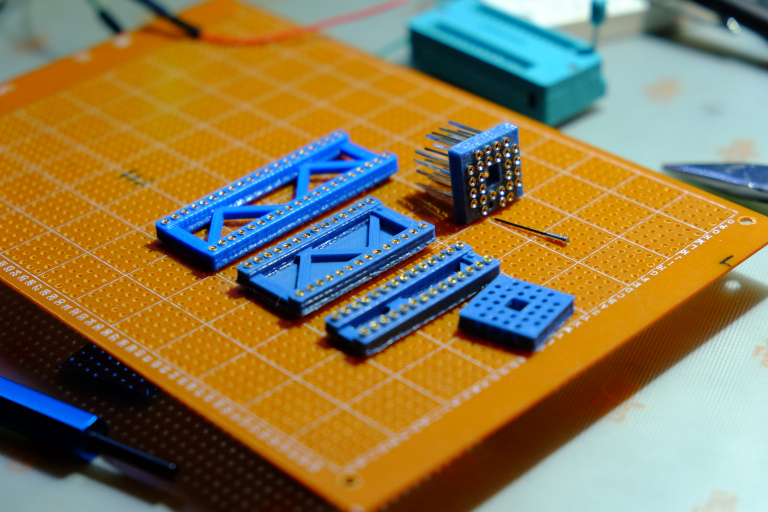

DIY WW sockets
Posted: Mon Apr 26, 2021 7:30 pm
by enso
Good news!
It is feasible to 3d-print your own wire-wrap sockets.
As previously discussed, wire-wrap sockets have gotten expensive and hard to get, especially when it comes to PLCCs. But for those of us with inexpensive (mine was under $200) 3D-printers, there is another option: print your own socket. Here is a picture of my early experiments:
Shown: a few DIP sockets, a pinned ̶P̶L̶C̶C̶-̶2̶8̶ PGA-28 socket (all but last pin, shown next to it), and an unpinned P̶L̶C̶C̶-̶2̶8̶PGA-28 socket.
Re: Techniques for reliable high-speed digital circuits
Posted: Mon Apr 26, 2021 7:40 pm
by GARTHWILSON
I'd say that what you have there is a PGA (pin grid array) socket, and you'll plug a thru-hole PLCC socket into it.
