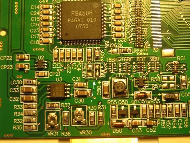

Needed a break from this project for a couple months... Experimenting with the previous registers did not yield the result hoped for, but... The desire to make this thing work was rekindled, after completing a 2 TB file server backing up all CD's and DVD's, I needed something else to work on and this project still sits on my table with my laptop, in front of my recliner.
I went to New Haven's website yesterday to see if they had any updated app notes or datasheets, and what do ya know? They started their very own forum. Seems to have just started too, around Oct. 18th. I posed some questions about my issues on there last night. You can read here: http://www.newhavendisplay.com/forum/vi ... p?f=6&t=15...
There is a jumper behind the display to select 6800/8080 interface. Curt, the site admin, gave me some leads that I'll try here in the next few days before I start on the next 3.3V chapter. Thanks for that Curt!
They have a sweet little display 640x480 5.7" for $109. Same cost as this discontinued 320x240 display...
ElEctric_EyE
- Posts: 3260
- Joined: 02 Mar 2009
- Location: OH, USA
HOORAY, HOORAY!!!!!! It works without delays! I am out of my mind!!!
Finally. My God, now logic once again rules, and the "bad magic" is gone. I can progress with the software, without the insanity of programming random delays.
So the question of whether the 3.3V logic on the display is compatible with 5V has been answered. No need for me to redesign my whole project , whew.

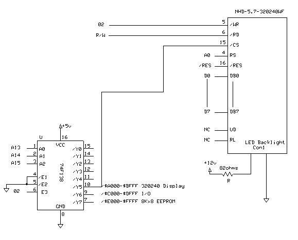

Updated display interface:
The 8080/6800 select jumper on the backside of the display, now selected for 6800 style interface:
