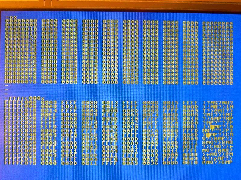

PostPosted: Tue Jan 24, 2012 2:08 pm
I've tried it out. I get the dash, and it echoes what I press on the keyboard to the screen, but nothing when I type in an address and an 'x' for the Hex Dump command or an address and a 'g' for Go command...
Both my INPUT and OUTPUT routines save the Y register.
My INPUT routine goes in a loop until a key is pressed and returns and ascii value in the Accumulator.
My OUTPUT routine sends an ascii value below $7F to the screen. It does look for $0D (carriage return) but not $0A (line feed).
I am using addresses $10 and $12 for the respective ADRESS and NUMBER variables used by C'MON.
I have a feeling some indirect STA is outside of my available memory...
Still looking at the code.
So it echoes the X, but you don't get a screen dump? Hmm... I don't see any potential issues with anything you've stated.
I did find a bug (and have uploaded the corrected source code), but it only applies to characters >= $7F
A couple of thoughts: Does it give you a new prompt when you press Enter? What have you initialized the stack pointer to?
I'd recommend placing a JSR OUTHEX at various points to see how far the code gets. E.g. place one after BNE M7 then run it and type @ and see if it outputs anything. The SBC #$77 is where it tests for the G command. The CMP #$FFF1 is where it tests for the X command; you could try placing a JSR OUTHEX before the CMP #$FFF1 and see if the code gets that far and if so what (value of the accumulator) it outputs.

PostPosted: Wed Jan 25, 2012 4:02 am
I'd look at this one first! Whereas py65 does init the stack, 65Org16 does not(*), so we need
  LDX #$something
  TXS
before the first JSR, and the $something needs to be correct according to the platform's memory map.

PostPosted: Wed Jan 25, 2012 4:26 pm
It's working!
Problem was on my end: My OUTPUT routine was not saving the Accumulator before it was called.
C'MON will be great for testing SDRAM when the time comes. I'm putting a board together for Arlet and am about 1/2 way done completion. Also, I think I'll abandon my efforts to porting HESMON. C'MON does the primary functions of memory dump, and store values in consecutive memory locations very well.
Awesome to see a window of data into 4GB!!!
