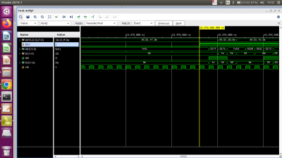

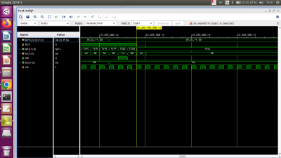

Here are the simulation waveforms.
As can be seen when RDY becomes zero, it is as if the a9 (which is an LDA) is discarded. When RDY becomes one again in the other waveform, the system assumes 20 is the opcode (which is an actual fact the operand of the LDA), being a JSR. One can also see resemblance of this with the writes that happens to the stack.
File comment: When RDY becomes one again
File comment: Moment RDY becomes zero

Yes, the A9 is discarded, because the RDY is deasserted. This is as designed. A normal use of RDY is to add wait states to interface slow memory. This means that the CPU core should wait to grab DI until RDY is asserted again, giving the memory system some extra time to produce the correct data.
In this case, you should also feed the RDY signal into the memory system, so it will either hold the FE50 value of the address bus, or the A9 value of the data bus while RDY=0.
