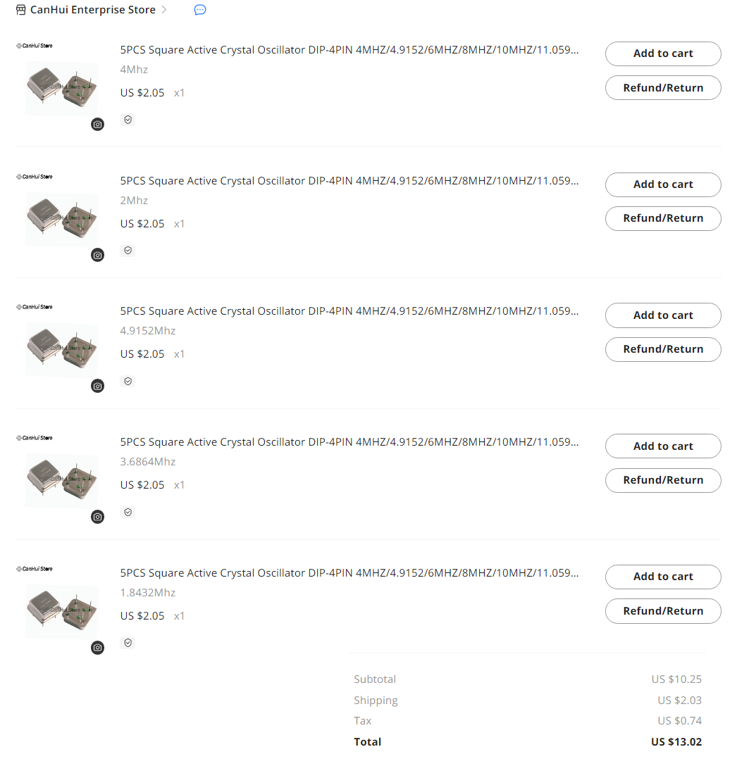

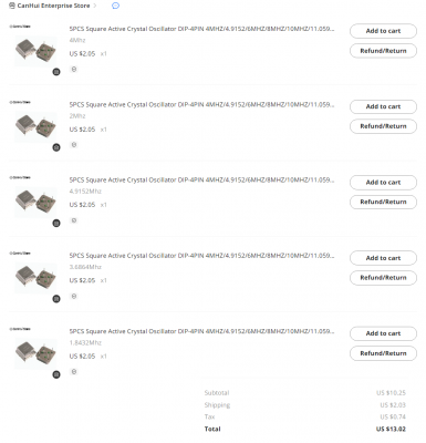

so after looking around, for my first build on the test bench here, the "proof of concept" is going to use HC series ICs.
I am also planning to run at 1-2 MHz, certainly 5 MHz or less based on what I can order easily. I rather like just getting a nice 1-2 Mhz "Can" for the breadboard stage.

About 'can oscillators'... I've purchased a few common values from this AliExpress vendor in the recent past with good results.
